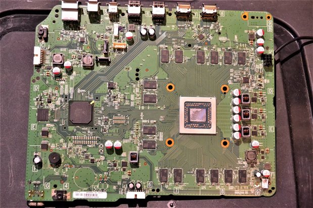

It makes the start and then stop sound. Southbridge gets voltage. All 12V test points get voltage. Power rails to CPU suspiciously low resistance. Details in iFixit link.
I have an XBOX ONE S that I bought as “for parts” on eBay and the owner says it was kept in a clean house, etc. It is indeed clean inside. No signs of water damage.
The PSU is also fine. The APU had a TON of thermal grease all over the surface mount capacitors. I didn’t remove that yet but I did re-apply some arctic silver and I used a more reasonable amount.
The symptoms I see:
Console when plugged in does a few quick pulses to the APU fan. Is it trying to init?
Console when eject is pressed makes the eject sound, then the shutdown sound immediately after.
Console when power is pressed makes startup beep and then shutdown beep immediately after.
I don’t know what kind of issue I’m getting yet. Is there a JTAG interface or some way to do further diagnosis on this thing?

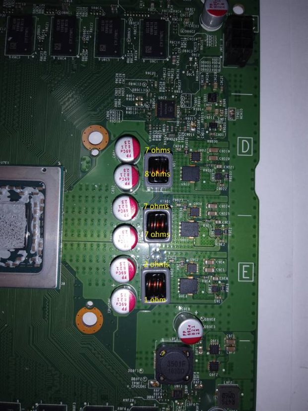

Aha! In the image you can see the CPU filter capacitor is registering just 1 ohm! The others are pretty low too but I bet if I remove that one it’ll at least boot. I have a server motherboard with a broken socket that I can steal capacitors from. Might replace the whole row if necessary.
later still
Looks like I was wrong. That capacitor I removed still offers up almost exactly the uf value on the tin. So that was another dead end. Hmm... One weird thing, all of the test points register 60Hz but not 110V. So thankfully the PSU isn't pushing wall socket voltage through. But that frequency is weird. My multimeter needs a charge though so I'll measure that again after it has.
The entire power area for the APU offers almost no resistance to the ground plane which is worrying. Again, need to charge that multimeter and re-check.
later again
Power on with no heatsink, the processor doesn't even warm to the touch. CPU, GPU, and other test points around the board pulse to 1-2V and then turn off fast.
Can't help but think it's related to the very low impedance between ground and positive on the V rails for the CPU/GPU. Is that normal?

Does any one have a diagram of the test points around the motherboard? What voltages / values should I be seeing? What are some likely culprits?

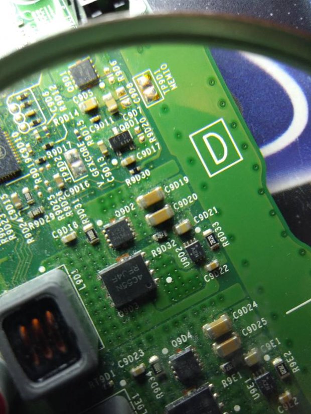

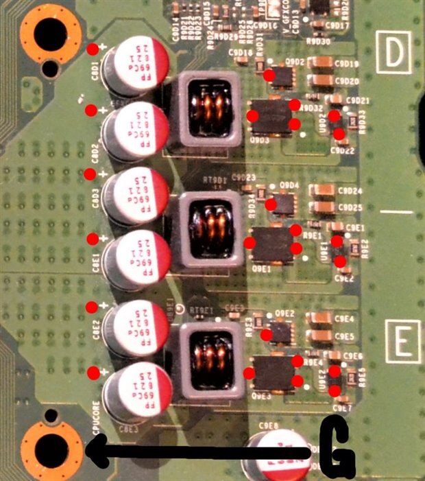

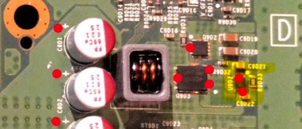

    Most of the time, VRM issues are blown MOSFETs which have become shorted - your low resistance measurement is suggestive that the MOSFET on that phase may have gone shorted. Short burst of voltage and…
  • lilithelotor
    0 lilithelotor over 7 years ago

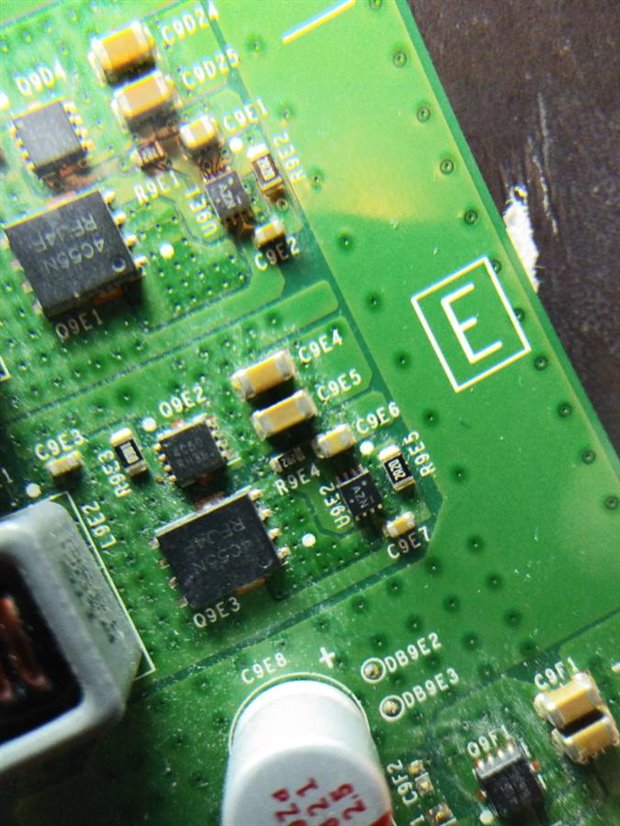

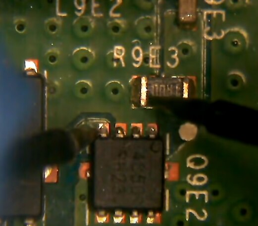

    Gough Lui  I tried removing the bigger MOSFETs and they seem fine, also removed the capacitors. Still a short to ground.
    I wonder if it's the reeeeeeeally tiny IC in that power rail?

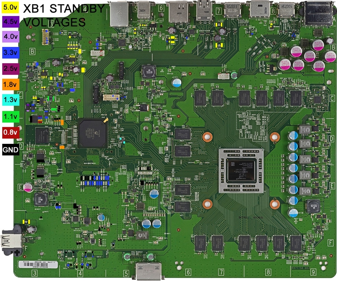

    The more I think about it, the more I think that TIIIIINY IC with a resistor on it is the first stage of the gate controlling the on/off state of that power rail.
    Look at that original XBOX One image (big image with standby voltages).
    That tiny IC is connected to a smaller trace that comes from that big black thing at the bottom of section 9E of the motherboard. I bet that's the control turning it on/off.
    I bet those MOSFETs were fine, but I'll still replace them. I may remove U9E2, U9E1, U9D2, and then test continuity to ground again on the voltage rails.
    I keep trying to remove parts to sort out where the short is. image

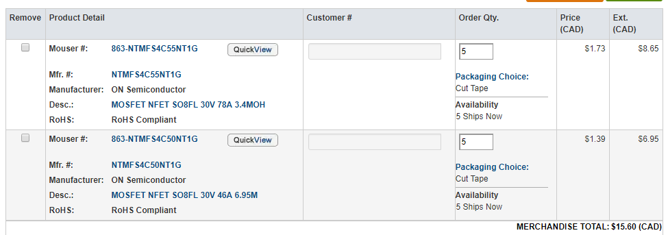

    Those are the parts I know of. To figure out what a surface mount capacitor is if it's unmarked, would it make sense to remove a few of them and average the capacitance value of them? Are they polarized if they are not marked? (I can make note of how they're connected to ensure I test the right polarity with them removed from the board.)
    I figure if I'm going to bother with the MOSFETs, I may as well buy a bunch of surface mount capacitors and resistors too to play with. I can then replace those too and make sure everything is within spec.
