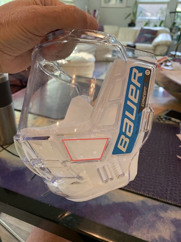

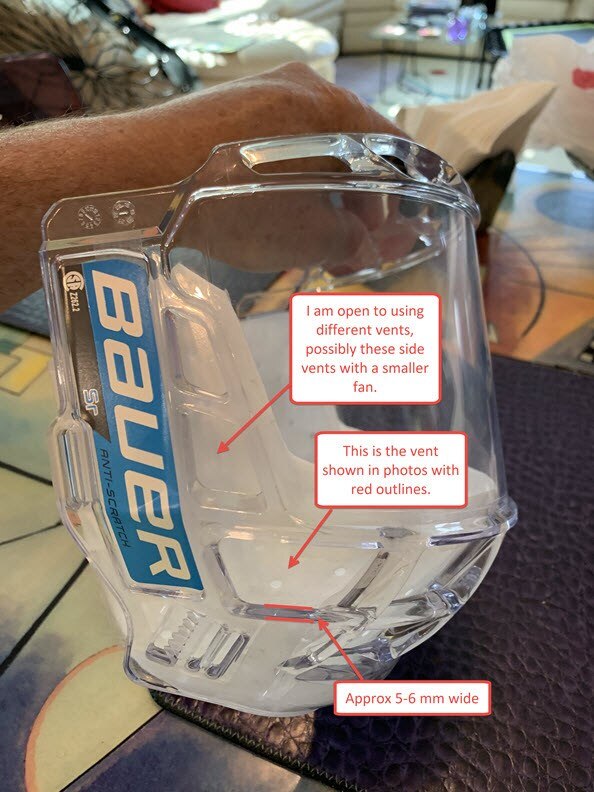

Would appreciate some help for an unorthodox application of small fans. Was looking at small Delta Fans and found my way here.
The problem:
Condensation on a full, clear face shield on an ice hockey helmet due to warm air inside the shield (from breathing) and cooler air in the rink.
Plan is to use 2 small (30 mm or smaller) fans to create air flow inside the helmet with full face shield.

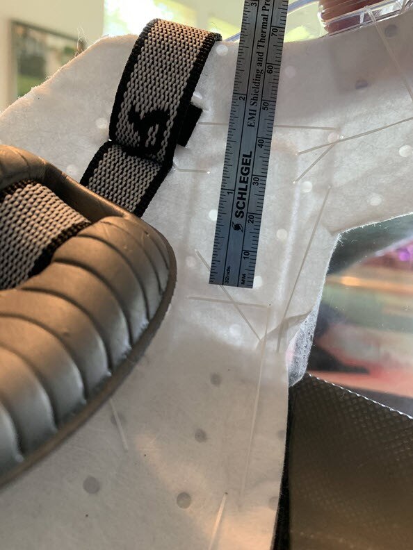

The shield has open vents for ventilation, some of which I covered on the inside with breathable N95 filter material (I can send photos).
Questions:
1. If the fans are placed against the breathable N95 material, will this strain the fan being directly against the N95 material?
2. Would it be better if the N95 material is repositioned on the outside of the shield, which would put the fan on the inside approx 5 mm - 6 mm away from the material?
3. What battery(ies) can power the fans?
As background, I am a 67 year old who plays regularly in a few ice hockey leagues.
One is over age 40, another over age 50 and another is all ages.
All hockey stopped in March due to Covid and restarted in June with various restrictions.
With 5 grandchildren, 3 who are under 1 years old, I did not play until this week and had to take extra precautions to mitigate the risk.
I played last weekend with the lower vents on the shield covered with breathable N95 material.
The shield is anti fog, and it didn't fog but it did build up water droplets of condensation on the inside due to my hot breathing and the colder rink air.
Same as fog, I could not see well.
My goal is to use the small fans to prevent condensation.
Greatly appreciate feedback as I am ready to buy some fans and fix this issue.
Thanks for all help.

    I just got back from a walk and here is an idea. If you are going to cover the fan with N95 material and plan to pull air through the material you will need an a lot of power. I would guess the would drop by 90% or more compared to free air capacity. This is because the area of the mask material is so small. How about mounting the fan in an unobstructed hole and have it pump air out of the mask. This will produce a slight negative pressure in the mask and air will enter the mask through all the surface area of mask material that you have lining the mask. This would be a much more efficient use of the fan as there would be a lot less blockage.

    John, I can appreciate your dilemma but am happy I am here in Houston (heat and humidity vs the cold I had back in Philly). I do better with the heat and humidity. The idea of a "snorkel" type device to channel my hot air outside the shield would work, however, even though adult ice hockey is no-check, we wear tooth guards and having something else in or near my mouth would not work. I've gotten a lot of great replies and plan to try a fan solution, though a "scoop" that channels more outside air in would help, that counters the N95 protection I added. I may look at a possible way to have my exhale channel down and out the bottom. What soft material can do that? Will post what I try and how it works. Thank you!I may
