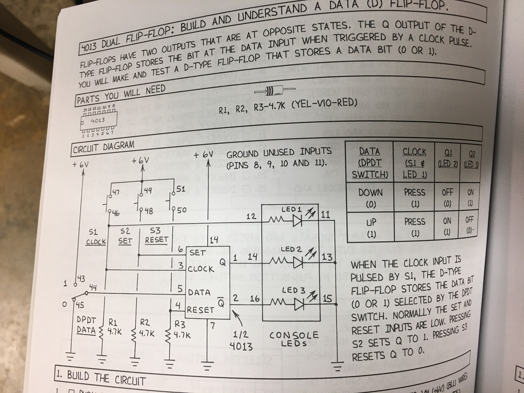

Hey folks, I am working my way through Forrest Mims' Digital Logic Projects Workbook 2 and stumbling on understanding basic D-type flip-flop operations.  I hope someone can help me understand where I am getting lost.
Mims presents this explanation of a 4013 D-type flip flop:
which, as I understand it, on the rising edge of a clock pulse Q1 gets set when D is set.  (By the way, why does he use Q1 and Q2 in the truth table and Q and ~Q (I don't know how to write a Q with a line over it) in the schematic??).  He presents a basic flip flop circuit to demonstrate this :
Ok I get when you set D in this circuit with the toggle switch manually, Q1 gets set high (1) with the rising clock pulse!

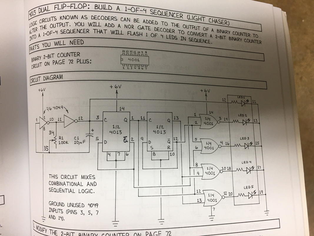

Now the circuit I am working on:
The circuit works as it should, lighting up LED's 1,2,3,4 in sequence.  Ok.  However, when I put a logic probe on pin 5 of the 4013 (D1) with the rising clock pulse starting from 0, D1 is 0 (low) but Q1 is 1 (high). I don't understand why Q1 is set when D1 is low.  Here is the truth table I came up with but it seems to me from the truth table in the image at the top of this post, on rising clock pulse when D1 is 0, ~Q should get set to 1 (high).  I feel like I am missing the sequence of how the outputs get changed but I don't know what...  Help!

    The short answer is, that the ~Q output (pin2) is connected to the D input (pin5). When the rising edge happens and after the propagation delay of the flipflop the outputs toggle according to the D input…

    The short answer is, that the ~Q output (pin2) is connected to the D input (pin5). When the rising edge happens and after the propagation delay of the flipflop the outputs toggle according to the D input. When D is high, Q goes high and ~Q goes low, which loops back to the D input.
    The logic probe would not show this relationship as the prop delay is only some nanoseconds.
    The long answer would require a timing diagram.
    If you have an oscilloscope, look at the clock, D and Q,~Q signals and trigger on the clock.

    With that being said, I should explain what I was trying do. Rather than look at the blinky lights go on 1,2,3,4  - say "neat" and move on to the next project I was trying to figure out how the 4001 quad NOR gate was getting the signals to turn the LED's on in that sequence.  So I was trying to reverse engineer the circuit back to the truth table level and the results didn't match with what Mims shows in this pic:
    since wolfgangfriedrich said my TT was correct, I am still lost, lol! So is Mims TT incomplete as well?  (Don't even get me started on understanding the 4013 changes in the second part 2/2 with clock and Q2 and ~Q2...)

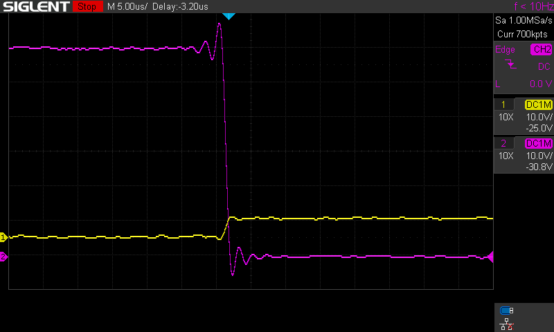

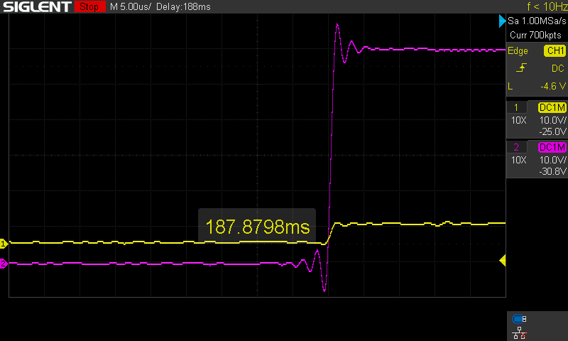

    I will add some scope screen captures I took after you suggested using scope instead of logic probe. I must not have captured or I don't know what I am looking for as it looks to me like the clock - Q - ~Q  - D all change at the same time; I would have thought one would precede the others.  I should make clear I am a complete novice with using an oscilloscope, and my cheapee Siglent 1202X-E may not be enough to measure what I need to see.
    Pic 1: Yellow is clock signal, Pink is Q
    Pic2:  Yellow is clock signal, pink is ~Q
    Pic 3: Yellow is D, pink is Q

    At 6V you are going to have to sample at 100ns or less to see a difference, probably 50ns minimum, 20ns to get a really good look. Also you should trigger on the high to low clock transition.
    In Pics 1  and 3 you are triggering on the data.
    • Reject Answer

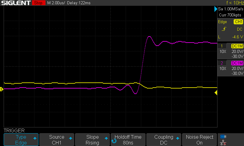

    Ok, clock yellow, triggered on falling edge. Pink is D / ~Q. 500ns is the limit on this scope.....
    0 dougw over 5 years ago in reply to opalko
    Can you show The rising edge of the clock and the D input at maximum time resolution?
    When the clock edge is detected at about 2 V the value of D gets latched to Q.
    If D changes after that, and it will because /Q will change, it will not change Q.
    You want to look at the voltage at D when the clock is first recognized as going high.
    • Reject Answer

    Ok I hope this is correct. Yellow clock, pink D.  I have a long way to go learning how to use my scope image

    If nothing else I am learning to use my scope better (I think). I was wrong about the limit, here is 10ns... I haven’t figured out why I don’t see D climbing when clock is at 2V; I know I still have scope settings wrong somewhere..
    Thank you for the answers and putting up with my ignorance on this stuff!
    That is a good scope shot. It shows that D is stable and low when the clock goes high.
    This latches low on Q and high on /Q.
    When /Q goes high, D goes high, because they are connected.
    Because there is no rising clock edge after D goes high, Q stays low.
    The delay between when the clock goes high and when D goes high is the propagation delay through the FF.
    If you capture what happens when D is high and a rising clock happens, D should stay high until after the clock goes high and then go low after about the same propagation delay..
