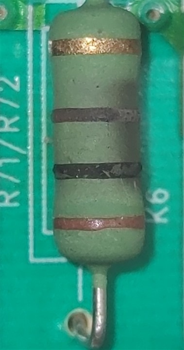

Hopefully this isn't a dumb question but this resistor is cracked and slightly burnt.  I measured it, it's open circuit.   It's from my bosch washing machine which is about 12 years old.  I think it's brown, black, silver, gold which is 0.1 Ohm (can't be grey, that's 1 giga ohm), but I've found several other photos showing this resistor on this pcb is brown black brown, 100 ohm, and people saying it's 100 ohm as well, and no one saying it's 0.1 ohm.  It's 'Ako 731799-06 BSH 9000449412'  if you would like search yourself.  Could it really be 100 ohm, and the burn slowly chared ring 3 to look grey/silver over time?  If it's supposed to be 100 ohm, and I replace it with 0.1, I'm sure it'll blow up...
Next question, since this failure seems to be very common, would it make sense to replace it with a higher power resistor e.g. 5W or 10W?
Thanks.

    Unfortunately not enough detail from the photos, the connection snakes off from the top side of the board, but I can't see where due to angle. Anyway, it's a resistor directly off the Live connection…

    If you can share a high-res photo of the surrounding circuitry, on both sides of the board, then it is possible to make a better guess. It's very feasible that discoloration could have occurred. It also seems unlikely to be a 0.1 ohm resistor, but it's speculation unless more detail is provided.

    Oh yeah, that's a 100R 5% (this type I doubt is available in 0R1), looks 3W or maybe 2W (smaller) (but check the size - dims are a VERY useful clue!). When a Power Resistor has smoked up it's often a FET gone closed circuit so check. If all going fine then should be a good enough rating but if you can find a 5W and get it to fit, can't hurt! Bob

    An unlikely cause, the resistor maybe was sized too close to tolerance or had an inherent defect and caused it to smoke (I had a boss tell me once only really dumb engineers undersize resistors), but ..........significantly more probable is there is a failure downstream of the resistor.
    The downstream failure could be rock solid, or be intermittent like a chaffed wire than touches ground.
    Upsizing a resistor sometimes works but probably doesnt fix the root cause.
    It also depends on what the machine is, resistors are sometime sacrificed in a design to burn out on a failure to save a significantly more expensive component, like a vacuum tube.

    Could it be a burnt black ring? Making it a 10 ohm resistor...

    That resistor still looks good. They get hot and discolour by default. Can you measure it.

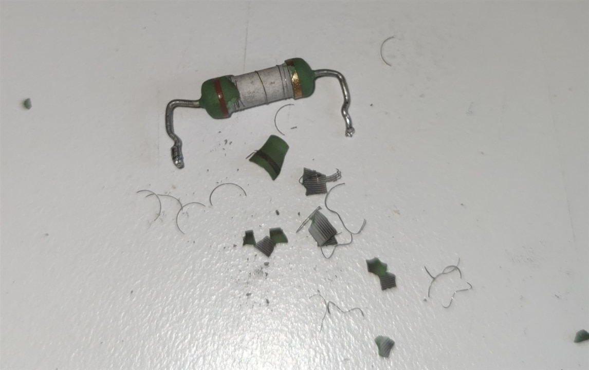

    ldarby over 3 years ago in reply to anniel747
    Thanks anniel747 , I just tried cutting it open but it basically shattered, but I've managed to measure 3-6 R on short lengths of the wire, so I'm sure it would be 100R total, not 0.1!
