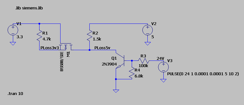

As a follow-up to my previous question, I have written a little program for the PIC16F628A that I had been lying around for quite a while. It works well, but I have to make sure the "PowerLoss" signal is seen by both the PIC and the OrangePi.
As the PIC works at 5V and the Orange Pi at 3.3V without being 5V tolerant, I have to shift the levels between both sides. After looking around, I found the AN97055 application note from Philips that mentions a single NMOS level shifter and even recommends using a BSS88 that I also had around.
However, after having wired it in a way that I believe is right, I noticed that when PowerLoss "pulls down" the 5V side, the 3.3V side is not event close to zero volts, but rather around 1.3 volts. This is not liked by the H3 inside the OrangePi as it freezes itself after a while and I have to reboot it.
I tried to simulate the circuit with LTSpice and while it does not have the BSS88 by default, I found a library for it in the Blackboard project at github and so was able to create the following simulation:

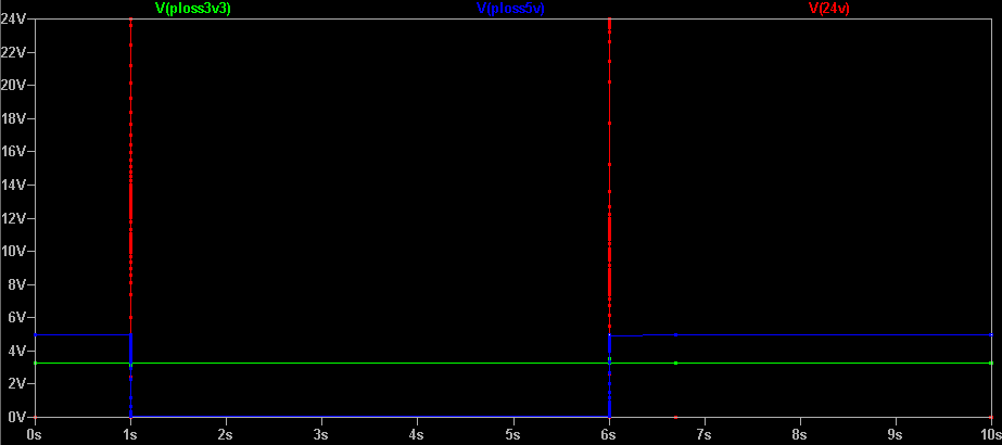

Tracing the voltages, it's not even giving the 1.3 volts that I measure on the "real thing" :
Now, maybe the library that I found is bogus, but maybe I also forgot something here.
One thing that I noticed is that the LTSpice symbol is not showing the "parasitic" diode on the N channel mosfet, while the application note clearly says that it's integral to the behavior of this arrangement.
Adding a single diode across the S and D makes the levels work properly, but then I figured that I could go with just a Schottky diode as I'm only ever interested in the 5V side pulling down the 3.3V side, not the other way around. A simple 1N5819 being enough, I'm all sorted, but I'm posting here in the hope of learning what I missed both in the simulation and the real life arrangement.

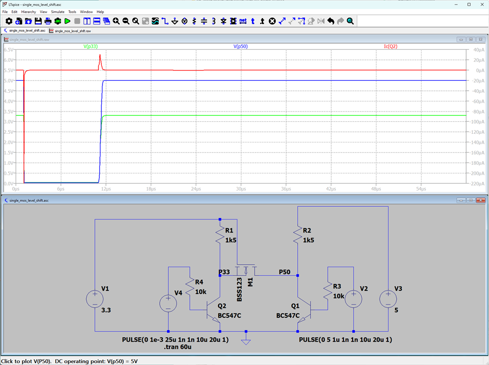

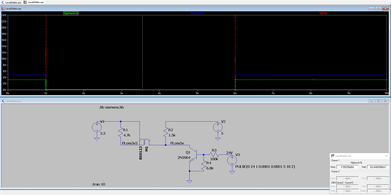

    I rather think that there may be an error in your model. I re-did from scratch and seen no problem. I used BSS123 which is in the LT Spice library. MK
  • michaelkellett
    michaelkellett over 1 year ago in reply to obones +3
    I tried it like this: MK

    If it had been me, I think I might have toyed with adding a second 2N3904 to drive the PLoss3v3, and not bothered with the BSS88. You'd probably find it would be ok with two transistors sharing R3 and R4 - basically, you'd be making your own composite transistor with two collectors - though you'd probably need to drop the resistance of R3 (or choose transistors with more gain).
    As to why the bidirectional level converter is not working in the physical circuit, it might be simply that you have the gate and drain swapped on the BSS88. Your 1.3V would then be the gate threshold for whatever I the 2N3904 collector maxes out at (it would obviously be a bit higher that the Vgs threshold). You'd be able to confirm by measuring the voltage on the PLoss5V when Q1 is off - the now forward-biased body diode would let current run from the 5V rail to the 3v3 rail and PLoss5V would ride up above the 3v3 rail.
    Just an observation, but your method of monitoring the 24V isn't very precise, or snappy for that matter. If you look at the voltage where the Ploss signals start to change, you'll see you're wasting maybe a quarter of the time that the PSU is giving you to get the shutdown done. When the Ploss signals do occur, they're also very slow in logic terms. Try simulating with the 24V signal being a slow ramp down, rather than just a pulse waveform that instantly disappears.
