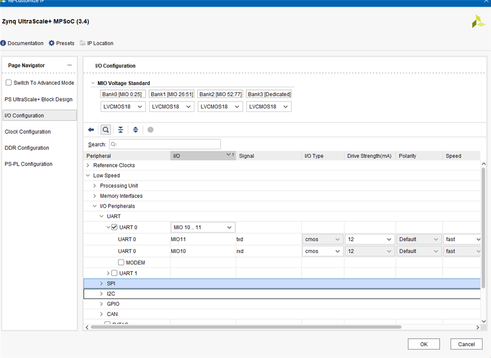

    Apologies, however, I lacked a crucial detail that I should have mentioned.  I want to use the UART that is connected to pins MIO10 and MIO11 (the JTAG/UART connections).  Those pins though, as the pin names imply, are PS pins.  While the example you gave is very helpful, it is like other examples I have found before.  I understand the surface process (create AXI4 Lite and it creates a toplevel and wrapper), however, I am unsure what logic I need to add to the wrapper as the toplevel simply the components of the design I created.  How many registers, how to declare slave logic, assign PS connections, find UART address, how to hook the AXI4 to the processing system.

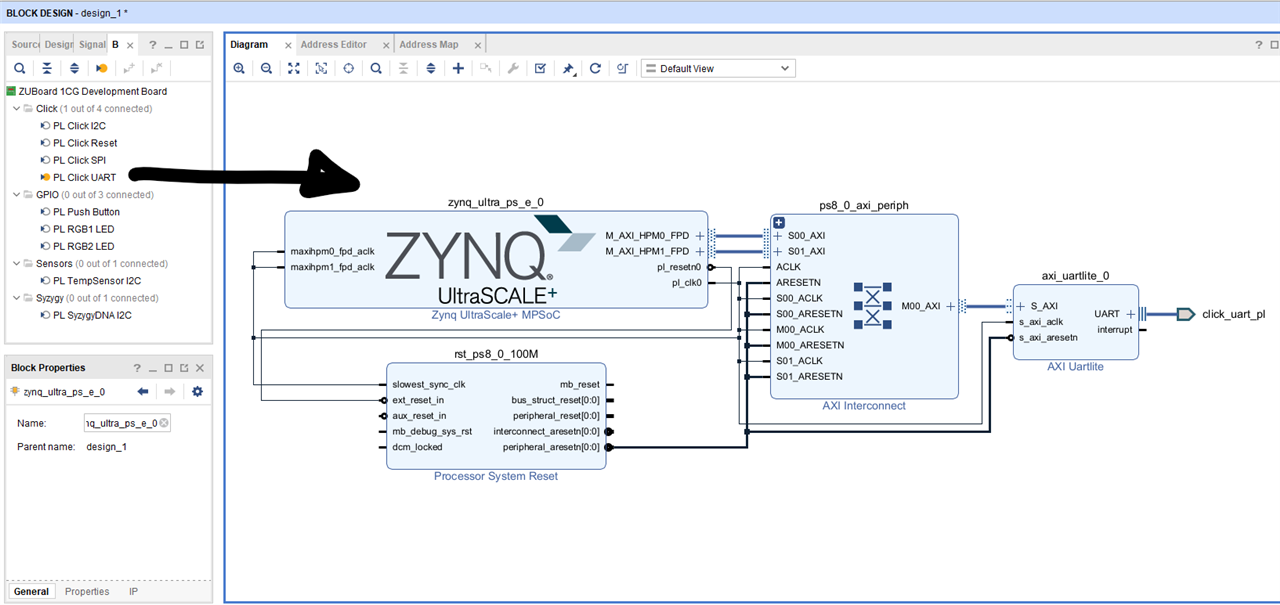

    I'm not sure I understand what you're trying to do. I'd recommend you first look at how Vivado's block designer works. In this example, I simply instantiated a Zynq PS and then dragged the UART configuration from the board provided by the manufacturer.
    After running block automation, the Zynq PS block will automatically expose the enabled UART as an AXI peripheral.

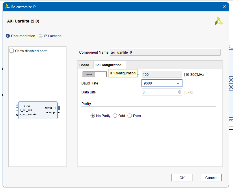

    Then you can check how the AXI UART Lite implements something similar
    AXI UART Lite v2.0 Product Guide (PG142) • Viewer • AMD Technical Information Portal
