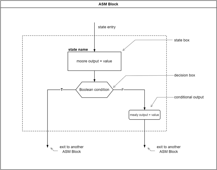

The provided ASM chart visually represents the finite state machine (FSM) that controls the HX711 driver.
An ASM chart is a graphical representation of a digital system's behavior. It's used in digital design to visualize the sequential logic of a system.
Key Components of an ASM Chart:
  • State Box: Represents a specific state of the system.
  • Decision Box: Determines the next state based on a condition.
  • Conditional Output Box: Generates outputs based on specific conditions.
ASM Block Legend
