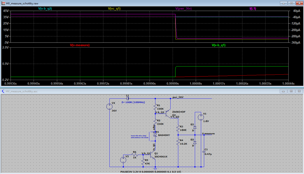

imageWhy is the Schottky diode being used in control circuit? and why is the 470nF cap is added at that voltage divider output? how is the Cap value 470nF calculated?

  • geralds
    0 geralds 5 months ago in reply to michaelkellett
    Hi

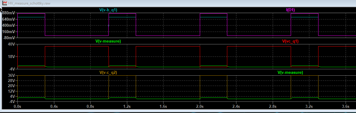

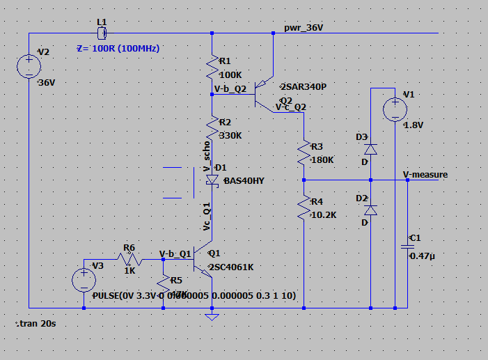

    simulation with Schottky diode:
    schematic with schottky
    diagram with schottky

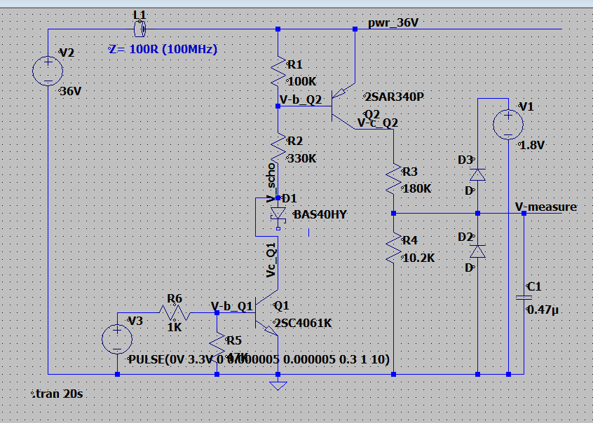

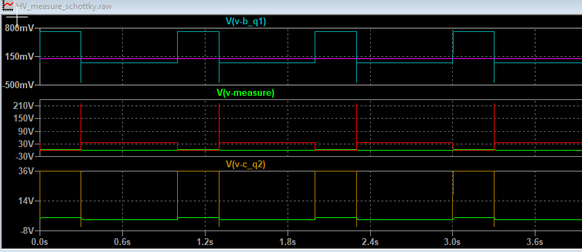

    simulation without Schottky diode:
    schematic without schottky
    diagram without schottky
    The Schottky diode is important during switching off the transistors.
    Without Schottky it can produce very high voltage spikes during switching off.
    Yes, the two diodes on the measure line are clamping diodes. sorry, it's my English is not very well. I translate it all from German to English. I forgot the word clamping.... "..to you know Mr. Alzheimer? - no, I forgot him."Wink In the 70's I learned about them, telecommunication - telephones.

    Without Schottky it can produce very high voltage spikes during switching off. - you are refereing T103(npn)?.
    as we can see in the 2nd waveform (VC-Q1 - red)  there is high voltage spike...in-turn leading Vc-q2 (orange) -ve spike....image
    But any how this -ve spike will be suppressed by clamping diode right? so can we remove schottky?...
    And can you please share the Simulation settings. If you can share the .asc file that would be greatSweat smile.
  • geralds
    0 geralds 5 months ago in reply to Humaninsane
    Hi,
    diagram with schottky current ferritbead
    diagram without schottky current ferritbead
    With Schottky - the current through the ferrite bead is minimal few micro ampere.
    Without Schottky - the current is much more - it produce a current spike, that produce a spike voltage on the Q1 transistor during switching off.
    This diode blocks the back current, which will stored in the induction during switching off, it separates Q1 from Q2.
    refer what michaelkellet told - flyback diode
    -->>> see also switched power supplies, such circuits looking similar.
    copy this .docx file to your folder and rename the extension docx to .asc.
    Best Regards
    Gerald

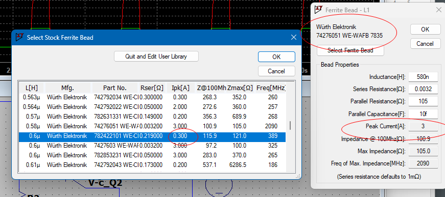

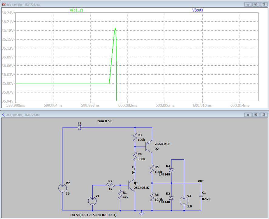

    Hello Gerald,
    I have replicated your model quite closely in LTSpice and it shows no sign of the huge spikes.
    I used a Wurth ferrite bead:
    MK
  • geralds

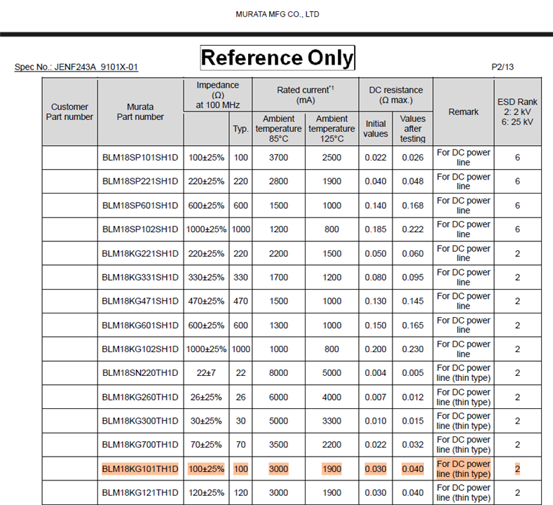

    original ferrite bead in the original circuit, Murata BLM18KG101TH1D:
    murata ferrite bead
    I've selected the Würth ferrite bead 74276051:
    simulated ferrite bead - 74276051
    Well, may be your simulation have other setting in the software.
    I just installed the software and worked with default settings, in the simulation settings.
    Just drag and drop, I selected components that have "real" parameters, I did not use ideal components.
    In the fused wire draws < 3A at 36V, not mA. This is the power rail.
