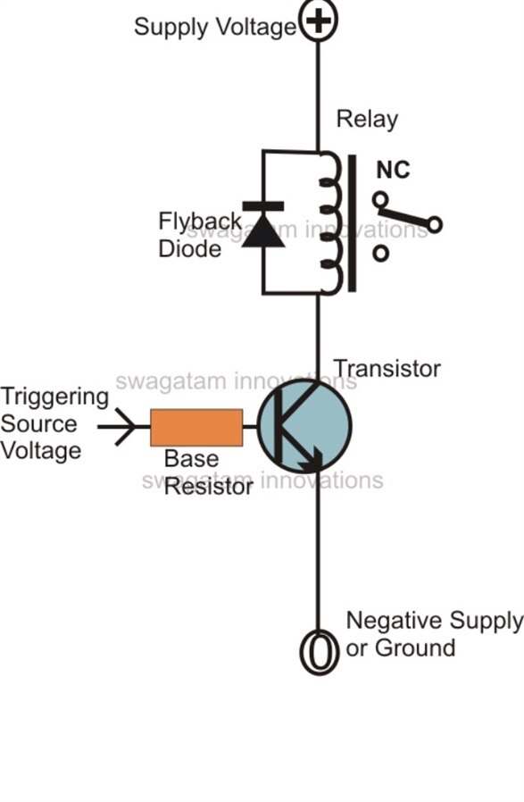

I want to use raspberry pi GPIO pins to control a few relays. I was planning to use a 3904 NPN transistor with a 330 ohm resistor on the base of the 3904 and a fly back diode across the coil of the relay (just as shown in the attached image). My questions are: would it be more efficient power consumption wise to drive the relay with an MOSFET or power resister? And will I destroy an NPN 3904 transistor over time if I use it in the circuit shown below? I see people using BC transistors (like a BC 141) instead of an NPN transistor like I described. image
    dougw over 8 years ago +3
    Your circuit should work fine depending on the coil impedance. I prefer a MOSFET because they are more efficient - no wasted base current, less load on the digital output, and more voltage across the relay…

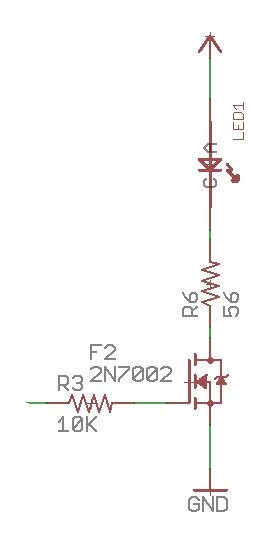

    Although not a relay, here is a schematic snippet of a MOSFET being used as an LED driver:
    Applying a positive signal (3.3V to 5.V) at R3 turns the MOSFET on,  with a low level signal (<1V) the MOSFET is off.
    High quality MOSFETs are fairly cheap and very reliable.
