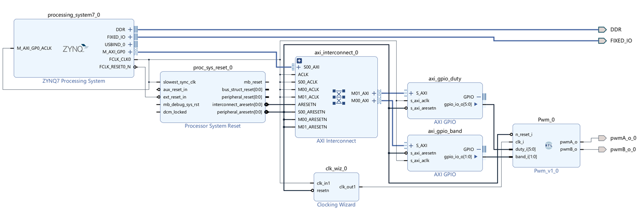

    To check if things worked, I created a constant for the duty cycle (set to 50%), and a register for the deadband. Now that I got this working, and refreshed my Pynq brain, I made both duty cycle and band a register. You recognise them as the two AXI_GPIO blocks
    In the Jupyter testbed that I created, I can control both values:

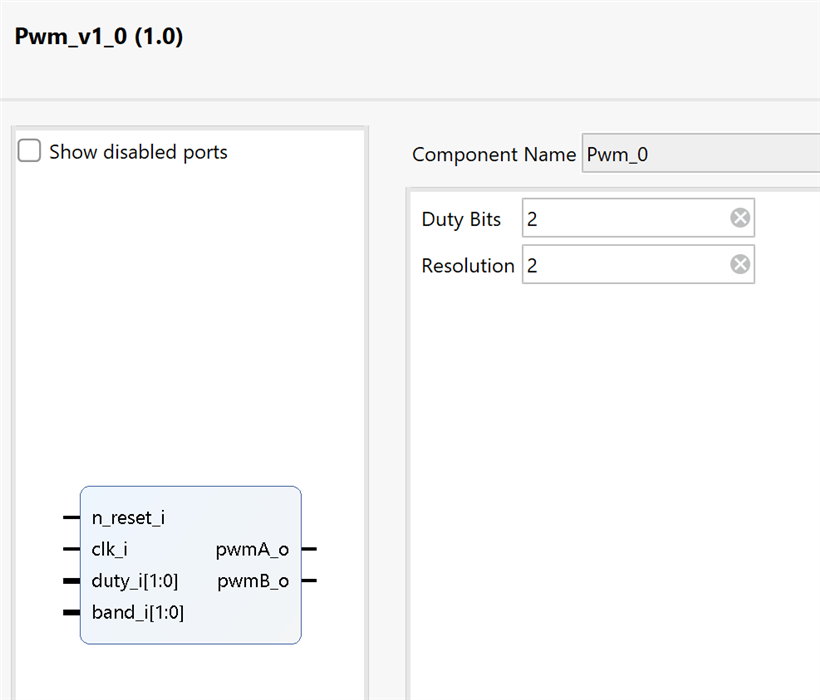

    I have set the resolution back to 6 bits for my tests. Because I turned the resolution into a generic in the VHDL code, I can adapt it in the block diagram.
    Jan Cumps over 2 years ago
    With the VHDL PWM from my previous blogs, I can get a 5 MHz differential from a 20MHz clock, if I reduce the resolution to 2 bits.
    There's virtually no wiggle room for deadband then. There are 1 clock pulse left to deal with it.
    To support that, I made the resolution bit width generic:

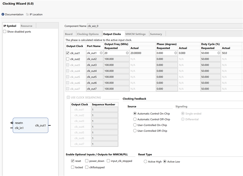

    I used a clock wizard to generate the 5 MHz:
    I set the resolution to 2 bits in the block diagram:

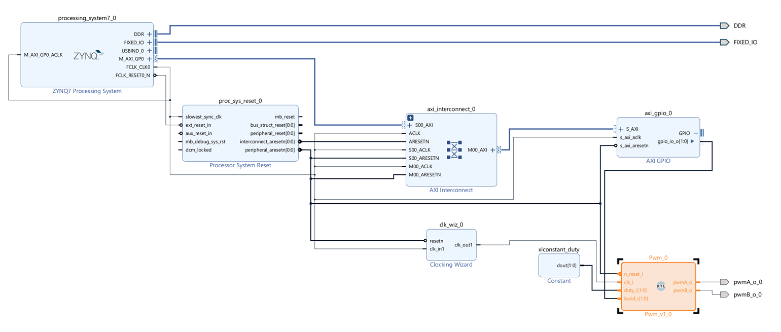

    Block design:
    Output:
