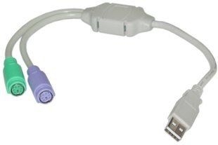

    dougw over 5 years ago +3
    There are many adapters out there that cost just a few $. If you need to roll your own, you could check what chips they use......

    e14 Contributor over 5 years ago in reply to dougw
    Douglus,
    We have looked into these but we need an adapter that can work at extended temperatures e.g. -40 deg C to +85 Deg C - which we were not able to find.....

    dougw over 5 years ago in reply to e14 Contributor
    Thermal performance of electronics is a big subject and there also is a lot of misinformation to be wary of.
    It may be feasible to "up-rate" a part if you test it adequately for your application. Many companies do this successfully.
    Intel and AMD might not make military versions of their chips and yet their chips often end up in military systems (after rigorous testing)
    It may also be feasible to "up-rate" a part by adding a conformal coating, but such measures take more in depth knowledge and testing to ensure adequate performance.
    https://www.electronics-cooling.com/2004/02/the-temperature-ratings-of-electronic-parts/
  • gdstew
    gdstew over 5 years ago in reply to dougw
    Or you could just buy parts with the standard industrial temperature range that Shmuel is looking for. A lot of parts come that way, no extra charge.
    The ones that cost more usually don't cost a lot more and are already tested so you don't need to spend money for upgrade testing or coating them.
    The only thing that needs to be done is to make sure the design really needs the extended temperature range.
