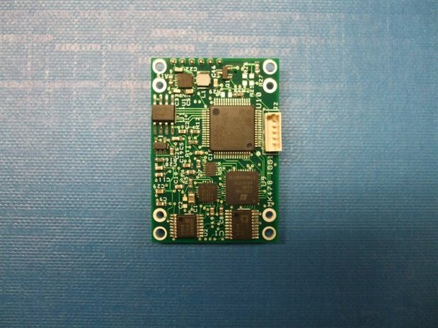

    I've attached a picture of a 16 bit data acquisition system with a 168MHz ARM Cortex, 3500 lut ICE5 FPGA, 16 bit ADC and a load of other signal conditioning stuff. It all fits on a board 28mm x 40mm.
    As Clem has observed, the FPGA will be hard work if you've never done it before -  but I'll add that it will be a lot harder using an application style processor board like the Pi. If you want to stick with processors then look at the Xmos parts - which are designed for this kind of thing and have suitable clocks and a tweaked C tool to programme them.

    0 msimon over 9 years ago in reply to michaelkellett
    The board looks amazing, good stuff image
