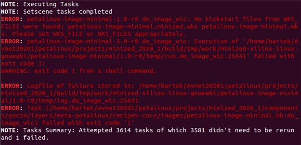

As these project should be your starting point to develop things on your own, I have tried to add openCV library, but building petalinux failed.
It is some problem with wic image.
  • "petalinux-build"
I could just remove wic image from packaging option, but I would like to use it like in "how_to_boot.txt"
It is some problem with building command?

    Thank you for the feedback!  We do work very hard to try to enable our customers and constructive criticism is heard by us.  We take it seriously as ... well frankly, I am not you.  I can only guess as to what is the best way that I would want "this" to work.
    We have not made official tags yet, so the 2020.1 repo is still in fluctuation.  We have seen the "WIC issue" and have a workaround at this time.  We are working towards a proper solution.
    For now, you can work around that using:
    petalinux-build -c avnet-image-minimal
