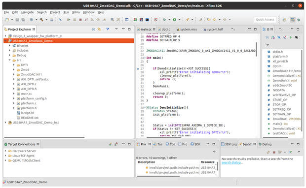

    Firstly, once I'd setup the workspace to point at my extracted ZMOD DAC folder I was able to import the three project components - HW, BSP and SW. I re-built the BSP and that worked this time (as opposed to when I was using Vivado 2018.3 and it failed to generate the BSP). Initial build failed due to DPTI and I always end up stumbling my way through includes, the double quotes failed even with the path added...angle brackets to search the include path I manually added did work!
    #include <stdio.h>
    #include "platform.h"
    #include "xil_printf.h"
    #include <dpti.h>
    #include "ZmodDAC1411/zmoddac1411.h"
    That built and I downloaded the ELF and bit stream as you did....all good.

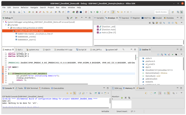

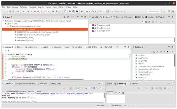

    I added a breakpoint and started the debug session, SDK changed to the debug perspective and stopped at the DemoInitialise call, I was then able to step into that function.

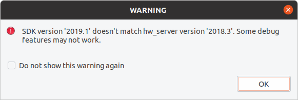

    The only thing along the way that I ignored was this message:
    Whilst the above may not help directly it shows the code and project can be built. Unfortunately I don't have the ZMOD DAC so I cannot actually see if it works.
