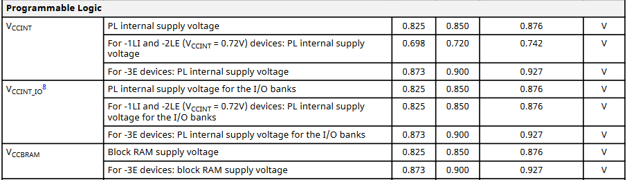

I want to change the voltage of the power supply of my PL (Vcc_int)  in order to carry out tests on the XCZU3EG FPGA.

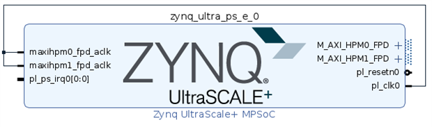

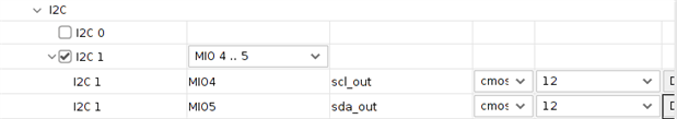

  1. Vivado :
    1. image
    2. image

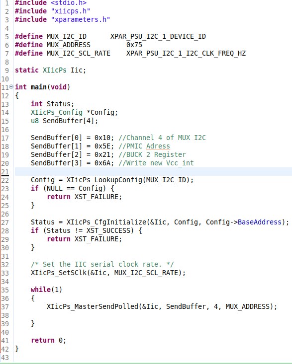

  2. Vitis :
    1. C code :  image
My question is : Is it possible to modify the BUCK 2 register by sending the information to the chain with the XIicPs_MasterSendPolled function ? The I2C MUX is the master and PMIC the Slave.

    Hey Justin,
    we have never tried to manipulate the PMICs individually through the PMBus in the way you are describing. That's not to say it couldn't work, but you are heading into uncharted waters. I'd be leery of making any changes in this way because it hasn't been validated and a mistake could brick your board. Another thing to consider is that we have the INT, INT_IO and BRAM all tied to the same output. Changing that voltage will change all 3 and that may not be what you want. Making changes in that way will void your warranty as we also recommend not making changes to the PMIC configurations. The functionality is there mainly for monitoring purposes and to fix known issues if they come up.
    Sorry I don't have a better answer for you, but I'd be very nervous about trying to change that supply that way.

    Hey Justin, good to know. I had to at least provide the proper warning image If you really want to tweak this voltage and monitor the power you may want to buy an Infineon dongle and install the PMBus header on the board. Then you could make adjustments and monitor voltage, current and temperature real time. If you decide to go that route check out my blogs on using the tool for guidance.
