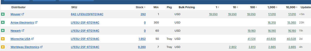

    One Lattice family I am interested in is the ECP5 series.  It's what I'd characterize as medium density.  At any rate I could have sworn that they were only available in BGA package.  I checked again yesterday and the 24,000 and 44,000 LE devices are available in 144 pin TQFP packages... needless to say, I was very happy to see this.

    0 michaelkellett 8 months ago in reply to dang74
    I too would have sworn on my favourite pet's life that the ECP5 was only available in BGA but it seems to also exist in TQFP144:
    I looked it up on Octopart and Mouser have stock at a reasonable price. The prices from Microchip USA and Worldway  are hard to understand.
    Mouser warn of long delivery times on the website but the 292 in stock seems to be true.
    MK
