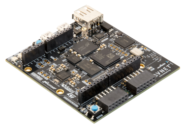

We will be roadtesting the AVNET MiniZed FPGA SoC development board in September. I find this to be an exicting prospect and can't wait to let it loose on the element14 community.
In brief, the MiniZedTm is a single-core Zynq 7Z007S development board. This board targets entry-level Zynq developers with a low-cost prototyping platform.image
The Minized's compact design features on-board connectivity through USB, Wi-Fi and Bluetooth. Peripherals can be plugged into dual Pmod-compatible connectors, the Arduino-compatible shield interface or the USB 2.0 host interface. JTAG circuitry is incorporated onto the MiniZed base board, so with a single micro-USB cable to your laptop you are already up and running. User LED’s, a button and a switch allow for a physical board interface.
Micron memory solutions are presented for QSPI flash, DDR3L memory and on-board eMMC instead of an external SD card. The Murata Type 1DX wireless solution incorporates 802.11b/g /n Wi-Fi as well as Bluetooth 4.1, which provides both Bluetooth Classic and Low Energy (BLE). The integrated power supply from Dialog generates all on-board voltages, while an auxiliary supply input can be used to power designs that require additional current. From ST Micro there is an on-board motion and temperature sensor, as well as a digital microphone.
MiniZed provides for an efficient hardware reference design, while it is also an inexpensive board that can be used to run workshops and tutorials. The board aims to showcase the power of Zynq, where the Cortex A9 processor core integrates seamlessly with the programmable fabric to provide signal processing and control solutions. The on-board digital microphone serves as an input for a variety of illustrations of how to implement FIR filters, FFT’s and direct memory access.
Feel free to download the attached pdf to learn more about the Minized.

    michaelkellett over 9 years ago in reply to johnbeetem +5
    I'd like to echo John's comment that this board is not really suitable for initial learning about FPGAs - the Zynq chips are very, very difficult to get to grips with. There is all the difficulty of the…

    At US$89, the MiniZed is an attractive price for a Xilinx Zynq with ARM Cortex-A9 and 512MB DDR.  That said, in my opinion a Xilinx Zynq is not a good introductory FPGA.  It's a complex architecture and you have to deal with the added complexity of a "motherboard on chip", which usually runs Linux. Learning about FPGAs with a simple board like the DEO-NANO or a less-expensive entry-level FPGA board is probably enough learning curve steepness.  But of course, chacun a son goût (YMMV).
    Regarding what other boards are available, take a look at some of the other Zed boards at the MiniZed link.

    I'd like to echo John's comment that this board is not really suitable for initial learning about FPGAs - the Zynq chips are very, very difficult to get to grips with. There is all the difficulty of the series 7 FPGA and an ARM applications processor with a sophisticated interface to the FPGA as well.
    Don't misunderstand - the Zynq is a great chip - but it is complicated. The basic documentation for the memory interface on the series 7 FPGA (that's the little tiny bit in the corner of the chip that talks to DDR3 RAM) runs to 678 pages.
    The Zedboard doesn't, in my opinion, have a useful IO configuration  - it doesn't have Ethernet so the ARM, which typically runs Linux, has no useful IO port. The Arduino interface and 2 PMODs is about enough to connect a serious ADC and some debugging pins (I know this because I've used a similar boards (Arty and Nexys Video)).
    So it's a bit of tiger in a very small box.
    If you want to do more than just run some demo stuff where you point and click though many pages of detailed instructions then you will need to to do some serious work and it will take a long time.
    If you have decided to use this chip for a project and need to get the hang of it and the tools, the board is a cheap way to get started - otherwise I can't see much point in it. If you want to learn about the Xilinx 7 series FPGA then an ARTY is a better route (Artix FPGA rather than Zynq so no ARM on board).
