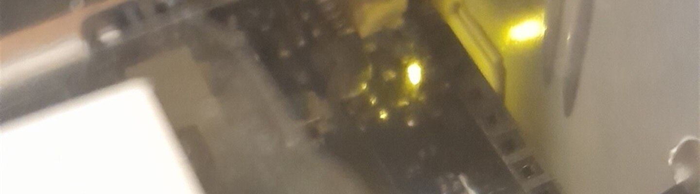

But will not yet arrive on the Arduino. That's because we'll only get downlink data when we start a communication (design choice in my sketch). Once we receive an uplink from the Arduino, the downlink is sent back:
And the LED will light up Slight smile

    ... and at the next uplink, the Arduino received it too, and switched its LED on.
