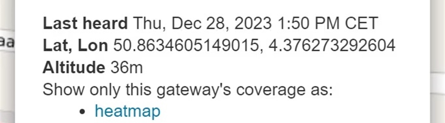

You will get a log of what's happening:
The TTN console confirms it found you:
And after some time, you will appear on the maps: https://ttnmapper.org/heatmap/
