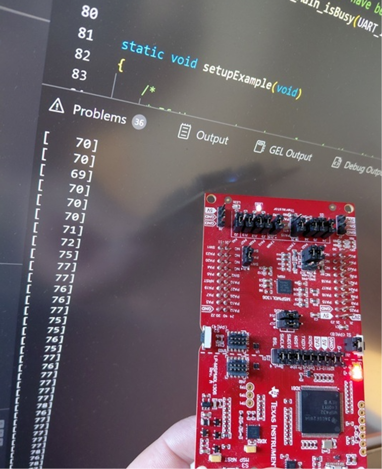

I'm going to use TI MSPM0 Launchpad. The kit has a light sensitive diode. And the controller (MSPM0L1306) has a good analogue front end.
Current status: do everything :). I don't have the code yet. But I did check out the schematics for the light sensor.
What I'll probably use:
  • that light sensitive diode
  • one of the OpAmps available on the L1306
  • ADC
  • Timer
  • UART
I'll have to use the OpAmp as Transimpedance Amplifier. It 'll also have to bias the LED circuit. Luckily, there are examples.

it worked. Berfore the eclipse stated, I put my launchpad in a location that 's not directly in the sun:
I made a design based on TI's Out Of Box example and that application note for transimpedance amplifiers. It did an excellent job - although the photodiode has a daylight blocking filter. There is a measurable component of IR in sunlight, so we are able to measure that.

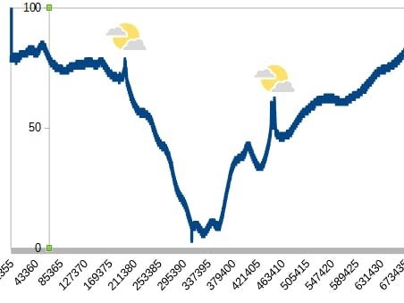

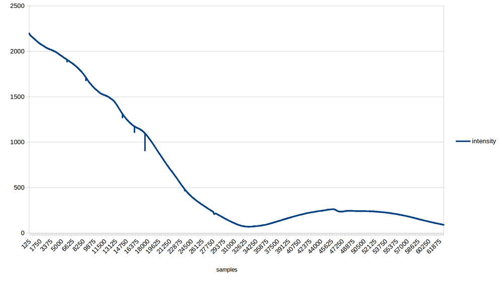

Here is a graph showing the measurements.
start: 19:05 end 21:15
The eclipse happened when the sun was about to set. That's why, after the eclipse, you see both the effect of the end of the eclipse, and of the sun dropping behind the horizon.
