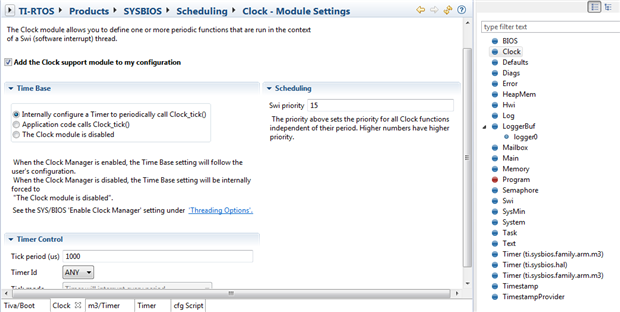

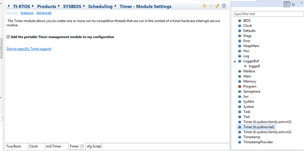

    shabaz over 12 years ago in reply to ipv1
    Hi Inderpreet,
    It's a good question. I've yet to study it in any detail, but is the OS running in pre-emptive mode? It may be co-operative mode.
    The demo code I've used has been using (wlan_station) has been configured to use TI-RTOS, not FreeRTOS. TI-RTOS is running in a pre-emptive mode as far as I know, and on the face of it one major benefit of TI_RTOS would be that it is highly configurable from within CCS; this is about the nicest config system I've seen:
    The following screenshot seems to show that the OS can dynamically switch to a co-operative mode for specific tasks. I'm a beginner to TI-RTOS however, so I'm just guessing from this screenshot:
    I'm not familiar with FreeRTOS either, but if FreeRTOS is a very typical embedded system RTOS, then it likely may be using just a single timer (most of these portable RTOS's are designed for the lowest common denominator hardware), and any optional timer management module supplied with the OS may not be required for CC3200 projects. The CC3200's main Cortex-M4 core does not perform WLAN operations (that is controlled by the separate in-built ARM core), so I'm guessing timer requirements are minimal for any OS that is used with the CC3200.
    The timer peripheral usage will be highly useful to know, for both TI-RTOS and FreeRTOS, I'll let you know if I find any useful resources.

    ipv1 over 12 years ago in reply to shabaz
    Hello sir,
    Thanks for the input. I took a wild guess and implemented a timer interrupt code and it worked! I will have to look into FreeRTOS docs to find out what timer it uses but I was able to use CC04 sucessfully and for my demo that works.
    Here is the output.
    https://freeboard.io/board/qeRlqA
    Many thanks for the help sir.
    I owe you one.
    Sincerely,
    IP
