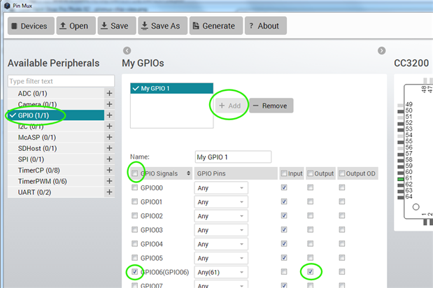

12. Using General Purpose I/O
There are four 10-way single-in-line (or two DIL 20-way depending on how you see it) header pin and socket type connectors on the LaunchPad. Most of the pins on the CC3200 are overloaded, meaning that a choice often needs to be made for what function is desired for each pin. The connectors are labelled P1-P4.
Useful references are the CC3200 LaunchPad circuit diagram (which will show which pins are connected to LEDs, switches etc) and the LaunchPad Hardware Guide (PDF).
As an example, if it is desired to control the physical fifth pin on connector P1 as an output (e.g. to connect up an external LED), it can be looked up in the Hardware guide. As shown below, that fifth pin is a GPIO-capable pin, and the actual real pin number on the CC3200 integrated circuit it is wired to is pin 61.
The real pin number can be mapped to a logical internal GPIO number using the PinMux tool installed earlier. Start it up and select the CC3200 as shown below.
Hover over pin 61 in the chip view, and it will display the details about that pin; it can be seen that pin61 is internally wireable to GPIO06.
Next, select GPIO on the left under ‘Available Peripherals’, click Add and then deselect all the GPIO signals and then select just GPIO06, and click in the ‘Output’ column. All this is shown in the screenshot below:
Once you are done this, click Generate and select a temporary folder. In that folder, four files will be created. You can cut and paste that code into your project. Here is the bit of code that is needed; it is a function called PinMuxConfig:
void PinMuxConfig(void)
    // Enable Peripheral Clocks
    MAP_PRCMPeripheralClkEnable(PRCM_GPIOA0, PRCM_RUN_MODE_CLK);
    // Configure PIN_61 for GPIO Output
    MAP_PinTypeGPIO(PIN_61, PIN_MODE_0, false);
    MAP_GPIODirModeSet(GPIOA0_BASE, 0x40, GPIO_DIR_MODE_OUT);
If you’re working with a project based on one of the demo examples, then there may already be a function somewhere that does this for other pins, and so the three lines of actual code in the function above can be inserted into that function. The example projects have this in a file called pinmux.c. If the project does not have this file, just copy the pinmux.c and pinmux.h files from another example project into your project folder inside your workspace folder, and then edit them.

Once you have worked through the pin configuration detail and added it to the pinmux.c file, then the main code (e.g. main.c) needs this:
// only needed the include line if the project doesn’t already have this included:
#include “pinmux.h”
#define LED_GPIO 6
#define LED_PIN_LOW GPIO_IF_Set(LED_GPIO, my_led_port, my_led_pin, 0)
#define LED_PIN_HIGH GPIO_IF_Set(LED_GPIO, my_led_port, my_led_pin, 1)
unsigned int my_led _port;
unsigned char my_led_pin;
GPIO_IF_GetPortNPin(LED_GPIO, &my_led_port, &my_led_pin);
LED_PIN_HIGH; // set pin high
LED_PIN_LOW; // set pin low
The example above can control an output pin. To read a pin, use the PinMux program to get the input configuration code, and then the status of the pin can be read using the GPIO_IF_Get function, e.g. GPIO_IF_Get(SWITCH_GPIO, my_switch_port, my_switch_pin). A non-zero value means that the pin is high.
