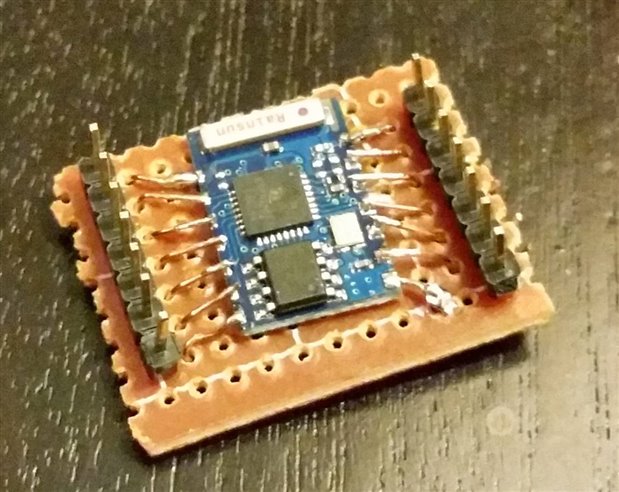

A little more than a month ago a friend told me about a cheap wifi module. So I searched for this piece of wifi magic and founded the ESP8266 Wifi module. And it is really cheap. Depending on where you get it and the version we can say is between $5 and $8 for one module. Told myself I can spare $8 for this Wifi promise land so I ordered two for a little more than $8.
Yesterday I got them, right away I got very exited!! On yes, new toy!
First I realized that I ordered the ESP8266 ESP-03 model. Seems to be one of the favorites (from the forums) because it has several exposed digital IOs. But .... (there is always a but) it has no pin headers, so I said, no problem I solder a few and get done with it. Pin space separation is not the same as my pin headers. I then move to plan B (or C, hard to keep track when you are exited to get this working). Anyhow, the idea was to place it on a perf board and solder small wires to the position of some pin headers so I can wire this up.
I did manage to hook up some wires then the moment came. I got the usb to serial, connected to the device, opened the terminal window and.... and..... nothing! Nothing at all.
As of now I do not know if I damaged the device or the soldering is not good enough or even if I am totally wiring it incorrectly. For that I air my frustration here while I manage to get a lease from sleeping time to continue working on this.
It may be nothing, but this board has the antenna upside down. Comparing it to the other, and to others in the web. It might be nothing.

    YAY!, got it working after countless hours of playing with this. Connect these lines CONNECT GPIO15 TO GROUND CONNECT CH_PD TO HIGH test this with serial terminal with 9600bud This should get the device…

    ESP-03 requires
    GPIO15 to be connected to GND
    CHPD to be connected to vcc (3.3v)
    VCC to be connected to +3.3v at least 150mA source
    GND at GND
    This is all you need to power the chip
    When comes to communication, RX pin on the chip, voltage sentive. You have to use a proper voltage shifter otherwise it wont work. There many ways to do it. I uses a resistor with with zener diod to cut over voltage, and simple resistor divider wont work at high bud rates.
    Watch this videohttp://youtu.be/t-yuYasIKtY
    FYI dont use a arduino for now to communicate. Use a usb serial converter till you get the hang of it
    Did you try flashing the firmware? When I ordered the ESP-01 it came without a firmware. So burn the official firmware and let me know the status.
