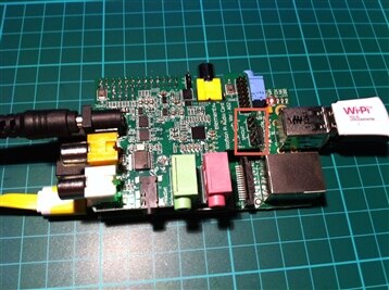

With the wifi working, it was time to connect the Wolfson Audio Card.

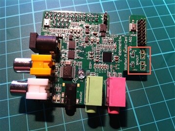

Wolfson Audio Card
Before connecting the audio card to the Pi, I soldered headers to the SPKOUT connections.
This is where I plan to connect loudspeakers and use them with the card's onboard amplifier.
I connected the audio card, ensuring the pins aligned properly and that the plastic screw was fastened.
When booting the Pi, a green LED lights up on the audio card.
Time for a test. I connected my headset with microphone and configured the card/pi to use the correct audio input/output:
./Playback_to_Headset.sh
./Record_from_Headset.sh
These commands generate a lot of output, but as long as it doesn't contain any error messages, you should be fine.
I made a small recording:
arecord -Dhw:0 -r 44100 -c 2 -f S32_LE file
And played it out to verify the contents:
aplay -Dhw:0 -r 44100 -c 2 -f S32_LE file
The contents of the file matched the expected results. Test successful.
More information on the command line recording, playout and the commands used, can be found here: Wolfson Audio Card - Command Line recording

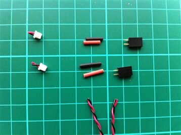

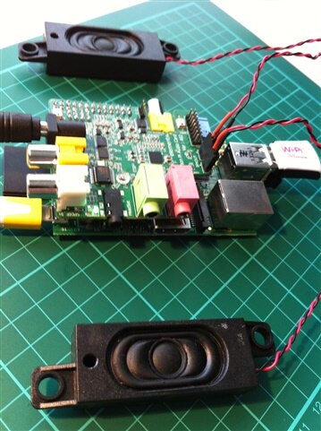

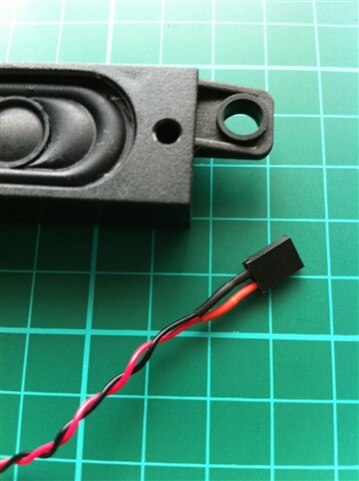

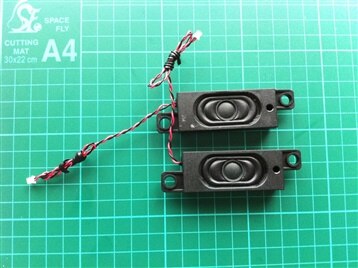

Speakers
As stated earlier, the goal is to connect speakers to the audio card. The advantage of using the SPKOUT on the Wolfson card, is that it uses an onboard amplifier.
It is however required to connect the audio card to an external 5V power supply in that case.
I got myself two small speakers and replaced the end connectors to be able to plug them on to the audio card.
With the speakers connected, I could now redirect the output to the speakers instead of the headset, but also use the onboard microphones for recording
./Playback_to_Speakers.sh
./Record_from_DMIC.sh

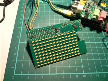

Pi-Lite Display
The Pi-Lite is a board for the Raspberry Pi, which was on Kickstarter a while back. It's inspired by the LoL shield for Arduino.
I had it lying around for a while and decided it was time to use it in one of my projects.

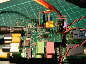

It can be connected to the Raspberry Pi's serial interface, which is also made available on the Wolfson audio card.
I also searched for a 5V and a GND pin on the Wolfson card, in order to power it.
To display text on the Pi-Lite, the serial interface needs to be used. In order to do that, I installed "minicom":
sudo apt-get install minicom
Running a test command to display the current time in HH:MM format:
date +"%H:%M" | sudo minicom -b 9600 -o -D /dev/ttyAMA0
