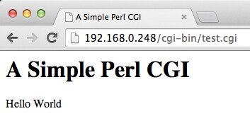

Create a test CGI script to verify the correct functioning of the webserver:
pi@raspberrypi ~ $ cd /var/www/
pi@raspberrypi /var/www $ mkdir cgi-bin
pi@raspberrypi /var/www $ cd cgi-bin/
pi@raspberrypi /var/www/cgi-bin $ sudo nano test.cgi
#!/usr/bin/perl
print "<html>";
print "<head>";
print "<title>A Simple Perl CGI</title>";
print "</head>";
print "<body>";
print "<h1>A Simple Perl CGI</h1>";
print "<p>Hello World</p>";
print "</body>";
print "</html>”;
pi@raspberrypi /var/www/cgi-bin $ sudo chmod +x test.cgi
Success! The test script works.

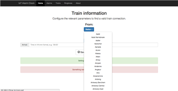

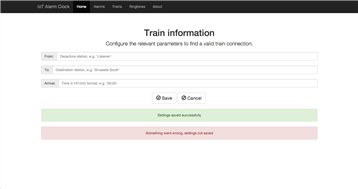

Web app development
I started development on the web application in charge of the configuration of the alarm clock.
To have something modern looking and compatible with mobile devices, I used Bootstrap and JQuery.
Using Perl and the iRail API, I am able to populate the web application with the required information.
Here's a test where a dropdown is populated with data retrieved via the API:

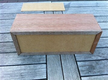

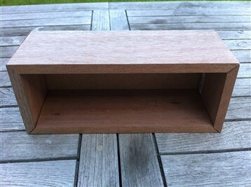

Enclosure progress

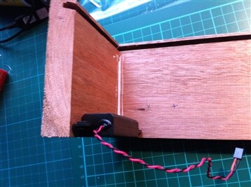

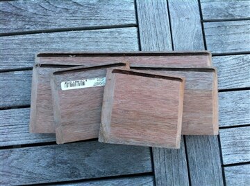

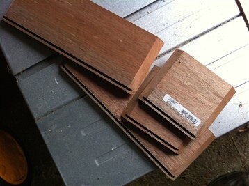

I made a lot of progress on the enclosure for my alarm clock.
In the last post, I had started cutting the parts of the enclosure. I cut grooves in the four sides in order to be able to add a back panel.
Everything fitted properly, and the result was very clean looking.

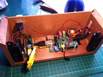

It was time to add the electronics to the enclosure. By using some PVC screws which were glued to the bottom panel, I was able to mount the Arduino and Raspberry Pi.
Adding the rest of the components, power connector and wifi USB dongle.

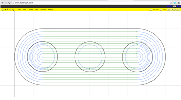

There was still some work to be done on the top panel. I had foreseen to use three buttons and wanted to integrate them in a clean way.
I recently purchased a CNC milling machine which makes use of a Dremel. This was an ideal case to test the CNC.
After milling the top panel, I sanded it a bit and inserted the buttons. I was very satisfied with the result!

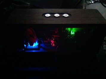

In the dark, the unfinished alarm clock lights up like a Christmas tree:
  • blue light from the Arduino
  • red light from the Raspberry Pi
  • green light from the Wolfson audio card
  • white light from the illuminated pushbuttons

    More info here: http://www.shapeoko.com/wiki/index.php/About
  • Robert Peter Oakes
    Robert Peter Oakes over 12 years ago in reply to fvan
    I can not find accuracy specs on the CNC, do you happen to know them ??
