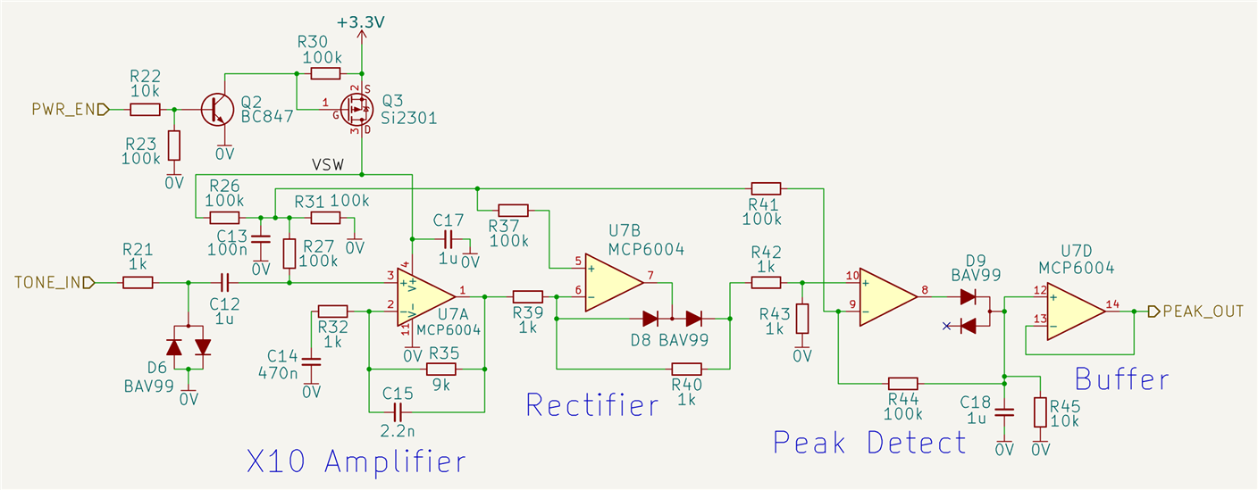

Beep Sensing
I have no access to the watering system, I have not seen it nor measured anything, so I was working somewhat blind when developing this solution.

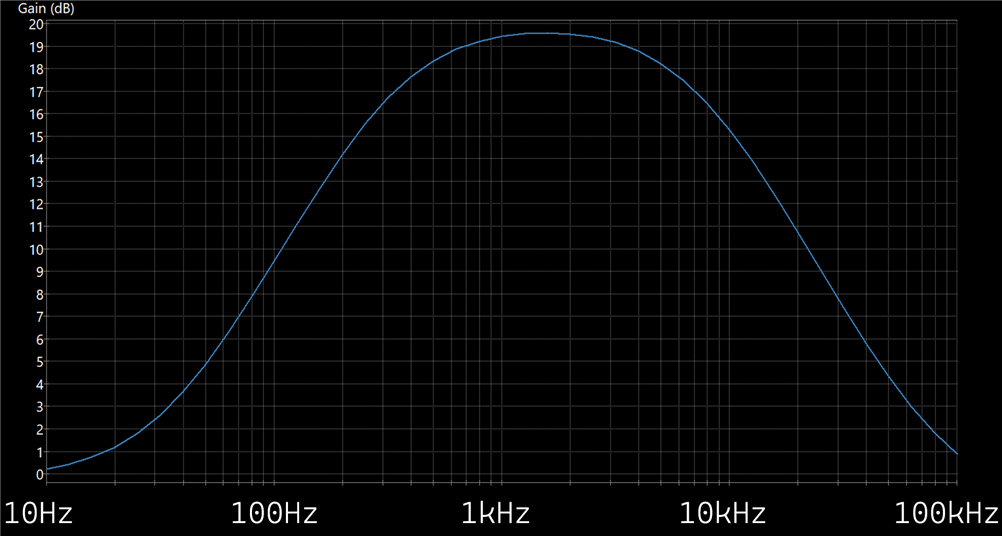

The circuit below shows what I used for the beep sensing, and since it is all done in the analog domain rather than in a microcontroller, it is easy to simulate if anyone is interested. The output is a voltage level that is representative of the amplitude of any incoming beep.
Here is the simulated frequency response of the first stage:
The ‘scope trace here shows the PEAK_OUT output, when the input (TONE_IN) is 0V.
If I apply a 100mV p-p 1 kHz signal (yellow) at the input, then the output (pink) rises to about 0.45V.
This is therefore quite a large output signal, easy to measure by the microcontroller ADC.
I need to support a large input range, because I have no idea what the system that this circuit will attach to will output.
If I apply a very large signal (5Vp-p, orange) at the input, I see a level of 1V output (yellow). Apologies for the inconsistent and wild colors, I’m still getting used to the reference traces in the new version of the PicoScope software.

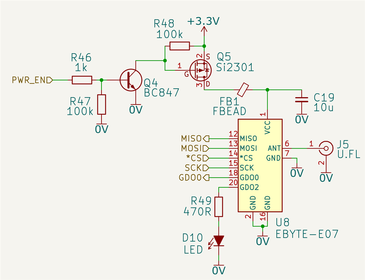

Transmitter Circuit
I decided to use the classic Texas Instruments CC1101 (PDF datasheet), which is available in module form. I had two good reasons: (1) The CC1101 has a very good level of configurability, useful if the project ever needs to interwork with different transmitters/receivers in future and (2) I was already using the CC1101 in another project so I reused my code.
The module that was used was Ebyte E07- 900MM10S (900 MHz) although technically the 433 MHz version might offer longer range. As it is, the 900 MHz version will easily cover the largest of gardens and residences, unless one owns a farm or castle. There’s a spare output pin on the CC1101, I connected that to a blue LED to indicate transmissions!
If I were to redo the project, I might give stronger consideration to using LoRa; there is an eByte LoRa module which is near-pin-compatible, but needs a few more signals. The modules are low-cost, one could even add both LoRa and CC1101 modules in a more future-proof design.

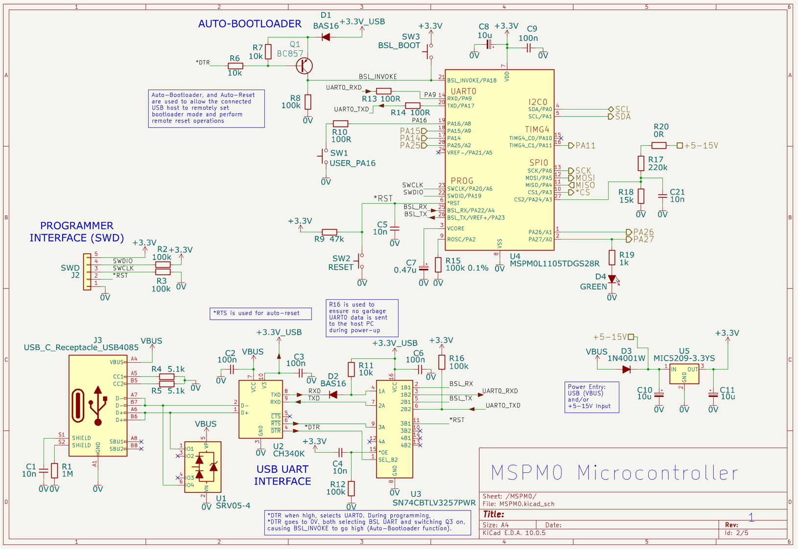

This part of the circuit was the most challenging from my perspective, because I wanted it to be easy-to-use and configure, while at the same time being reasonably low-power. These requirements cause conflicts, because configuring a low-power circuit might not be possible when circuitry is asleep!
What I came up with is shown in the circuit below (click it to enlarge). It is mostly modelled on the EasyL1105 circuit.
The power to the entire board comes from the USB connector, or from a 5-15V external source, and a diode (D3) protects the USB interface from receiving current from the 5-15V source.
The MSPM0L1106 microcontroller has two UART interfaces, one of which, known as BSL, can be used to update the firmware. I used the other UART, known as UART0, to implement a configuration menu. A multiplexer/demultiplexer IC, U3, is used as an electronic switch to choose which of the two interfaces (BSL or UART0) should connect to the USB UART chip (U2).

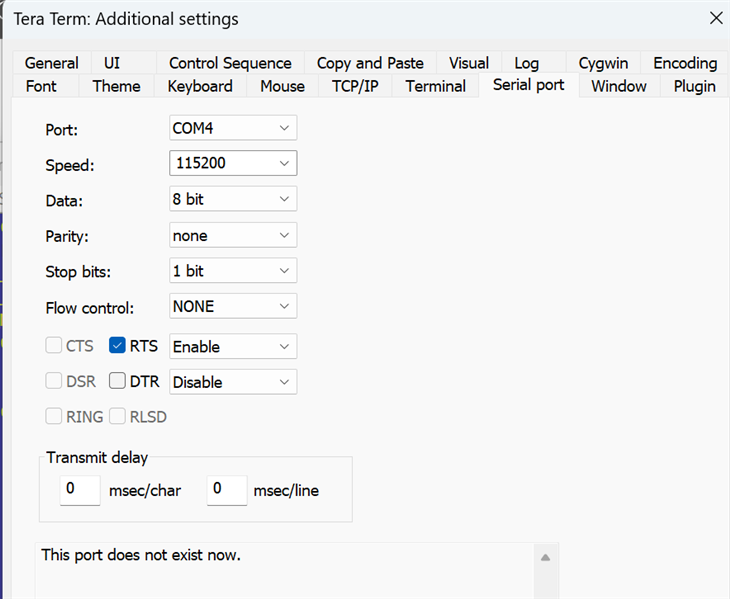

I wanted to eliminate the need for button-presses and jumper connections, so the *RTS and *DTR lines are used to try to reset the microcontroller, and to put it into boot mode. I was only partially successful. As the circuit stands, it is certainly possible for a user to reprogram the chip by simply plugging the USB connector to a PC, and running mspm0_programmer software. That works great. However, the microcontroller needs to be restarted manually (either press a button, or power-cycle). That’s not good, but I’ve accepted it and moved on : (
Another issue is that with this circuit, the user cannot use any arbitrary serial terminal software to access the UART which runs a menu system. The serial terminal software must support the disabling of *DTR. TeraTerm is suitable, but others such as MobaXterm are not. In reality this is not too much of a problem, because I don’t expect users to use serial terminal software. I expect users to access the configuration through a custom graphical interface. The direct serial terminal menu is more for the advanced user.

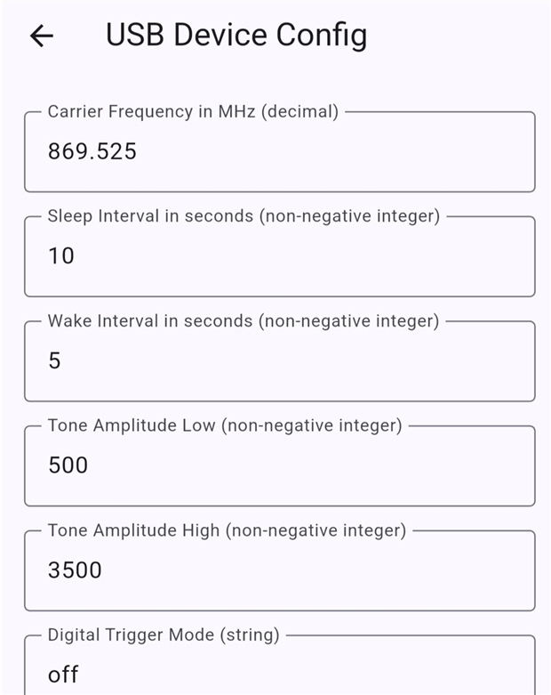

The unit has no display, and no essential buttons. The USB interface can become the primary method to configure the unit (although, as mentioned above, the radio interface can do that too). A limitation in the current design is that the microcontroller needs to be awake to access the user menu. It is easy to see that the microcontroller is awake because of on-board LEDs, or, the user could power-cycle the board and then immediately connect.
The menu uses GET/SET commands (e.g. SET awake_interval=600). However, the actual end user/installer is not an engineer, therefore I don’t expect them to fire up a serial terminal on the PC. Instead, they can use the AnyOperate app I worked on recently, for just this sort of scenario. It’s really convenient; using Android (for now; I don’t have a Mac to do the conversion for iPhone), one can connect to the outdoor unit via USB (or via USB, BLE or WiFi if connecting to the indoor unit) and configure it all from there. I’d like to modify that app to automatically pull templates from the web one day (that way the graphical display can be highly customized per project); today, all the config parameters are listed in a simpler manner (see the screenshot below) and the user just taps to select and modify.
If you’ve got projects that are hard to configure or monitor for users, it could be worth giving AnyOperate a shot, and if you don’t like it, please suggest new features. There is a lot that could be done to improve it; so far, the software supports just some basics.

For the intended use-case, I was not too concerned about making the project ultra-low-power; there is a solar panel plus battery outdoors, or alternatively, alkaline cells could be used; 4 x C cells might easily support a year of operation, i.e. $10 per year battery cost (and there’s no particular need for small size).
Here’s what I measured (at room temperature; it could be very different outdoors!):
State Current (mA)
Awake and transmitting and sensing 49
Awake and receiving and sensing 27
Awake and sensing 5.6
Sleeping 0.195

    shabaz 27 days ago +1
    Regarding the issue that reset would not automatically occur after programming, I just tried this mod: Basically, Q1 was the PNP transistor, that's been replaced with the P-ch MOSFET, and R7 upped…
    shabaz 27 days ago
    Basically, Q1 was the PNP transistor, that's been replaced with the P-ch MOSFET, and R7 upped to 100k, and added C22 in series with R6, but also shunted that with a 1 Mohm resistor.
    The idea was to make the BSL_INVOKE line go high only briefly, rather than keep it held high during programming, therefore allowing the microcontroller to reset at the end of programming, without going back into bootloader mode.
    It does work, but I don't know how reliable it will be.
    Here is what I see on the Q1 gate (yellow) and Q1 source (red), when the mspm0_programmer.py is started.
    This shows the Q1 gate again, and the BSL_INVOKE line (red). Nice pulse I guess.
    The screenshot below shows Q1 gate again (yellow), and the MSPM0 *RST line (red). Not happy it is going to 4V. I believe a fix for that could be to add a diode in series with the *RST line, so the CH340K can only pull it low. I still need to try that.
    The multiple pulses are probably because the programmer code enables and disables the *DTR and *RTS lines a few times at the beginning, it seems to be a driver thing (I didn't get reliable results in the past without that). Whether all this works with (say) Linux/Mac, and on different speed PCs, I have no idea!
    In summary: With this mod, I can program the MSPM0, and have it restart automatically, all under control of the USB, no boot or reset buttons need to be pressed. And I can access the user menu using TeraTerm, provided it is set up as shown below (see the DTR setting) again just under USB control, no button-press etc. But with that caveat, that this might not work for all setups.

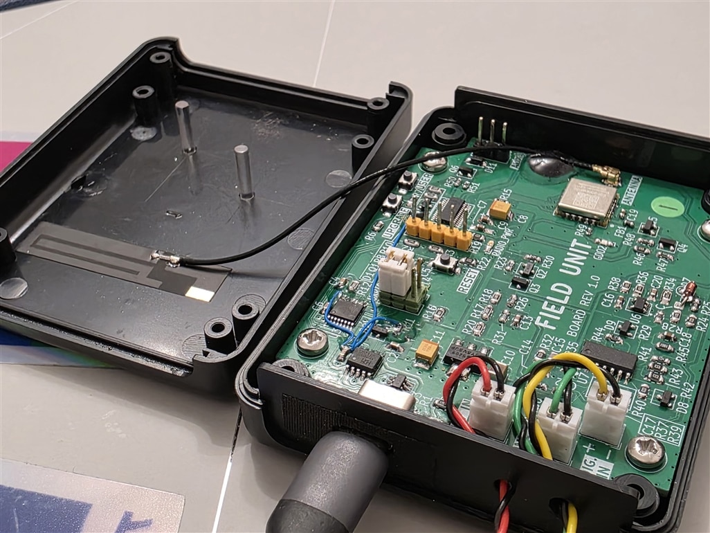

    I made two of the outdoor transmitters, one will be a test unit, so I put that in an enclosure before I accidentally damage the delicate antenna.
    If I had thought things through properly, I'd have made the PCB shorter, so I could have put the antenna on the end panel (at least 5 mm of clearance is needed from any ground plane).
    By chance I had some light pipes, they make quite a visual improvement rather than peeking down the LED holes. Red indicates the CC1101 is powered up, and the blue flickers on when transmitting.
