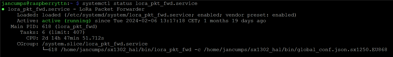

I installed the software for the Elecrow LoRaWAN gateway (see  Low-Cost LoRaWAN Gateways! ), and enabled the gateway on The Things Network (TTN). I used Raspberry OS bullseye 32-bit lite on a Raspberry Pi  A+. I tested this on a B+ with the same OS too.

./lora_pkt_fwd -c global_conf.json.sx1250.EU868
You will get a log of what's happening:
The TTN console confirms it found you:
And after some time, you will appear on the maps: https://ttnmapper.org/heatmap/

    Jan Cumps over 2 years ago
    This is running really reliable. More than 1 1/2 month now without interrupt. Memory, CPU and disk space under control.
    This weekend is summer time switch. Curious if the software will handle that well ...
    Jan Cumps over 2 years ago in reply to Jan Cumps
    still going strong. 3 months and counting.
