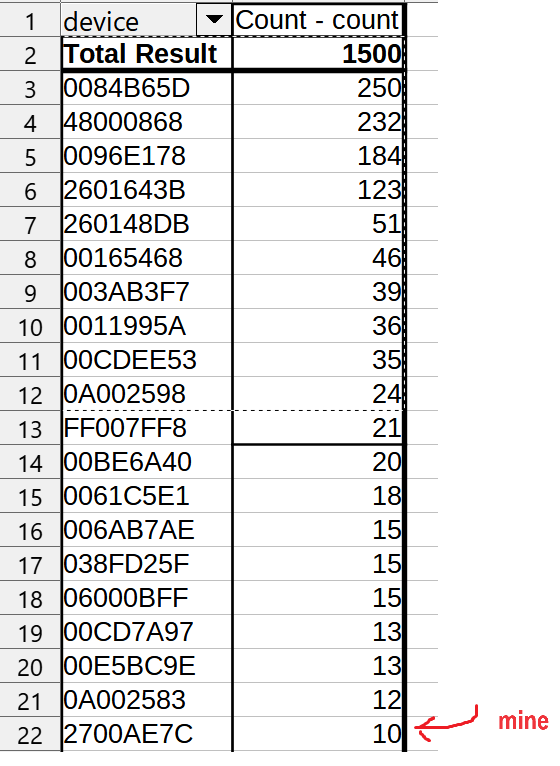

    Jan Cumps over 2 years ago
    Devices that contacted me 10 or more times in that period:
    The device ID is not a fixed number. It's an ID that a Thing gets when connecting to LoRaWan. A power cycle of a Thing will result in a new ID.
    A moment in time: 20 hours of connection capture. 1500 incoming communications.
    20 hours of gateway traffic.zip
    between 10-JAN-2024 00:40 and 20:40 CET
