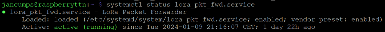

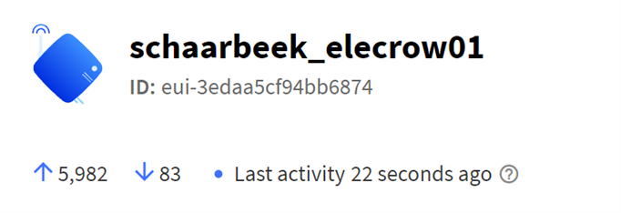

    Jan Cumps over 2 years ago
    Some more stats. The service is up for 46 hours: I can see that on the service status
    TTN Gateway console shows the uplink and downlink counts since last connect. Almost 6.000 uplinks, 83 downlinks
