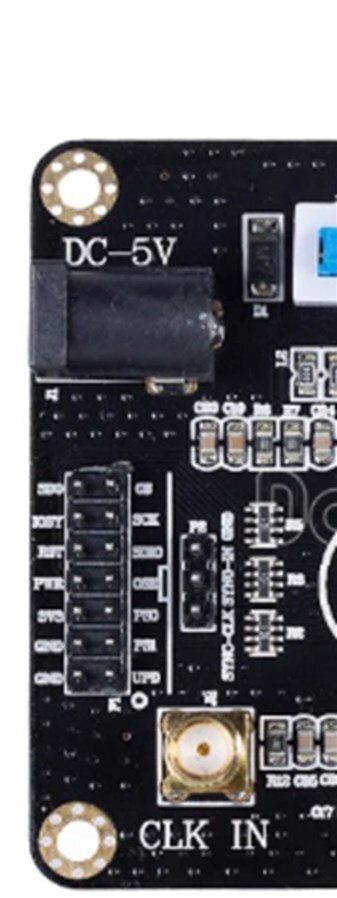

    Hi Derek,
    The parallel port uses high voltage (5V) whereas the AD9954 board needs 3.3V logic signals. Which Arduino do you have? If it is a 3.3V logic level Arduino (i.e. not Arduino Uno) then there's no need to use the Analog Devices software, you can  just use my code and modify it slightly to run on Arduino, at least to get you started.
    I can help with that, but I'd need to know which Arduino board you have. Alternatively if you have a Pi then that can be used too. In fact it will be easier with a Pi, since then my code can work with even fewer modifications (my code was tested on a Beaglebone Black which is very similar to a Pi). But for now if you only have an Arduino, let me know which version, and I'll suggest some changes to the code to hopefully get it working to at least generate a signal initially.
  • derick007
    derick007 over 7 years ago
    Hi shabaz
    I have both the ad9954 and arduino boards now.
    I have downloaded software from analog devices to evaluate the ad9954, but it looks like I need an lpt parallel port on my pc to do this.
    I dont mind doing this but as far as i remember the parallel port is db 25 way connecter, whereas the ribbon cable for the ad9954 is only 14 pins ?
    Is there a converter i need ?

    shabaz over 7 years ago in reply to derick007
    Hi Derek,
    It will be possible to reverse engineer these boards, there are only about half a dozen pins that need connecting between the DDS board and the Pi or Arduino. I used the AD9954 datasheet to write code to program it to output a signal at a desired frequency, so that code can be reused/ported if you like. Here is my C code:
    https://github.com/shabaz123/FreqSynth/blob/master/dds.c
    (tested on Beaglebone).
    The first dozen lines or so list the connections that are needed, so these would need to be identified on the China boards. I tried zooming into the photo of the China board on aliexpress, and there is text identifications, but just too small to be readable 100% from the photo, I can make out 60% or so of the pin names.
    The pins I used to attach to the beaglebone are in the code, they are:
    IO_UPD, SCLK, SDIO, *CS, RESET
    and also a 5V supply and a 3.3V supply was needed, but I don't know what voltages the Chinese
    board requires.

    All the Ad9954 seem to be shipped from China whether using ebay or aliexpress.
    Unfortunately, it is only the board you get, no support info. (drawings) / software, drivers etc. Presumably drivers and other necessary support can be obtained from Analog Devices.
