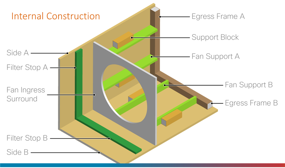

The diagram here shows the internal layout. There are a lot of wood pieces, so it helps to label them as soon as they are cut to prevent confusion.
Just to explain the diagram, it is constructed like a tube, with an air ingress side and an egress side. The ingress side is on the left side of the diagram.
The enclosure is designed for an exact fit around the HEPA filter because that is the largest component. It will drop into the tube from the left side until it hits the Filter Stop A/B pieces. The fan array will drop in from the right side of the tube, until it hits the Fan Ingress Surround.
Since the fans are smaller than the tube, they are centred inside the tube using the Fan Support A/B pieces.
The small pieces marked Support Block could be omitted, but are used for strength.
The Egress Frame A/B pieces are used to provide some thickness for attaching the Egress End Plate (not shown on the diagram).
The four sides of the tube (only two sides are shown in the diagram) are glued together permanently. The design was created such that the filters and the fans are removable for servicing by unscrewing the respective end plates of the tube.
Perhaps a speaker enclosure could be repurposed for the outer shell to save some effort.

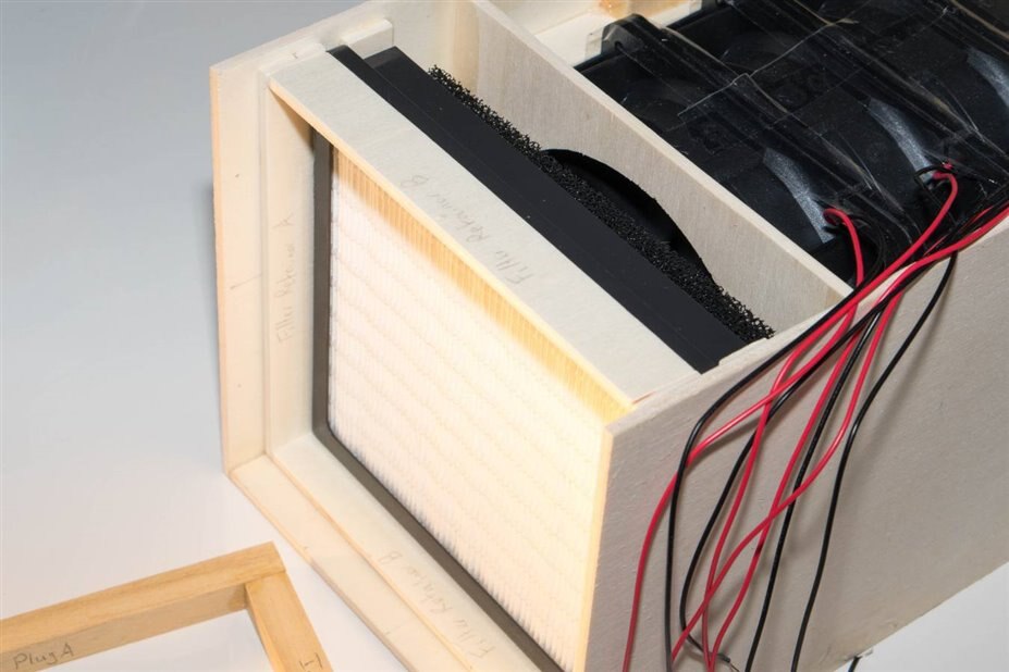

  14. Test that the four fans (taped together) comfortably but snugly fit into the assembly up to the Fan Internal Surround (see photo below).
  15. Test that the HEPA filter (Filter B) comfortably but snugly fits into the assembly, and hits the Filter Stop A/B pieces.
  16. Remove the filter and fans, and glue on the final remaining side piece (Side B)
  17. Glue the final Fan Support B pieces (trim them first slightly to have some room for wiring), and the remaining Filter Stop B piece.
  18. Glue the Ingress Plug to the Ingress End Plate
  19. Now the Ingress End Plate and Egress End Plate can be screwed to the main assembly!
The photo here shows the fans being tested for fit; they are taped up together and they they should easily slide in from the egress side.
The HEPA filter (Filter B) was also checked for fit:
The filter has a rubbery lip which mates with the side of the Filter Stop A/B pieces, creating a nice seal. The filter will be held in place firmly when the end plate, the Ingress Plate, is screwed on. The idea is that the filters are removable simply by unscrewing the Ingress Plate.
