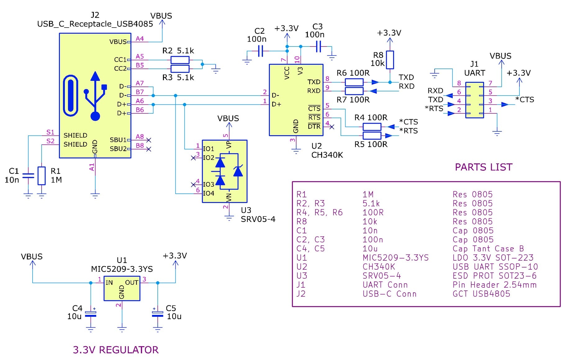

Circuit Diagram
The circuit follows one of the examples in the CH340 datasheet, specifically the one in section 7.6 in the datasheet, with some minor differences.
Here is the PDF version of the circuit.

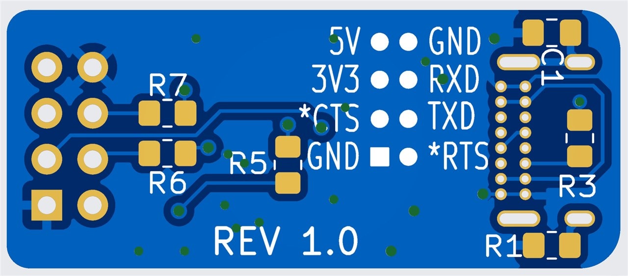

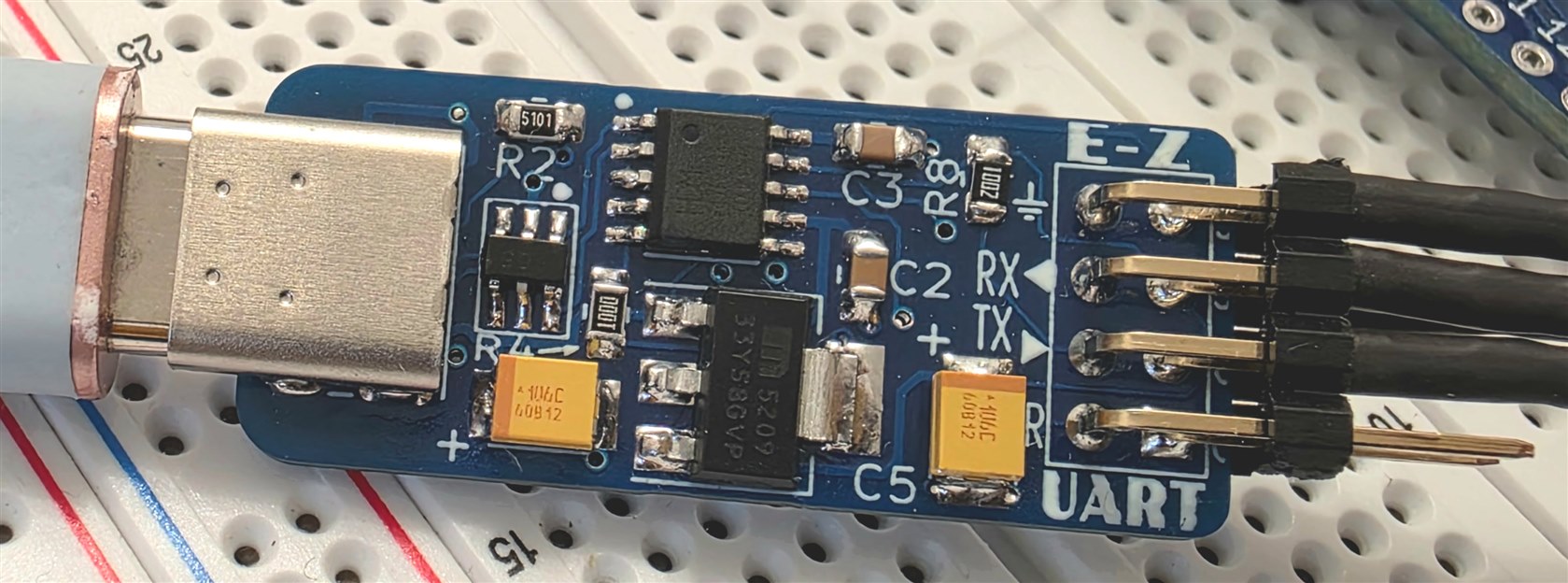

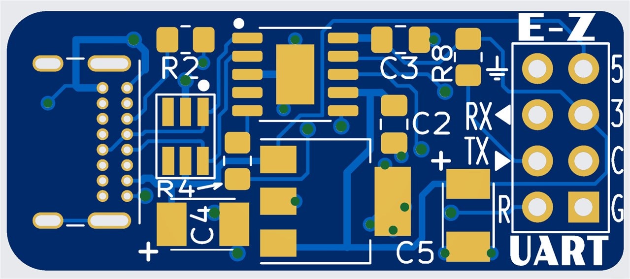

Building It
I sent the E-Z UART Gerbers zip file to a PCB manufacturer. The PCB is easy to assemble, and the smallest passive component is 0805-sized. The USB-C connector may look awkward, but it's remarkably easy to hand-solder. The pins on the USB connector are very short, and don't actually poke out the other side of the board, reducing the risk of shorts there. Solder just wicks into the tiny holes in the PCB, almost eliminating the risk of shorts provided thin solder is used, and a small soldering tip.
Another technique is to force some solder paste into the holes before placing the connector on the board; it works well, but isn't essential.
If you prefer the USB connector pins to protrude slightly on the underside of the board, you can order a 1mm (or 0.8mm) PCB instead of the standard 1.6mm thickness. Again, it's not essential.
Using It
So far, I've only tested up to 115200 baud, and only with Windows. I simply plugged the board into the PC, and it automatically installed a COM port. I've yet to try Linux. I don't think it works on Android without a driver.
Summary
The CH340K was easy to use to assemble up a little USB-UART adapter board, and it seems to work fine.
