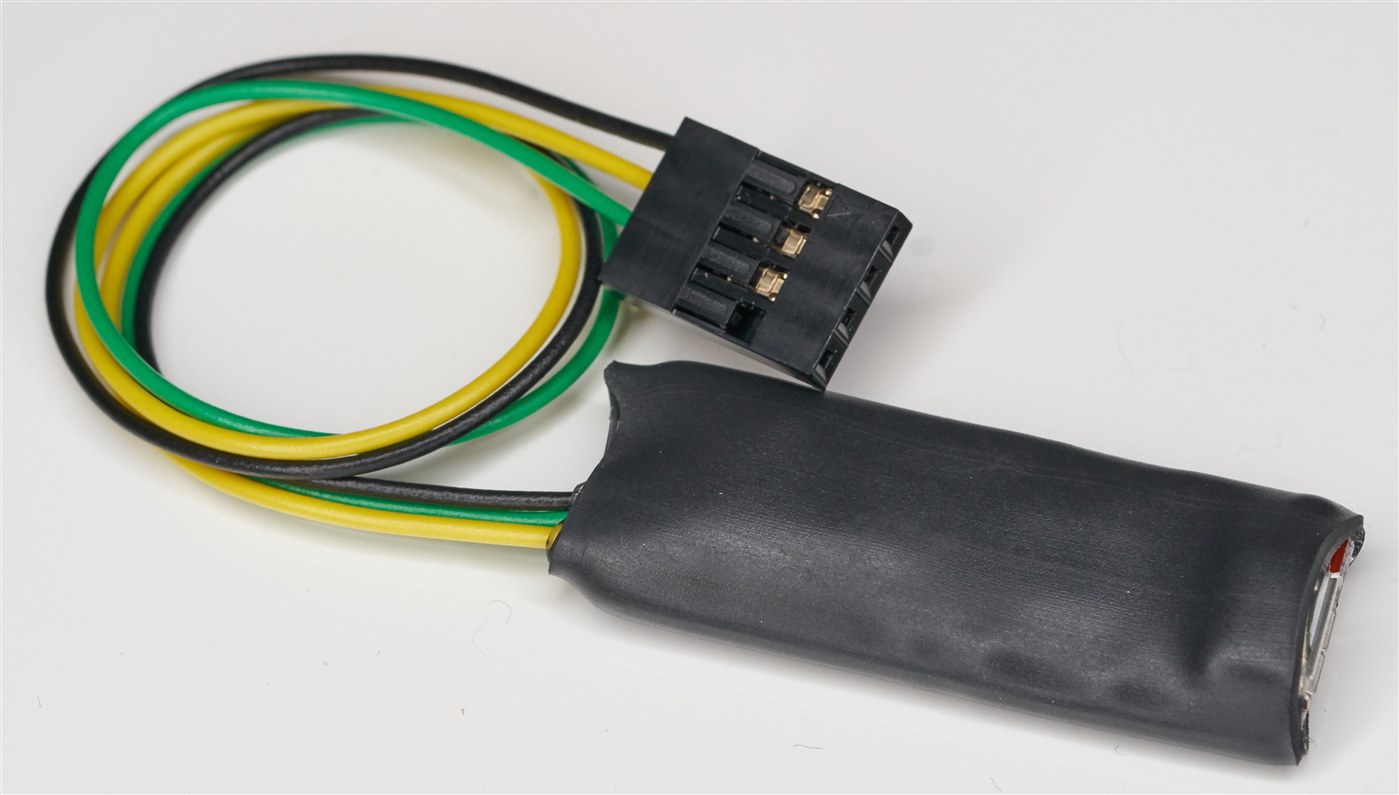

EDIT: Another method that works nicely is to use an Infineon XMC 2Go board, which is ultra-cheap : ) I used this board: KITXMC2GOXMC1100V1TOBO1
The XMC 2Go board is a microcontroller board with an in-built J-Link debugger. The board can be converted to just a J-Link debugger in a couple of methods that do not require any hot air tool. The two methods are described here.
Method 1 (the slightly more awkward method) requires cutting two tiny traces. They are quite tiny! I used an engraver with a bearing cutter bit (see this blog post) and it was very simple to do with that.
Next, connect up three wires as shown here:
There's no standard pinout for SWD for 0.1" SIL header pins, so I use the convention shown in the photo below for my projects. Pin 4 is unused (it would be VTARGET normally, for the debugger to detect the logic level voltage used on the board), and an optional pin 5 can be used for debug/information messages, called SWO.
That's it, the board is ready to use as a SWD debugger/programmer : ) When you plug it in, an upgrade message may appear (in my case, it upgraded twice), select Yes to upgrade.
For the second method, if you don't feel comfortable cutting the traces, then it is possible to just remove the two resistors that are on the top side of the board, and solder to the other end of the resistors, inserting two 100 ohm resistors in-line.
The diagram below shows what to do for this second method.
In summary, there are a ton of options for SWD debuggers, and whichever of those is chosen, the SWD method is what I’ll be using for this blog post.
Once you have a SWD capable tool, four connections are made to the board: 0V, SWC, SWD, and (if the tool has such a connection then it must be connected) a connection to the supply voltage called VTARGET, which the SWD debugger uses to recognize what voltage levels to use. In my case, I powered the DA14531 module using two AA batteries, and so the VTARGET pin on the J-Link Lite was connected to the positive supply from the battery as shown in the circuit diagram above.

    shabaz over 4 years ago
    I wasn't happy not having a good cheap SWD debugger option, but I think I've found one!
    The Infineon XMC 2Go board is about £5 / $6USD, and can be easily modified into an incredibly tiny J-Link SWD debugger : ) I tested it, and it works.
    I've added the information to the blog post.

    shabaz over 4 years ago in reply to shabaz
    Basic SWD option with the XMC 2Go board : )
    Not totally great since it is missing a USB UART for simplifying code troubleshooting, but for £5 I think it's OK, a separate USB UART can be used at this price!
