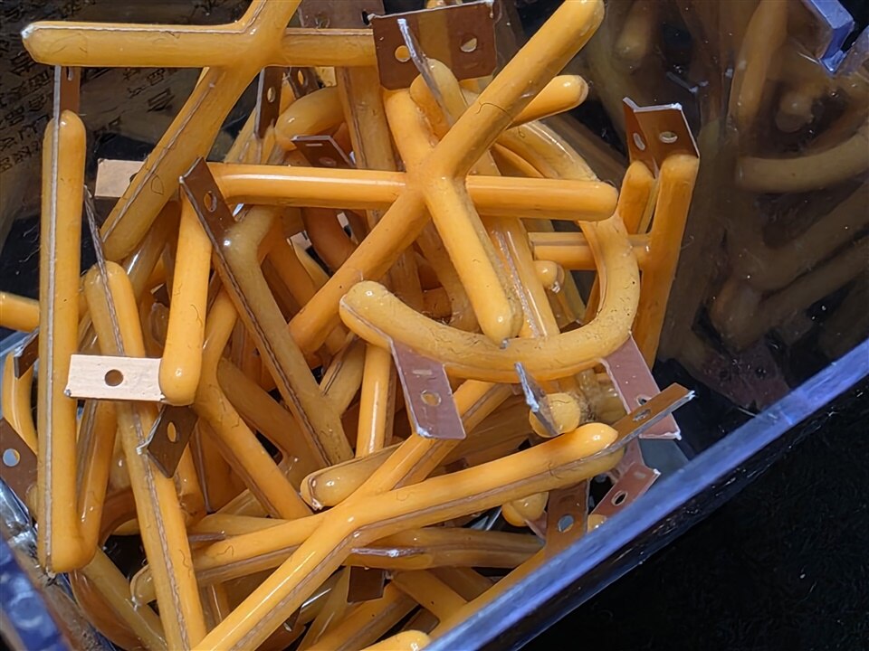

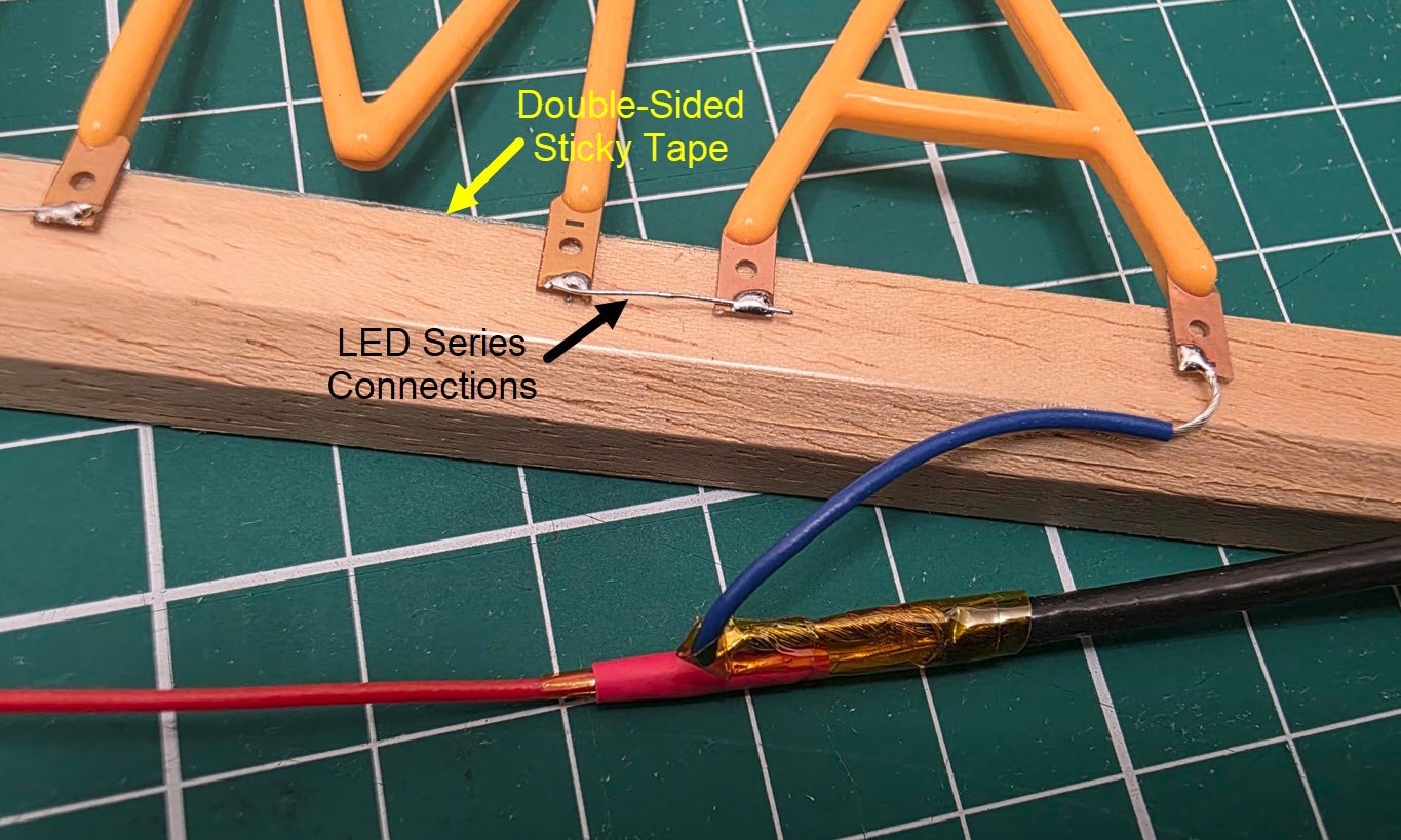

Good quality double-sided tape was applied to an inside edge, and then I stuck on 30mm-high LED characters obtained from AliExpress. They are soldered in series, using thin bare wire, and then a length of two-core wire can be attached to the two remaining ends.

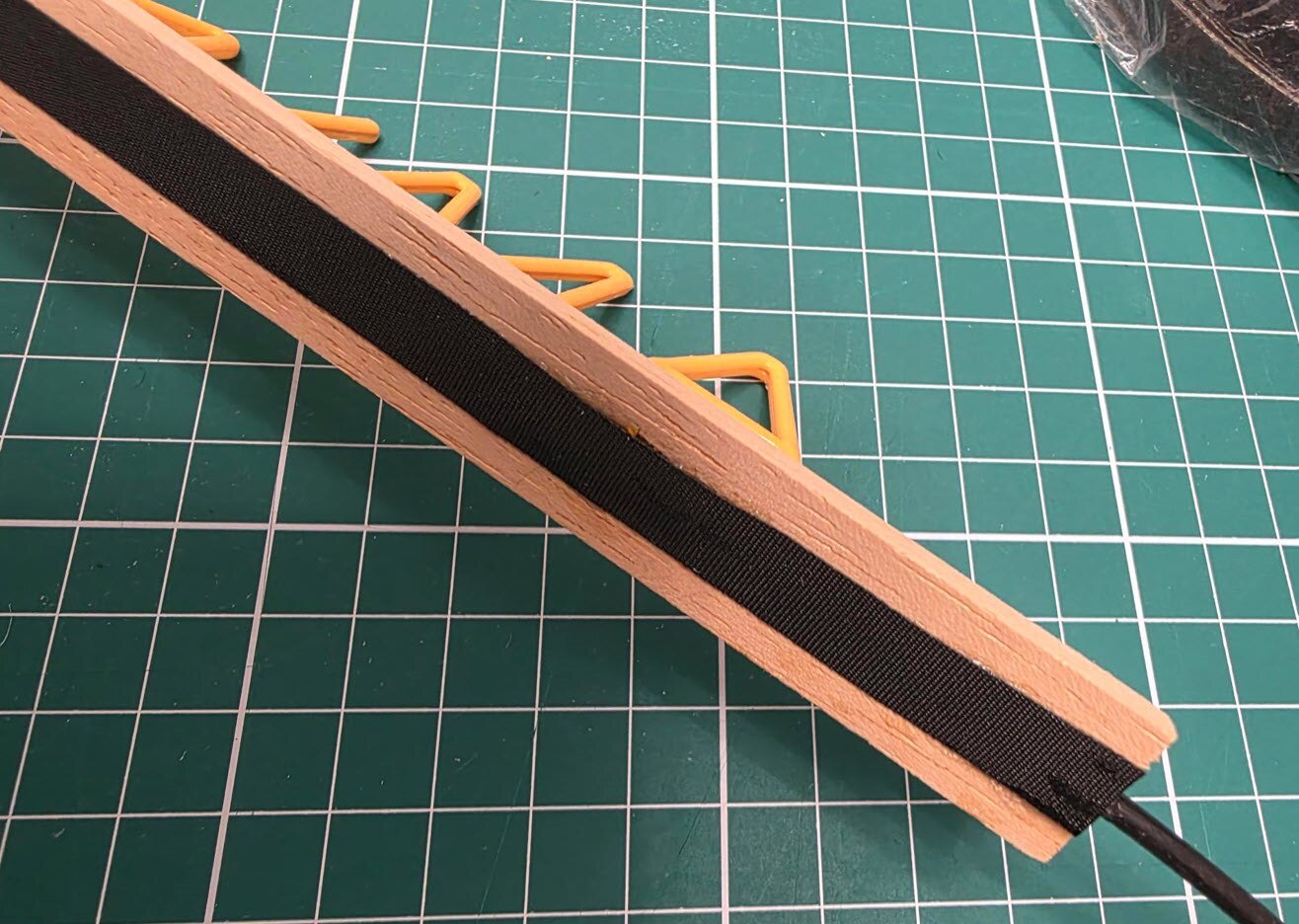

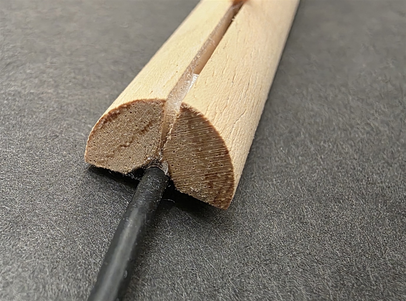

After that, more double-sided tape was applied on top, and then the second dowel piece was pushed against it, to form a semi-circle. Everything was then secured with epoxy glue. Some black adhesive tape (maybe fabric or felt) can be put on the underside afterwards, to hide wires.
Here's the end view:

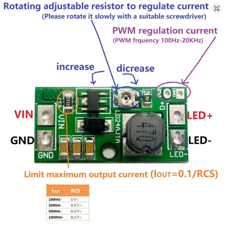

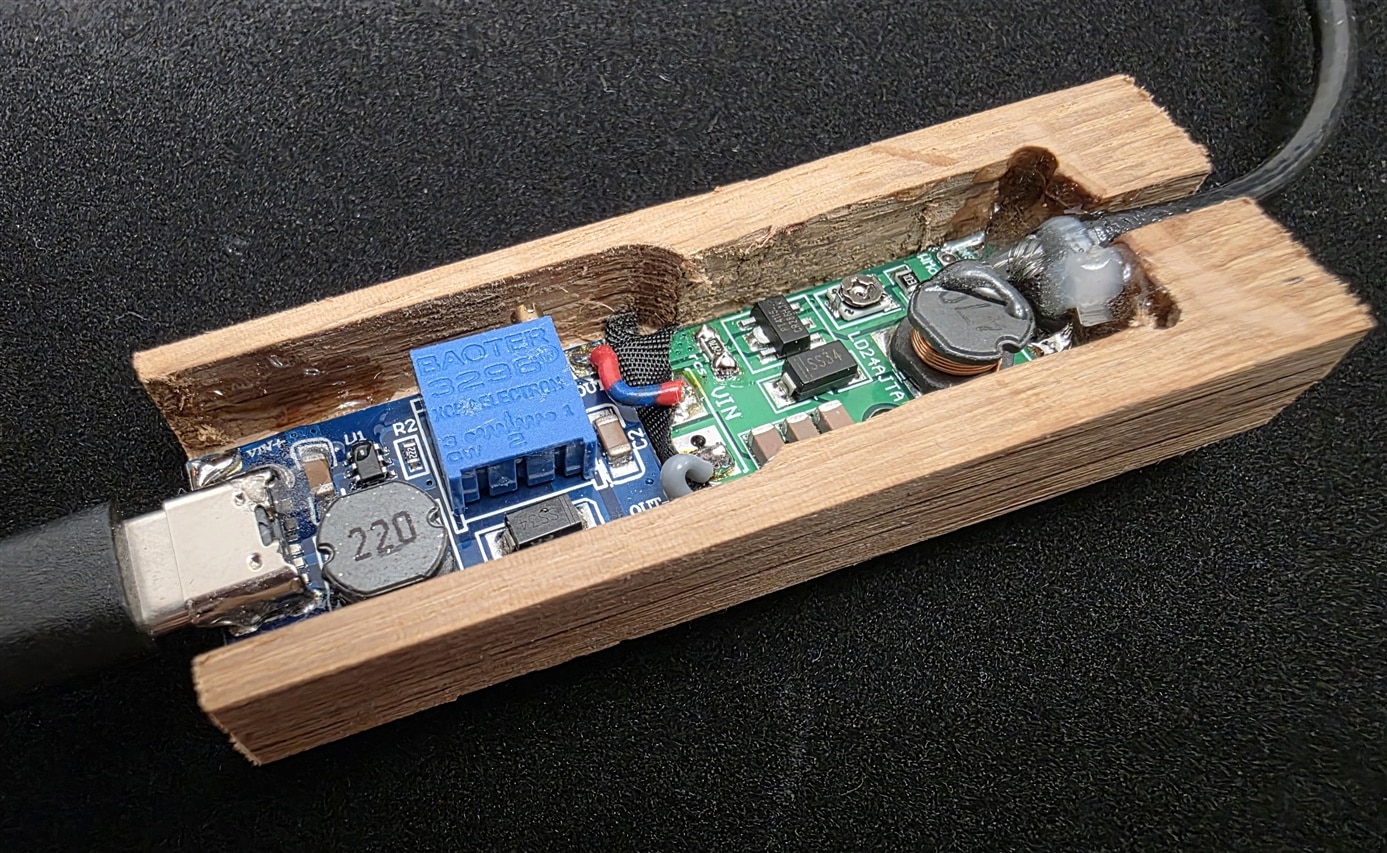

I used a ready-made DC-DC converter board that accepts 5V from a USB phone charger and outputs about 23V. That's the blue board in the photo below.
The green board in the photo is a constant current driver that accepts 6-24V input, and outputs an adjustable current value (there is a tiny trimmer potentiometer).
As well as the trimmer potentiometer, there is also a small resistor that sets the maximum current. I desoldered that resistor and swapped it with a 2.7 ohm part, which should limit the maximum current to a few tens of milliamps (I didn't measure). The brightness seems fine with the trimmer resistor just set to the middle position.

An enclosure could be 3D-printed, but I crudely milled out a piece of wood. I will fill one end with black PolyDoh, and then close it up with a thin piece of wood.

    The DC-DC converter board is adjusted to 23V first, before soldering it to the Constant Current Board (which has a 24V max limit). There is a resistor which is replaced with 2.7 ohm, to reduce the current output.
    Next, I got the stick of wood dowel, applied a layer of double-sided tape and stuck on the characters:
    Then just solder the LED characters in series, and attach the ends to the cable:

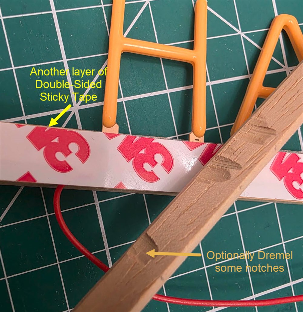

    I applied a layer of double-sided tape on top, and then optionally dremel some notches on the second piece of dowel, if you want it to fit a bit better, but it's not necessary.
    This is what the underside now looked like, with the two pieces of wood pressed together:

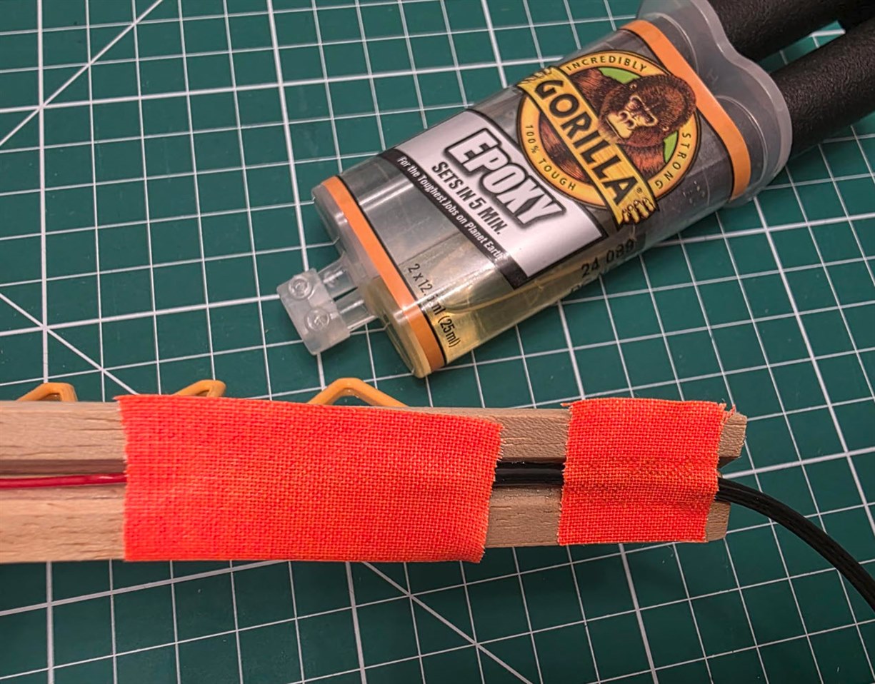

    To make it more permanent, I applied some epoxy glue at the ends of the groove, and put some temporary tape on top until the glue dried (and then remove the tape).
    Finally I applied some black tape to make it look nicer. Job done.
