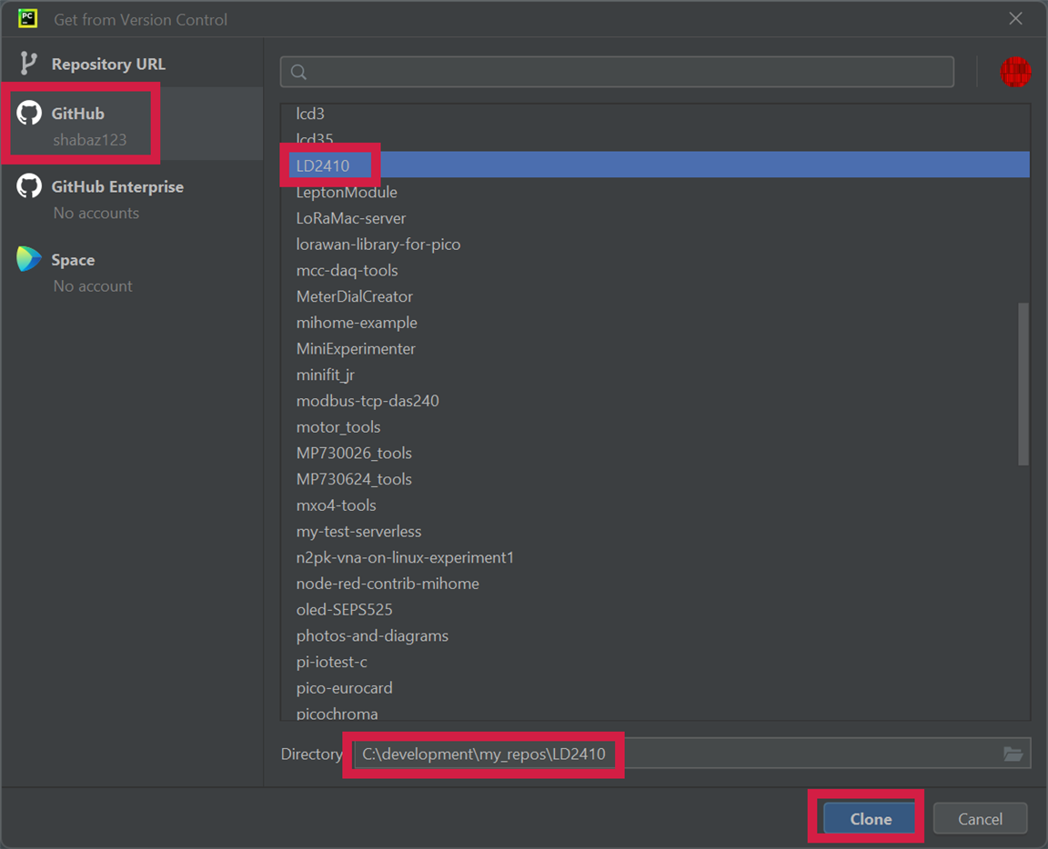

At startup, in the Welcome to PyCharm window, click on Get from VCS (Version Control System):
If you wish to work on your own code, select GitHub and then log in; a browser window will open up for entering your GitHub credentials:
Select your project repository, and then confirm that the destination (local) directory folder on your PC is fine, and click clone. In the example screenshot below, the GitHub repository is called LD2410, and the destination path is C:\development\my_repos\LD2410
PyCharm will download the code into the local folder C:\development\my_repos\LD2410 and PyCharm will launch into its main layout, which can be examined. All the key areas that will be used in this blog post are highlighted in the screenshot below.

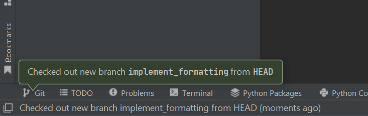

You’ll be prompted for a new branch name. Ensure that the Checkout branch box is checked, as shown in the example screenshot below. In the example, the new branch is called implement_formatting:
The lower-left corner will show a popup speech bubble indicating success:
You can open up the Git lower window if you like, to see that the new branch has been created. Ensure that the new branch is indicated at the lower-right corner of PyCharm.

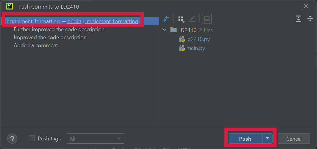

Note that all these commits are in the local folder, and not in the cloud. When you’re happy to do so, transfer the commits to the cloud, by using the Push icon as before:
The pop-up window will indicate the feature branch name, and underneath that, it will indicate all the commit operations. In the example screenshot below, three commits were done, and they all need to be sent to the cloud. On the right side, you can see the affected files where the code changes were made. Ensure that the branch name is selected on the left, and then click on Push:
Now anyone looking at your branch on GitHub can see the changes:

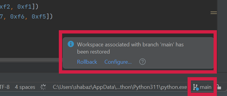

You’re now ready to update your local copy of the main branch, and then create a brand new feature branch.
At the lower-right corner of PyCharm, click on the old feature branch name, and select main and then Checkout:
A pop-up message will indicate that the project’s local folder branch has been changed. The code in the project folder now contains the original old main branch content.
You can update the local folder to contain the latest main branch content from GitHub, by clicking on Update Project from the Git toolbar:
Click on OK in the Update Project pop-up window:
In the background, a Fetch and Merge operation is actually being performed. Now the main code in your local folder contains the same content as the latest main code on GitHub.
