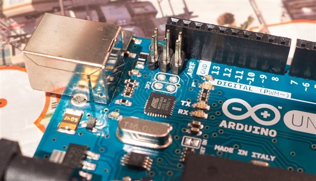

An example design: the Arduino Uno doesn’t use an FTDI part – it has used an Atmel ATmega part for half a decade.

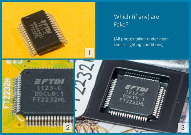

About eighteen months ago, FTDI did something that possibly could have caused people to claim for legal damages in many countries. It went against ethics according to some engineers, and as mentioned it was possibly actionable in law in certain countries. Manufacturers can be legally liable for damage that their products cause to other property. According to reports the FTDI driver deliberately 'bricked' (by which I mean rendered inoperable for non-technical users, requiring detailed procedures to revert back to the original state) the USB Serial interface in products that had a chip which was not manufactured under license from them but was attempting to use their driver. They did this by forcibly zeroising an EEPROM memory field in the user's product.
It is unknown how many devices were bricked, nor if FTDI offered to make good and provide compensation to users who had bricked products. FTDI's go-to guy for press releases was asked several times to comment last month but he refused.

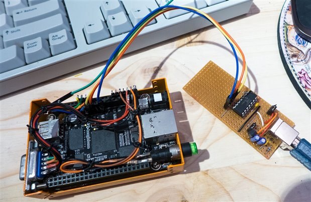

The Microchip MCP2221 is a nice part as can be seen from the table. It is available in prototype-friendly packages (including DIP!) and is extremely easy to use. For an example MCP2221 project see here.
Here it is being used with the BeagleBone Black..

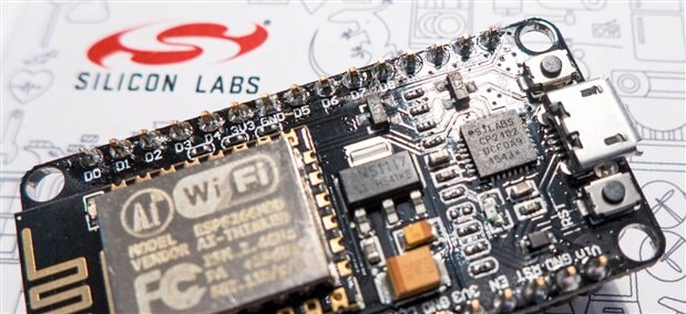

The CP2102 from Silicon Labs is another option. It works well and is therefore extremely popular.
