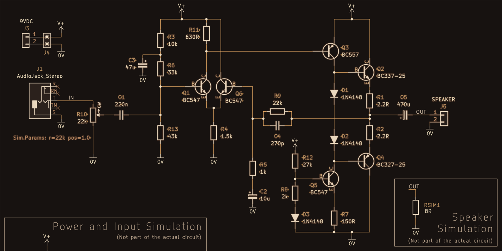

Circuit Diagram
The green portion of the circuit was constructed and tested in blog #1. For this blog 2, the blue portion was assembled. Also, the capacitor C8 was temporarily disconnected at the spot marked with X, so that the blue stage could be tested in isolation.

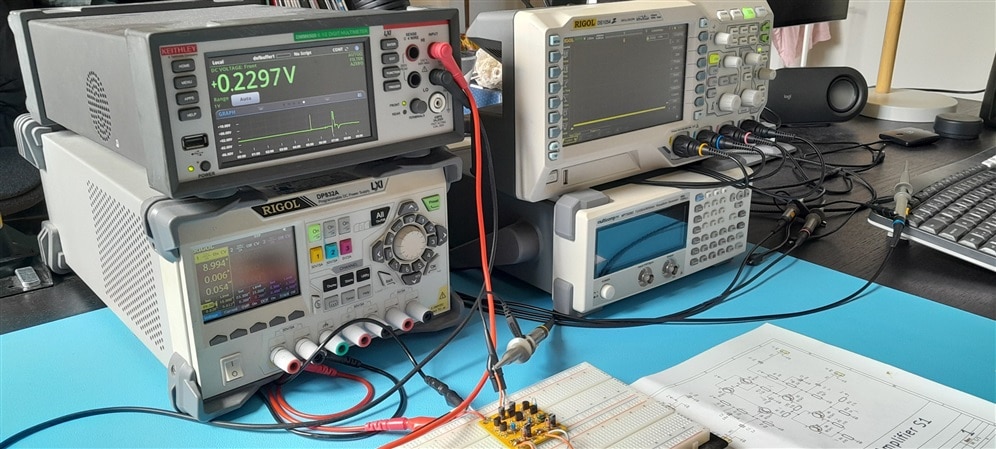

Usually, one uses oscilloscope probes to view signals in a circuit under test. Sometimes I use a thin coax cable instead. It’s not recommended, but you can get away with it for some tests, especially at very low frequencies, such as for audio amplifiers. Where a coax cable becomes important is for delivering signals from a signal generator or for viewing signals at higher frequencies, provided that the cable end has a 50-ohm termination.
In any case, I used coax cables with small SMA connectors on the ends, because SMA sockets can be low-cost, and are easy to solder onto a PCB with short lengths of wire, but you could use proper oscilloscope probes as recommended.

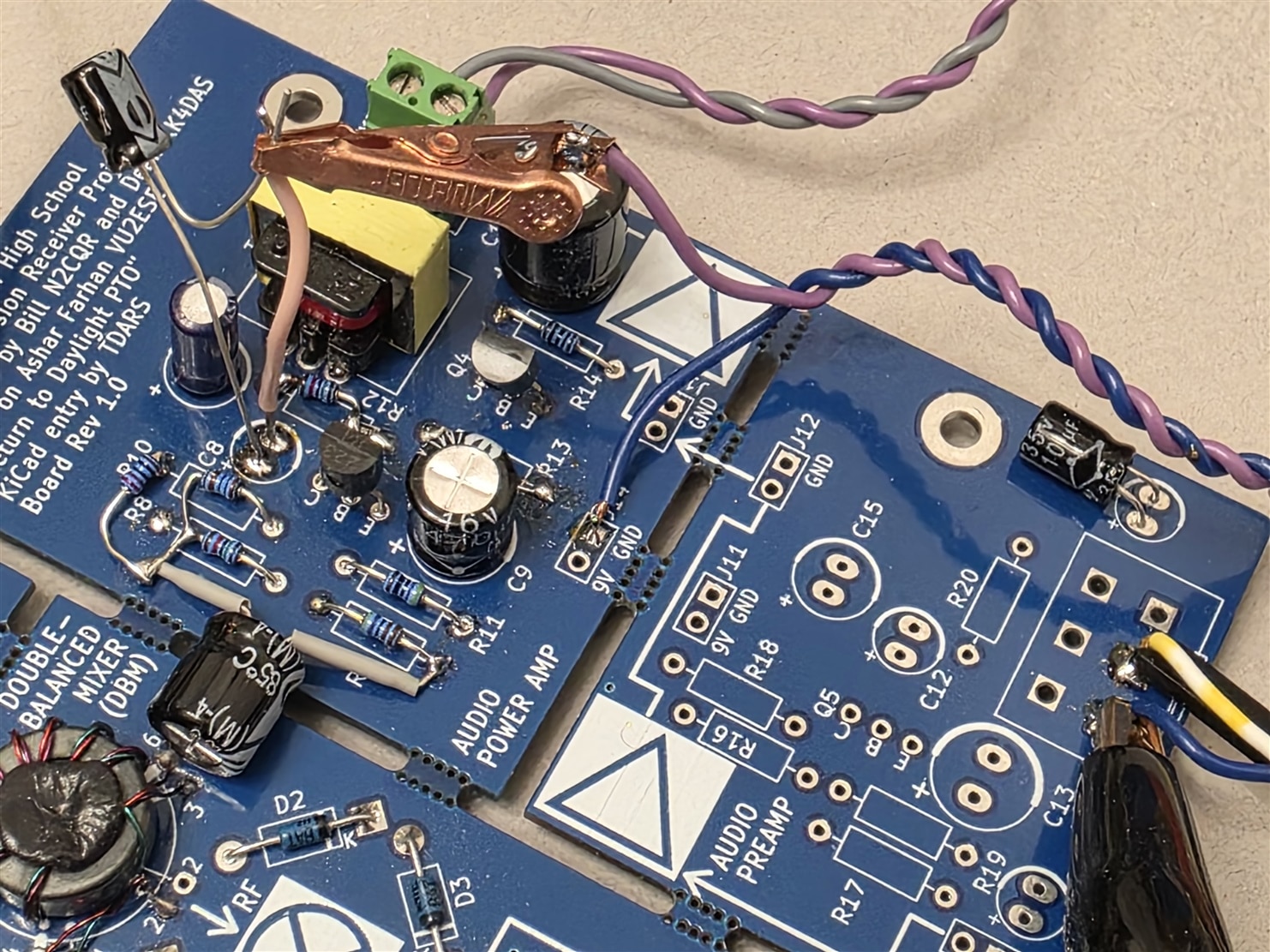

Power Supply Problem!
For initial testing, I shorted the input of the audio amplifier (actually, I just attached an SMA attenuator because it was close at hand; that’s almost a short), and then probed the output at the output capacitor, with the last stage disconnected at the spot labelled X as discussed earlier.
You’d expect to see a flat line on the ‘scope, close to 0V (or 0V if you’ve set the oscilloscope to AC input).
The project is intended to run from a nominal 9V supply, specifically a 9V battery. For testing, I was using a bench power supply that had an unfortunate fault: approximately 30 mV amplitude pulses at about 300 Hz (I don’t know why; I’ll open it up sometime). The power supply pulses are shown in green in the screenshot below.

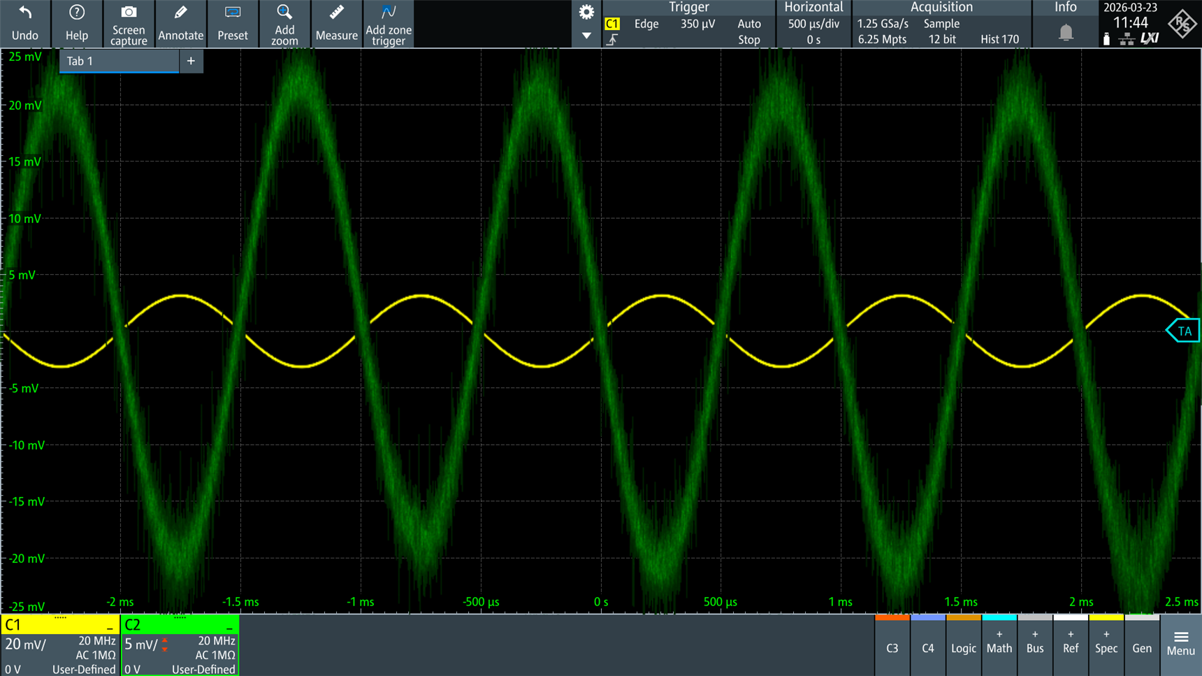

The yellow trace is the amplifier stage output! It’s unusable, since if the expected output from the amplifier stage is to be about 40mV p-p, the pulses are of a similar ballpark amplitude; it would completely destroy the signal-to-noise ratio for the desired signal!

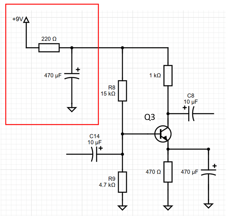

The problem occurs because the amplifier is not very good at rejecting power supply ripple. Ordinarily, this might be unnoticeable when powered by a 9V battery, but as soon as you connect any realistic power supply, the noise on the supply rail will swamp the output, because all typical power supplies have noise. The problem will be even worse for the amplifier stage that will be built in blog 3, since that stage handles even lower-amplitude signals at its input, but I’ll cross that bridge when I come to it. If you have any suggestions, please let me know! (ideally in-tune with the circuit philosophy, which is discrete parts; perhaps I need a Zener supply? The amplifier stage's current consumption will be just a few milliamperes.
One solution is to decouple the supply using some filtering. To do that, I disconnected the two resistors from the 9V supply rail, and inserted a resistor and capacitor as shown in the red box. Apologies for the poor circuit diagram; my PC was missing KiCad.
Now the result was usable. As can be seen, the 30 mV PSU spikes (green) are now just 1 mV spikes (yellow). Hopefully, most typical power supplies will have a bit less noise than my faulty PSU.
To summarize, the main takeaway is that such basic amplifiers need a stable power supply, especially when the output signal is expected to be low amplitude, and at a minimum, it could be a resistor and capacitor filter in the supply rail to the amplifier.
The photo here shows the extra resistor and capacitor bodged onto the PCB. The alligator clip attaches to the amplifier's output (the negative lead of capacitor C8), and the pink wire next to it is used to reconnect the amplifier to the next stage when required. The amplifier input is lower-right in the photo (where the potentiometer would normally go).

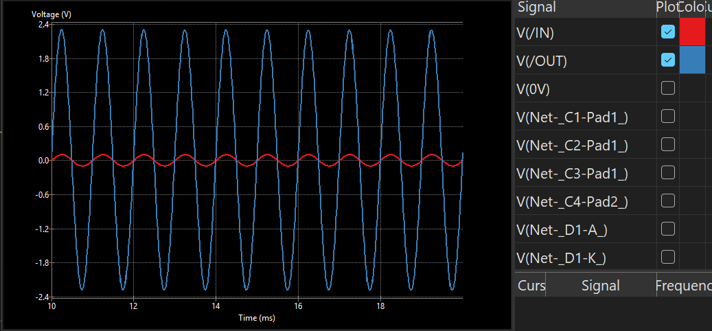

I applied a signal, added attenuators as required, and adjusted the signal generator output so the green output was about 40 mV p-p. The yellow signal shows the signal generator output, but the amplifier input was connected to an attenuated version of that, therefore the displayed amplitude of the yellow trace can be disregarded; the amplifier gain is about 95, so the attenuated input will have been approximately 400 uV p-p.

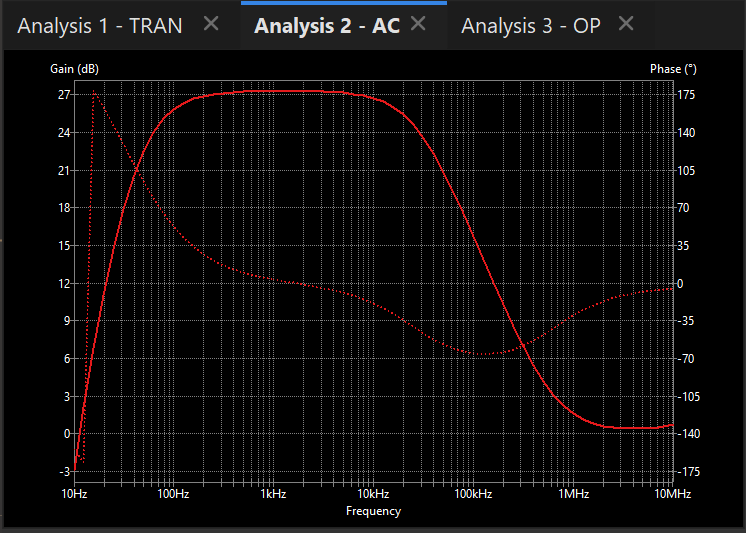

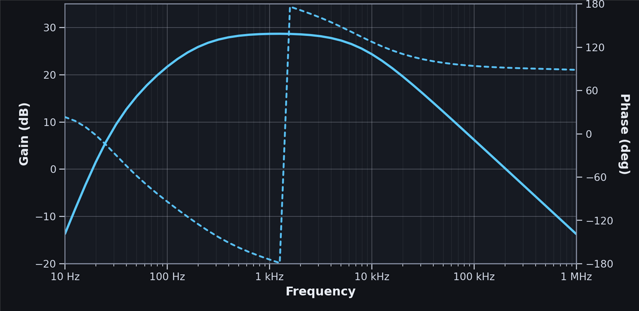

The screenshot below shows the frequency response in blue over the range of 100 Hz to 10 kHz; as can be seen, it’s essentially flat. The dB value on the left is not relevant, since the signal at the amplifier input was attenuated, as mentioned earlier, whereas the oscilloscope was attached directly to the unattenuated signal.

The screenshot below shows the 2 mV p-p input in green, and the output across an 8-ohm load attached to the final stage is shown in white.
Here’s the frequency response (ignore the dB value, since I again used an attenuator, whereas the frequency response chart uses the direct signal generator output). While not perfect, I think it’s very acceptable for speech and tones:

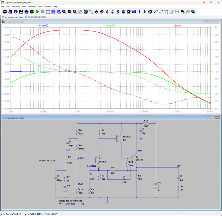

    Thanks for trying this out!! You're right, Q1 and Q2 are unnecessary, I needed far lower gain so I pulled the signal from the other leg of the LTP, but left Q1/Q2 just in case anyone wanted to experiment with higher gain for any project, they can tap the output from the correct side. I ordered the PCBs yesterday, but looking at your circuit, I have a plan; I just need a small daughter board designed to fit on top with those two output transistors, and I think it can be easily modified! I'll give that some thought hopefully later today (I have some time - dental work today so I will want some distraction later : )

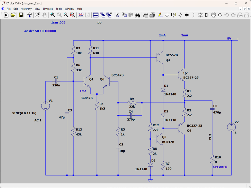

    Hello Shabaz,

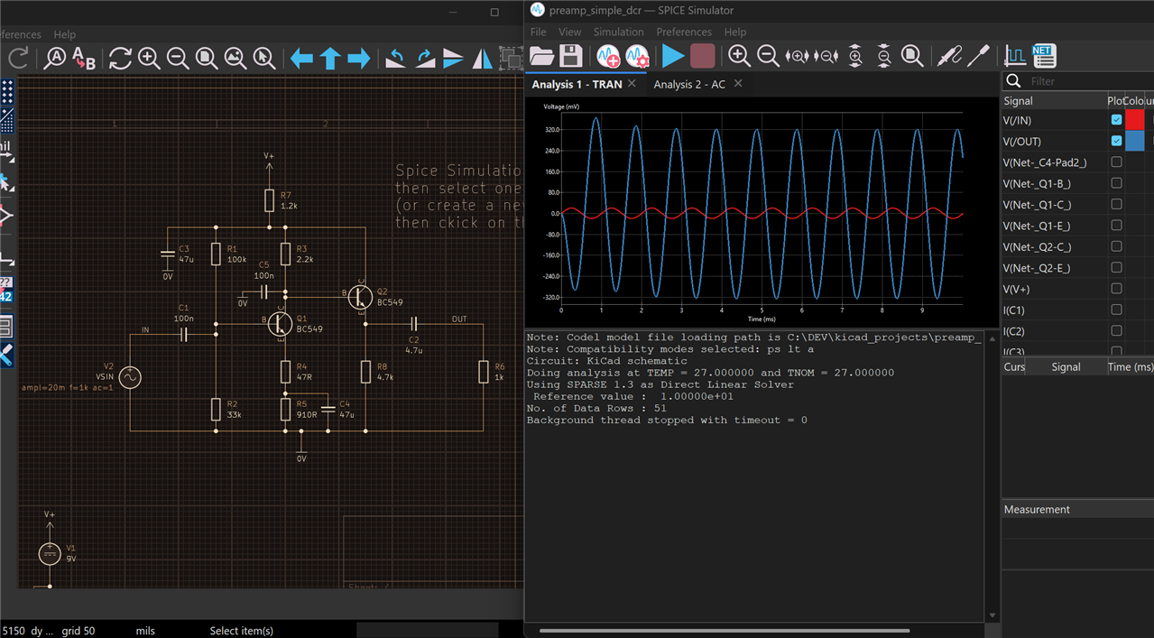

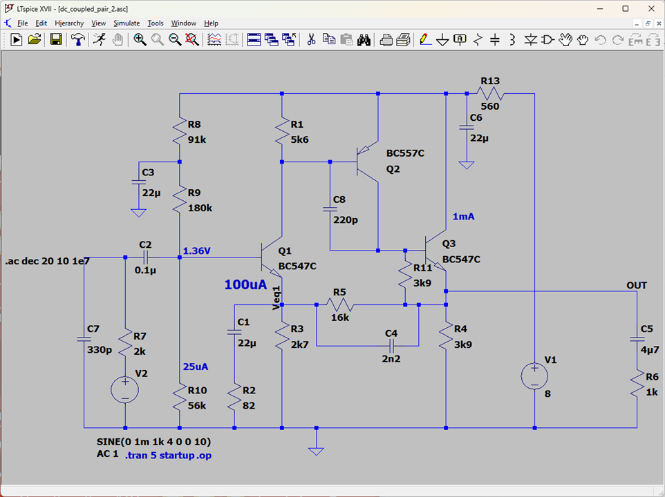

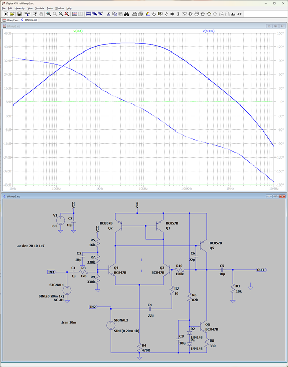

    I had a bit of play with your diff amp in LTSpice and I've come to the conclusion that I don't really understand how it's meant to work.
    Usually the long tailed pair plus current mirror amp design takes the signal pick up off the other side of the current mirror. Or to put it another way the bases of Q2 and Q1 are connected to Q2 collector.
    And the resistors R1, R2 and R13 are all zero.
    If you do that the Q4, Q3 diff amp works as expected with lots of gain so you have to use negative feedback to control the gain and set the DC bias point.
    The long tailed pair isn't good at output swing so using an additional PNP device to invert and level shift  the signal at Q1 collector is  a better use of extra transistors than using Q6 and Q5. (Might as well use a resistor there because the voltage on the LTP emitters hardly changes.)
    Your approach of adding R1 and R2 and R3 to reduce the gain sort of works but makes the gain different for the two inputs.
    So that brought your circuit quite close to mine plus the current mirror.
    The current mirror makes it easier to balance the DC and increases the open loop gain to more than 82dB (at about 6kHz in my sim. for a stellar (if un-necessary) 60MHz GBW or more.
    The more complicated output stage means it can certainly manage at least 4V p-p on the output (probably 6).
    (R2 has been set to 10R and C4 to 22uF rather than the usual 1k5 and 1uF  to remove any AC feedback for this test.)
    Pos input on Q4, neg input on Q3 now because Q5 inverts the signal. LongTailedPair (LTP) signal taken off Q4 so current mirror bases must connect to Q3 collector.
    I must try this topology (LTP + current mirror) for a high voltage signal amp.
