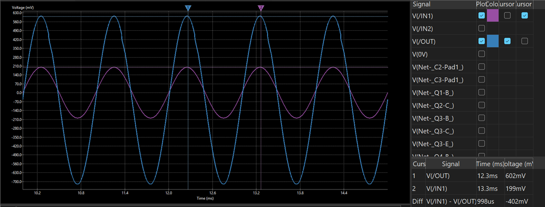

    Since the intention is to drive about 100mV into a 1k load a lower Q5 collector current would be fine.
    I tried this (in simulation)

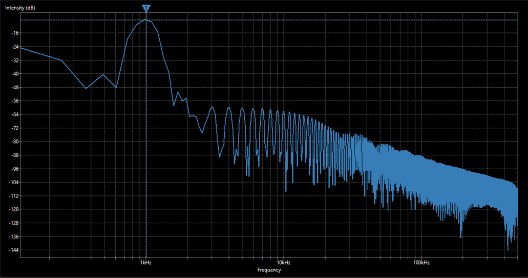

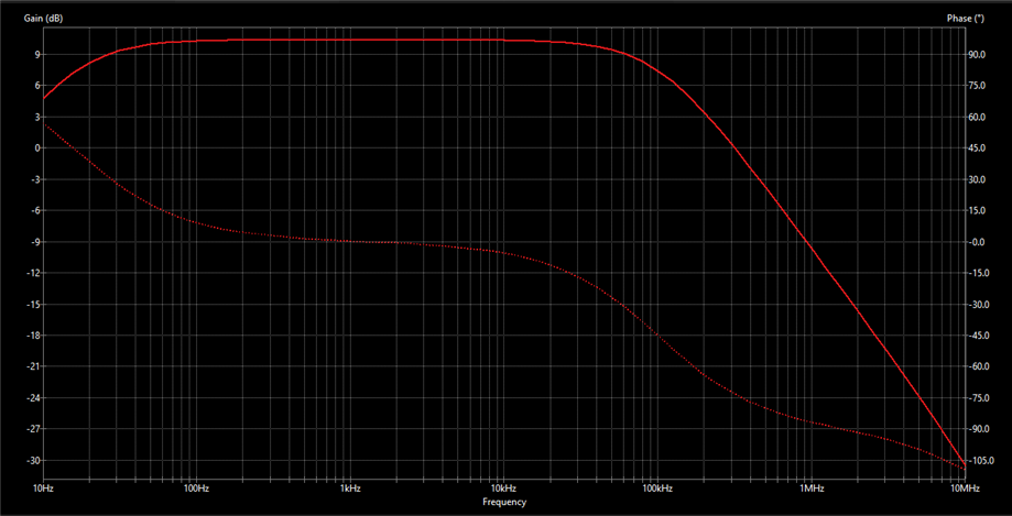

    It has good PSU rejection (18dB worst case at 30 Hz and 90dB at 100kHz.
    About 2mA current drain.
    Much smaller capacitors.
    It's not the best way to use two transistors but not bad. It still uses the first transistor open loop so the gain at 1kHz is lower that you would expect from the ratio of R3 to R4 because of emitter resistance.
    It manages 28.7 dB of gain (you would expect 33.4) and can drive 1V pk-pk into the 1K load.

    I simulated in KiCad 10 (quite a tedious process compared to other simulators! the procedure is here: (+) KiCad 8: Working with Circuit Simulations! - element14 Community )
    Freq response:

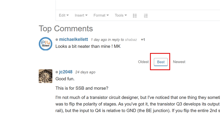

    beacon_dave 4 months ago in reply to shabaz
    "...It's getting really hard finding replies.. the comments default back to "best" and "newest" isn't sorting correctly either. I could see from e-mails that there was a reply, but it was hard to find it. I'll raise a problem report, because I don't think "newest" is functioning right..."
    It may be related to some of the 'deep nesting' issues that I've reported in the past.

    Totally agree about finding posts  - I had a struggle finding this one .
    Good idea to raise a problem report - add my name to it if allowed.
    If I have any more ideas I'll start from a new blog (if you haven't beaten me to it).
    But it I  can't understand why the thread can't just grow like they used to (and do in other places).

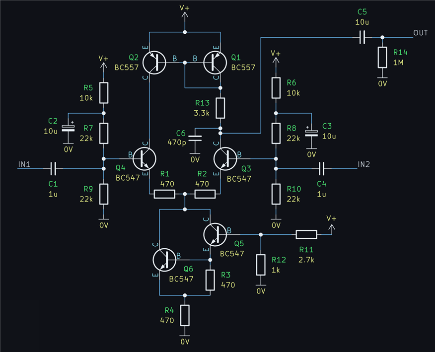

    Thanks for trying this out!! You're right, Q1 and Q2 are unnecessary, I needed far lower gain so I pulled the signal from the other leg of the LTP, but left Q1/Q2 just in case anyone wanted to experiment with higher gain for any project, they can tap the output from the correct side. I ordered the PCBs yesterday, but looking at your circuit, I have a plan; I just need a small daughter board designed to fit on top with those two output transistors, and I think it can be easily modified! I'll give that some thought hopefully later today (I have some time - dental work today so I will want some distraction later : )
  • michaelkellett
    michaelkellett 4 months ago in reply to shabaz
    Hello Shabaz,
    I had a bit of play with your diff amp in LTSpice and I've come to the conclusion that I don't really understand how it's meant to work.
    Usually the long tailed pair plus current mirror amp design takes the signal pick up off the other side of the current mirror. Or to put it another way the bases of Q2 and Q1 are connected to Q2 collector.
    And the resistors R1, R2 and R13 are all zero.
    If you do that the Q4, Q3 diff amp works as expected with lots of gain so you have to use negative feedback to control the gain and set the DC bias point.
    The long tailed pair isn't good at output swing so using an additional PNP device to invert and level shift  the signal at Q1 collector is  a better use of extra transistors than using Q6 and Q5. (Might as well use a resistor there because the voltage on the LTP emitters hardly changes.)
    Your approach of adding R1 and R2 and R3 to reduce the gain sort of works but makes the gain different for the two inputs.
    So that brought your circuit quite close to mine plus the current mirror.
    The current mirror makes it easier to balance the DC and increases the open loop gain to more than 82dB (at about 6kHz in my sim. for a stellar (if un-necessary) 60MHz GBW or more.
    The more complicated output stage means it can certainly manage at least 4V p-p on the output (probably 6).
    (R2 has been set to 10R and C4 to 22uF rather than the usual 1k5 and 1uF  to remove any AC feedback for this test.)
    Pos input on Q4, neg input on Q3 now because Q5 inverts the signal. LongTailedPair (LTP) signal taken off Q4 so current mirror bases must connect to Q3 collector.
