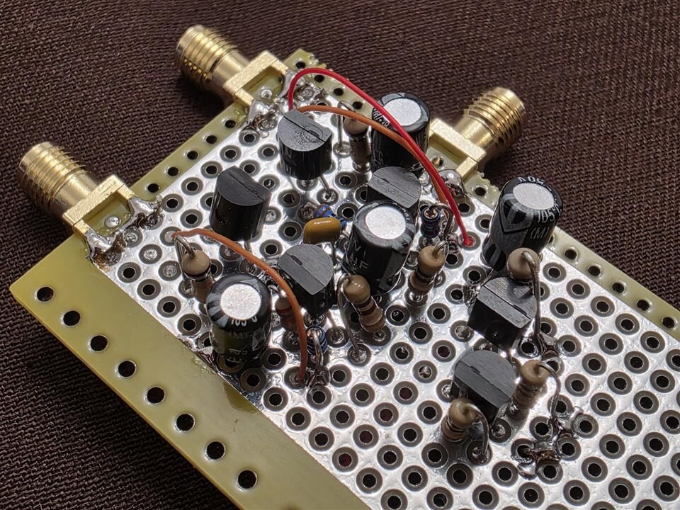

The photo here shows the extra resistor and capacitor bodged onto the PCB. The alligator clip attaches to the amplifier's output (the negative lead of capacitor C8), and the pink wire next to it is used to reconnect the amplifier to the next stage when required. The amplifier input is lower-right in the photo (where the potentiometer would normally go).

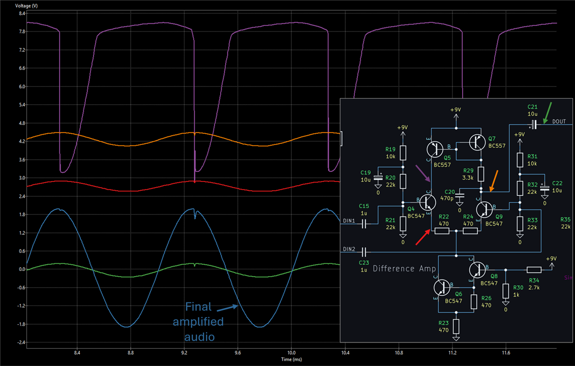

    I just had a chance to look at MIC1551 and MIC1553.. interesting parts! And very low-cost. I've ordered some of each to experiment with.

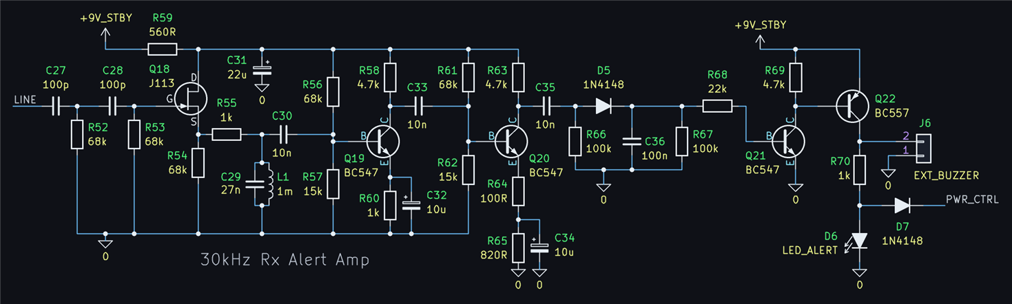

    I've tried to implement the receive side of the alert signal for the intercom over the weekend.
    Originally I was thinking of adding a DC voltage on the line as an alert, but then decided to add a low-volume tone (30 kHz, hopefully will work with cheap speaker or bell wire over a long distance).
    Although the simulation works, I reckon I will scrap this circuit; the DC level would have been simpler with hindsight, although it would have the side-effect of making a loud click in the audio.. minor issue I guess.
    shabaz 1 month ago in reply to michaelkellett

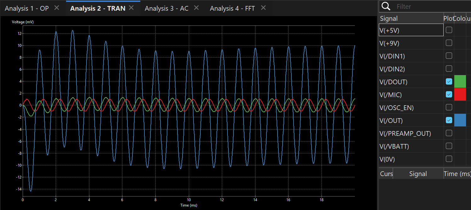

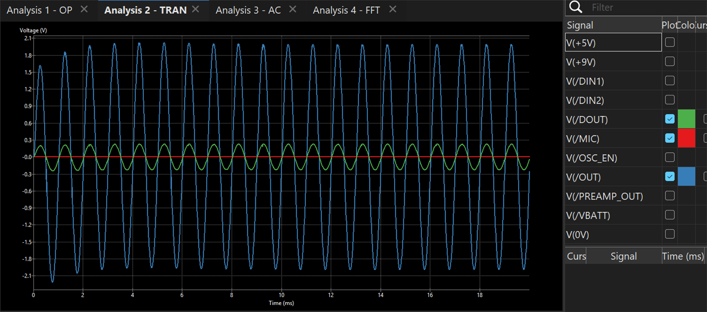

    I'm having some difficulties with the levels with the difference amplifier circuit, so for now I've pasted in the earlier version, which may have instabilities, but it's levels are about right as a drop-in replacement for the op-amp version. I still need to work on the oscillator alert feature, so for now this is just the speech portion, all discrete, based on those excellent preamp and poweramp circuits!
    I'm using a 1mVpeak signal to simulate the electret mic.
    The output looks good, this is with the 22k volume pot at 50% setting.
    The suppression for the local audio looks really good (this is with R28, which is a line termination type resistor, set to the expected 1k value).

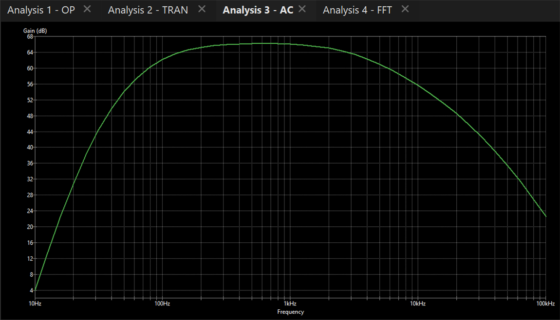

    Frequency response is very usable but might benefit from a little improvement at the high end, I'll check that out in the next day or two.

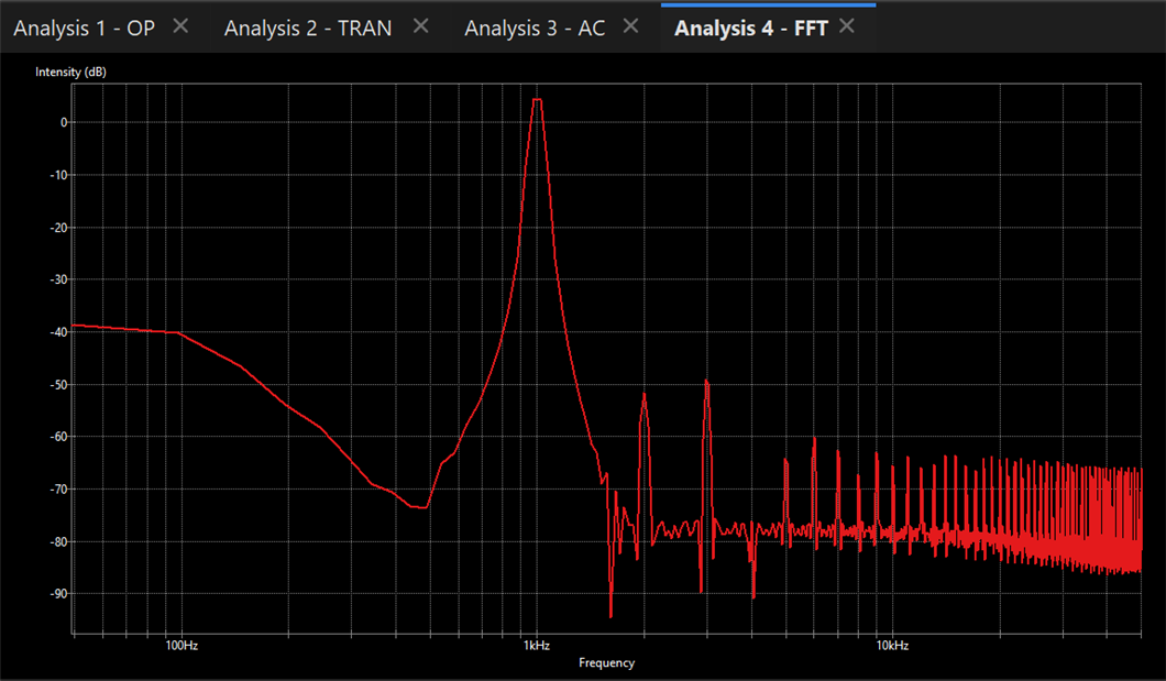

    Harmonics looks remarkable, those amps are impressive, way too good for an intercom : )
