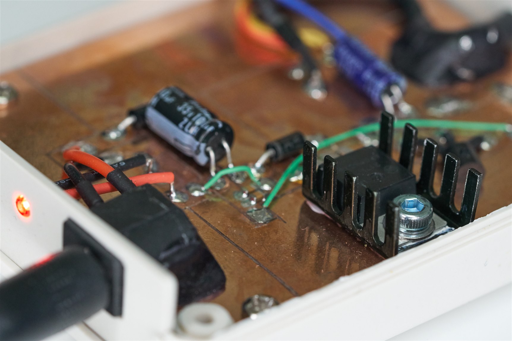

I built the prototype on copper-clad board. It fits in a low-cost enclosure from AliExpress.
When powered up (with no batteries attached) the output should be about 5.75V. Some basic tests can be done by applying a resistance to the output, and measuring the voltage and the current, and confirming that nothing overheats! It’s recommended to add a small heatsink to the LM317 (it doesn’t get very hot, so it doesn’t need to be a very large heatsink).

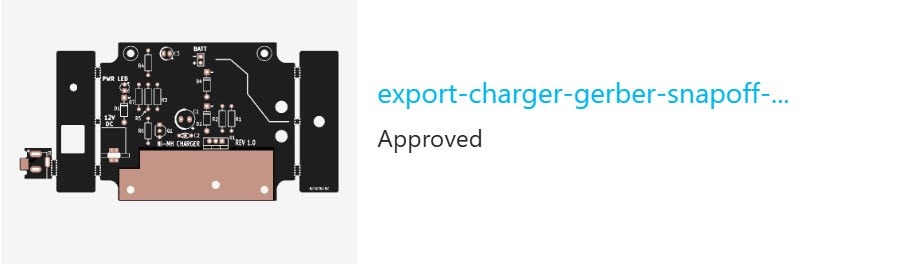

After that, I felt confident enough to attach four AA Ni-MH batteries (I tested with Ansmann 5035442 MaxE 2500mAH AA Ni-MH batteries). If you wish to also experiment with this project, then you could use the zipped-up PCB files and submit them to any PCB manufacturer.

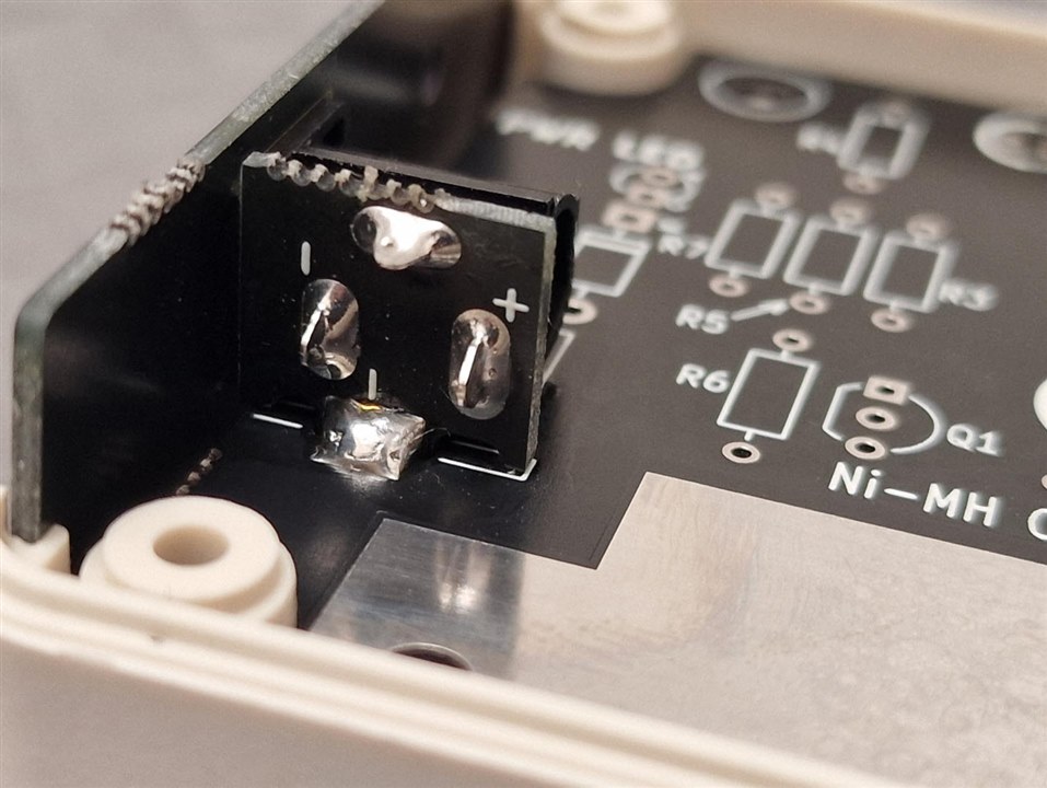

    shabaz over 1 year ago in reply to genebren
    Hi Gene,
    Sure, no problem, I'll verify that the PCB works by building one, and then get a PCB sent to you.

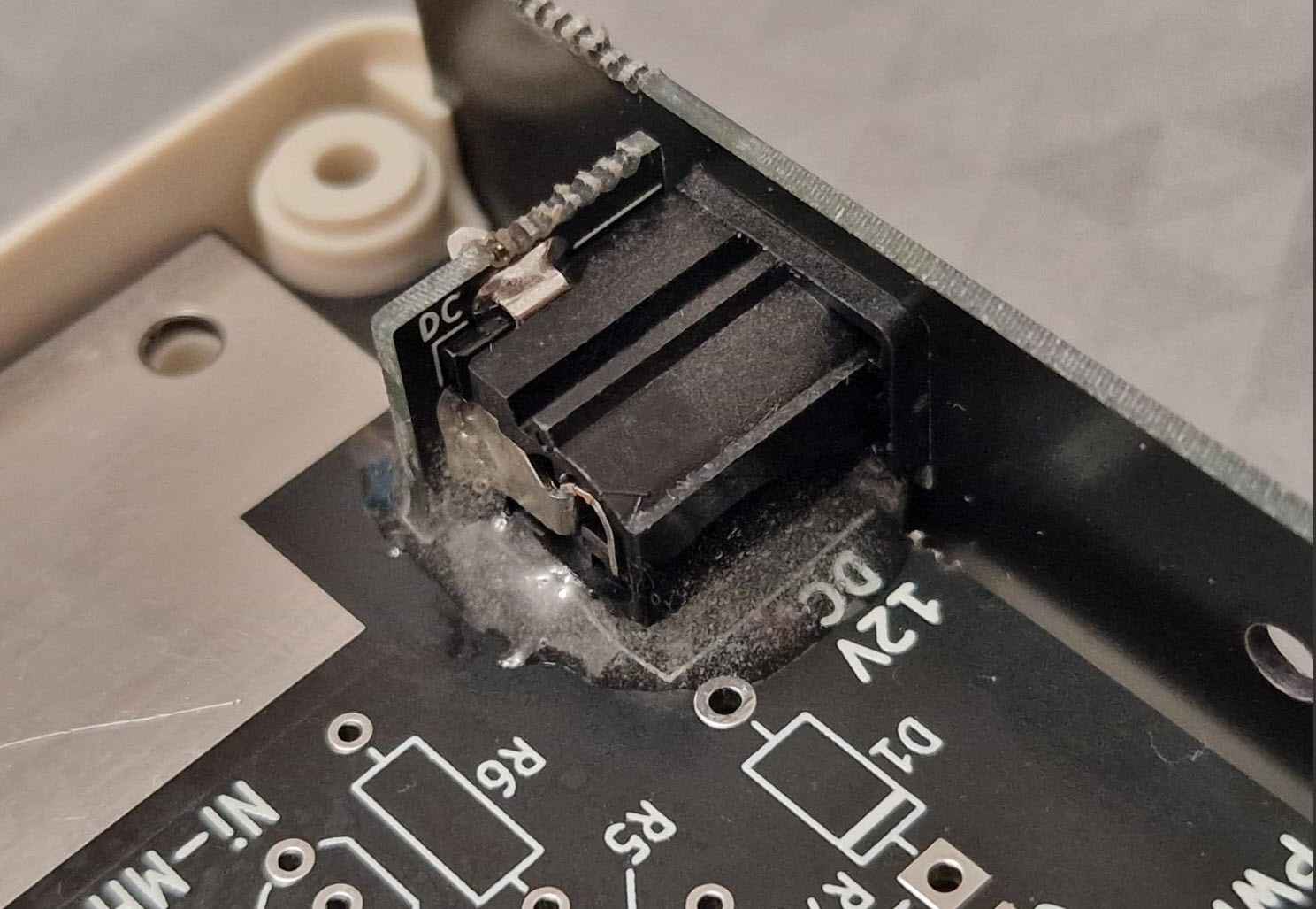

    I've just tried the right-angle part. While it works, I think I would use right-angle pin headers next time, would just feel a lot secure!
    Expoxy glue to hold things after the soldering was complete:
    Underside view; the slot is too wide, so there's a lot of solder bridging things. I've narrowed the slot in the latest Gerber files.:
    What it looks like:

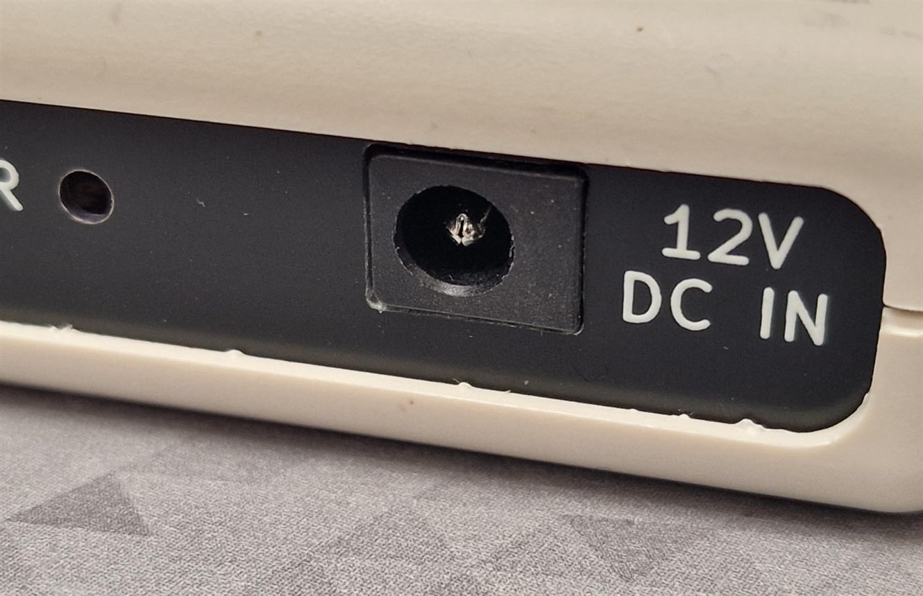

    I got the PCB today, it fits the enclosure nicely:
    The aperture on the end panel for the DC socket needs shifting by a millimeter, and the 'tongue' on the little PCB benefits from extending by a millimeter too, so I'll make the changes to the Gerber files, but the current boards are usable (will just need a bit of epoxy glue to hold the DC socket in the right position).
    I'm really happy it fits, it will allow me to use this for charging 4xAA (or 4xAAA) for all sorts of projects.
