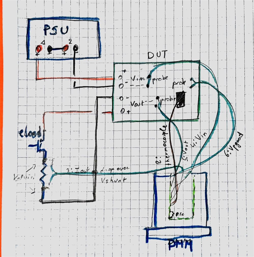

Bench setup
I'm using 3 instruments for this exercise. ALl are LabView capable:
  • PSU: Rigol DP832A, with channel 1 and 2 in series
    • Deliver Vin (12 - 24 - 36 - 48 V)
    • Measure input current
  • eLoad: my own
    • draw current from the DUT, between 0.1 and 6 A
  • Bench meter: Keithley DMM6500 with 2000-SCAN card (6 inputs used)
    • 1: internal DMM temperature for cold junction compensation of channel 2
    • 2: thermocouple attached to SIC967
    • 3: Iout - measures the voltage drop over the kelvin terminals of the eLoad's shunt resistor
    • 4: Vin at the DUT's probe points
    • 5: Vout at the DUT's probe points
    • 6: Vpowergood at the DUT's probe points

Initially, the flow connects to the 3 instruments and sets them up:
PSU:
Set Channel 1 and 2 to 0V, set current and Over Voltage limits, and set them as tracking, This will take care that when the flow changes the voltage of Channel 1, channel 2 follows along.
I've done that because 1 and 2 are in series to be able to deliver 48 V. The channels are switched on.
eLoad:
I'm using the low level direct DAC write API of the load. The load is set to draw 0 A, and activated.
Bench meter:
The first 6 channels of the scanner card are configured:
  1. Temperature, RTC, Pt100: measures the point where the thermocouple is connected to the card - the cold junction
  2. Temperature, Thermocouple, K-type: measures the switch IC case temperature
  3. Volt, 1 V dc: measures the shunt resistor of the eLoad. We 'll divide this value by 0.05 Ohm to get output current.
  4. Volt, 100 V dc: measures the input voltage at point of load
  5. Volt, 10 V dc: measures the output voltage at point of load
  6. Volt, 10 V dc: measures the power good signal
