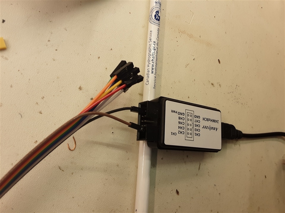

    Great stuff. Could you complete the picture with a link to or a picture of your generic 24MHz analyser.
    Thanks.

    Here is a pictures of my logic analyzer. Any device with the FX2 chip, 24 MHz, and 8 channels should workimage

  • scottiebabe
    scottiebabe over 3 years ago in reply to wolfgangfriedrich
    I have one of those, never figured out how to make it work in windows...
    I often import my scope traces as wave files into sigrok and it can apply a comparator to create a digital trace.
    shabaz over 3 years ago in reply to scottiebabe
    It is a slightly awkward install process to make it work on Windows. I documented it here  DIY Logic Analyzer and Protocol Tester – L.I.S.A.!
    in the "Using It" section on that blog post, because that project is essentially no different from the typical ready-made FX2 logic analyzers (mine only differed by adding the isolation, and some output ports). so the same procedure should work. Not saying my documentation is any better than what's out there though. It's ugly having to use that Zadig tool.
  • wolfgangfriedrich
    wolfgangfriedrich over 3 years ago in reply to shabaz
    Thanks shabaz . This is the correct answer. I had to use that Zadig tool as well, but forgot already. Cheers.
