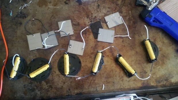

I would like to preface this post by saying I have no idea what I'm doing.
So here's what I have going on.
I bought a bunch of solar garden lights at my dollar store. Each light comes with a solar panel and a rechargeable AAA battery.
I've connected all of the batteries up in series, and I've connected up the solar panels in some horrible series/parallel hybrid.
My goal with this is to hook up the batteries to the solar panels, and connect all of that to the interior of a car USB charger to use it to make a solar panel phone charger.
However, I'm not very familiar or comfortable with electricity. So how would I go about connecting the solar panels to the batteries, and eventually to the usb power? Any help is very much appreciated.image

    Hi Tallen, Thanks for the heads up on your skill base. Hooking the batteries directly to the solar cells is very bad! Depending upon the battery you use, each is sensitive to the rate at which they charge…
    0 DAB over 8 years ago
    Hi Tallen,
    Depending upon the battery you use, each is sensitive to the rate at which they charge.  Some batteries easily overheat and burst into flames.
    You are going to need a charging circuit.  I suggest you buy one off the shelf so you match the charger to the batteries you intend to use.
    With the charger, you can then select the configuration of solar cells to get the proper input voltage.
    You also then have a standard configuration for connecting the batteries, either parallel or serial, depending upon the controller.
    The controller will then properly sequence the power to the batteries so that they are carefully brought up to full charge without overstressing any of the components.
    While simple in concept, using solar cells and batteries needs to be done carefully.
    Be aware, you can end up with a fire hazard, so use the right tools for the job.

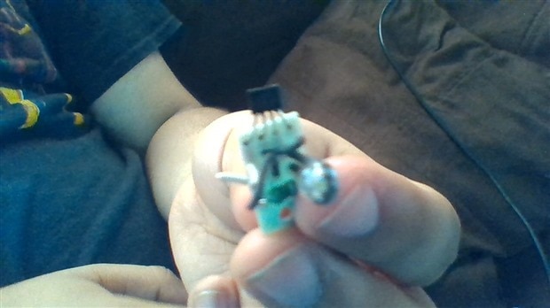

    All of my garden lights came with this little twiddly thing. Can I do something with this? I just figured it was a NOT gate to make sure the light turns on when the solar panel isn't producing.image

    I think you might have trouble with the voltage you have created. I might be wrong of course. Batteries when connected in series add voltages together. A 1.5 volt battery + 1.5 volt battery = 3 volts +1.5 volt battery = 4.5 volts + 1.5 volts = 6 volts ,enough for an Arduino that has a voltage regulator set at 5 volts for USB output which is good for cell phones I believe. The same applies to the solar cells but they are not voltage regulated.
    OK now the current supply, if you connect 2 solar panels that you have in series and attach the out put to 2 series batteries they will charge the batteries in ( at regular set period of time maybe 3 hours ) if you connect in series 2 more solar panels and attach them across the 2 series batteries already connected to the 2 solar panels the voltage output will remain the same but there will be 2 times the current available to charge the batteries with which might cut in half the charge time if the batteries will accept the additional charge current.
    You have mentioned a car USB charger but I did not see it in the photo. So I left out any explanation of that circuit. Hope this helps.
    Cheers Daleimage

    I plugged the solar panels that way because I figured the 4 in series would create 6 volts for a phone, and then the 2 in parallel would just up the amps to charge a little faster. But again, I have no idea in reality what I'm doing.

    Does the twiddly thing have a part number on it? ou can type the number in to a search engine on the internet to find out what it is. If it is a voltage regulator it will have Plus an Minus input from the solar cells and a plus output to the battery.

    It doesn't have a +- that I can see. But it does have a part number. It's just really tiny. It says YX8018 Ae7b1 or something. After googling YX8018 I found a site talking about hacking the very garden lights I bought. https://ez.analog.com/community/university-program/blog/2014/11/14/hacking-an-led-solar-garden-light

    The picture you posted show 2 sets of parallel solar cells. I think you would be better to stick with one solar cell connected across one battery those pairs connected in series to the voltage you want. You do know cars use 12 volt batteries?

    So you're saying to just put the solar cells in series? And, yes. But if you're suggesting I buy a car battery for a little cell phone charger experiment...
