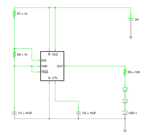

    Here is the circuit that I came up with. I am shooting for a 20ms time high with a 1.3 Second cycle time. I found an online calculator at 555 Astable Circuit Calculator
    but its very confusing to me at this point. When I change one value it seems to change others throwing me way off. I can't keep up with it. If any of you gentlemen have a better suggestion for me on this circuit I'm listening. Also thanks for the link Mr. John that will be very helpful in my future projects. Also a quick correction. It will be powered with a 9v Battery, not 5 volts as pictured above.

    0 gadget.iom over 11 years ago in reply to e14 Contributor
    Hi Rob.
    Thanks for your diagram.
    I have also visited the page you referenced. The calculator (annoyingly) works based on submitted component values rather than timings, the reverse to what you really need. An interesting point I did take from this page is as follows:
    In this type of circuit, the duty cycle can never be 50% or lower.
    The following page goes on to say: http://www.daycounter.com/Calculators/NE555-Calculator.phtml
    Note that the minimum duty cycle is 50 percent, so if you need a smaller duty cycle you need to use an inverter on the output.
    I don't really have much 555 Timer experience, but from what i have read, this would seem to apply to you.

    0 jw0752 over 11 years ago in reply to e14 Contributor
    Hi Rob,
    paulellison is correct that what you want to do might be easier to accomplish with a microprocessor. Also for the 5 volt power you are showing on your schematic you will probably not be able to drive 3 LEDs in series. Most LEDs have junction voltages that are high enough so three in a series would be at or higher than 5 volts. The duty cycle you are trying to achieve is 2% at a frequency of approximately 0.77 Hz. The best that the circuit that I posted before can do is 5%. You can drive three LEDs by using a higher supply voltage. I believe that the 555 for example will work with up to 18 volts on some varieties.

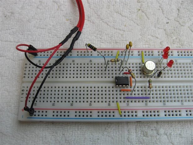

    Hi Rob, Just for the fun of it I mocked up your idea using an Arduino Duemilanove. I will attach a video but keep in mind that my camera has a slow scan rate and as such it misses the 20 uS flash occasionally. In real life the 3 LEDs flash for 20 uS and then are off for 1.3 seconds before they flash again. The camera misses every third of fourth flash. I have taken the simplest of Arduino sketches called "Blink" and modified it to your specifications of 20 uS on and 1.3 Seconds off. The Arduino outputs this signal on pin 12 in this case and I am using the signal to trigger an NTD4906 gate level N channel MOSFET. I am supplying 9 volts to the LEDs and the FET so there is enough voltage to drive them in series and there is also a 220 ohm current limiting resistor in series. I do not know the intention of your project whether you need this effect or if you are just trying to learn about the 555.
