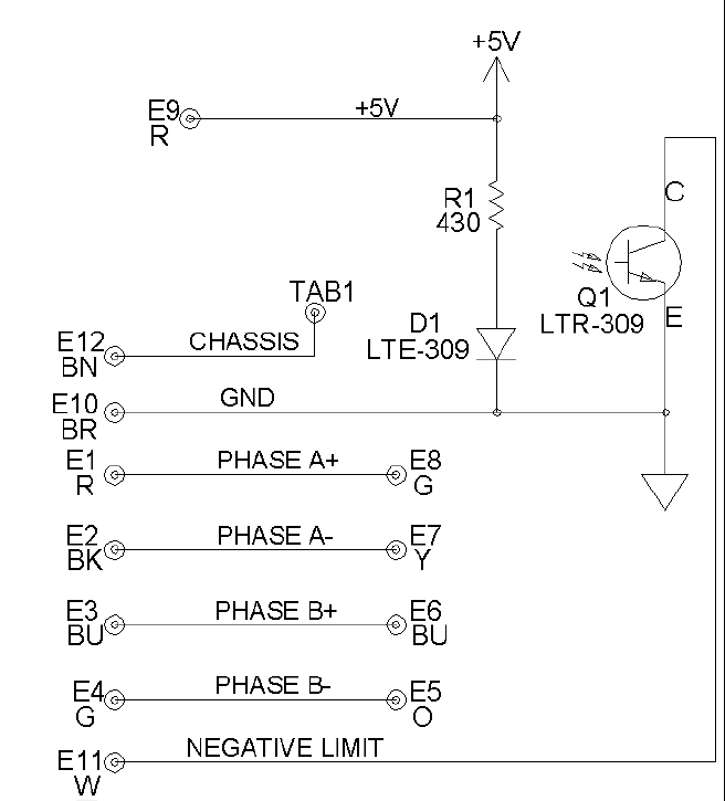

I have a stepper motor (multi-axis' in fact) that provides a limit signal (E11 NEGATIVE LIMIT) that is open collector output:

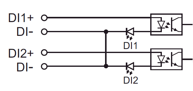

I need to connect that signal to an opto-isolated 24V digital input (no internal pull-up resistor I assume):

    You could connect a Phoenix Contact 2900353 to the E11 signal, but that signal needs a 390 ohm resistor between it and 5V.
    The polarity can be reversed simply by connecting the module slightly differently.

    So the INPUT may require a pull-up resistor. I included the schematic of the INPUT in the question and it doesn't shown and resistor in the circuit.
    The input is a WAGO 750-671 Stepper Driver Module, which requires the limit sensing input for homing sequences. I can't find any reference to input impedance or whether a resistor is needed.
    I assume it is needed as its omitted from the schematic.
    What would happen if I just connected the output signal to both +24V and the input?
    So a DIN rail mount resistor will be required. They don't appear to exist as a standard item in the catalogue.
    Maybe a device I can slot a resistor into is available...??
    Douglas thanks also, I'll have a closer look at that part, and I still need a resistor as you say.

    0 Robert Peter Oakes over 11 years ago in reply to tjslip
    2 diodes, 24V and no resistor will release the magic smoke for sure. the resistor is to limit the current through the opto LED as much as it is also a pull up
    if the input to your monitor (PLC) is also an opto isolator input then you dont need to drive it with 24V
    If it is already 24V capabable then it probably has a resistor or other current limit in it already so the open collector from the stepper should be able to be directly connected

    0 tjslip over 11 years ago in reply to Robert Peter Oakes
    Good to know that if the opto input is +24V ready, its ready to take the 24V without any resistors.
    All I need to do then is put a relay in between the input and output to invert the signal, i.e. normally closed.
