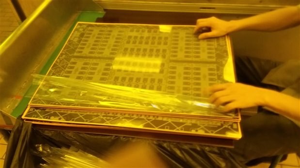

hi all ,
im from PCB manufacturing company.
any idea on how to removing the protective film inner layer.image
i need the better tool as of now we are using pen knife manual peel off the mylar( protective film)
act we are planning to automate the process by automation.

  • kamaruddin89
    kamaruddin89 over 9 years ago in reply to michaelkellett
    noted & tq Michael Kellett.
    we planned  using robotic arm  remove this protective film.
    this is the process in pcb where we need to laminate , expose & etching.
    before etching we need to remove the mylar. then only we can do the etching process
    we are using penknife to remove the mylar.
    supplier only have the machine but the risk panel thickness.. the machine cannot handle the too thin panel.
    so we come out with the idea to use robotic arm. the  thing is we need to find the concept.
    examples : we studying to use the tape (we stick the tape onto the panel & peel  it off .so the protective  film need high adhesive 7 stickness.
