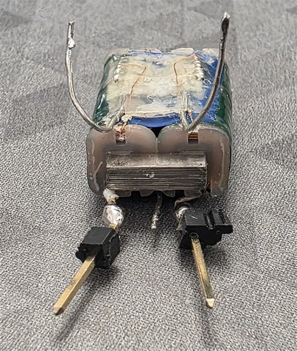

Here’s a closeup of the circuit board, with the green tape removed; now it’s clear that was hiding a transformer.
In the photo below, the board area can be split into three portions; the lower-left contains circuitry for filtering off RF interference arriving via the microphone cable, the center houses the transformer for constructing a balanced output, and the lower-right contains the audio amplifier.
I tried reverse-engineering the circuit (without destroying it, hence I’m sure I have some of this wrong – and all of the non-polarized capacitor values are placeholder guesses).
I’m not sure what D1 is, it has a DA inscription. With some thought, the black component inscribed DA must be a capacitor. Edit: now measured out-of-circuit, it is a 100 nF capacitor.
D5/6/7 are guesses (they have a 561 inscription (Edit: see comments below, D6/7 are most likely 56V zener diodes), they may be 5.6V Zener diodes (although I was under the impression this mic supported a far higher phantom voltage input, so either I am mistaken about the part, or this mic may be a slightly different variant). Edit: D5 is possibly 5.6V zener.

    Interesting tear-down. The transformer construction is fascinating. Would the core material just be steel, like a mains transformer, or something more exotic?
    I'd say D6 and D7 were 56V zeners. The marking is somewhat different to D5 (if they'd come from the same reel on the pick-and-place machine, you'd think they would be the same).
    It's very likely this microphone will run from a 48V phantom supply.
    Note that, if you try it on a mixer, you may not actually see the full 48V with the mic connected. Inside the mixer, pins 2 and 3 of the XLR are commonly fed via resistors from the 48V (if you have it enabled), so it will sit down from the 48 on load - probably somewhere around the 40V mark with it taking 2mA.
    The DA shape looks wrong for a cap and there's an NXP BSX384-C11 11V zener with DA marking in that style of package. But how that fits with the circuit you've drawn, I've got no idea.

    I think you are correct there - I'd missed D2 which looks like a 2mA constant current diode.
    A LONG time ago when I worked at Lustraphone (approx 1974) we used mu metal laminations for microphone transformers - high permeability for high inductance but very low saturation -  fine for a microphone. Or ir might be amorphous iron which came along  a lot later but I don't know if its good for microphones.

    Decided to desolder it a bit further : ) I think you're right, D6/7 are likely 56V (I confirmed 0.7V forward, and couldn't get it them to conduct in the other direction with a 12V supply with 1 k in series. On the other hand, D5 did conduct (and its forward voltage was 0,74V, suggesting it is a different part), perhaps 5.6V zener.
    The DA component measured 100nF, it may be a special capacitor.
    shabaz 18 days ago in reply to michaelkellett
    Interesting, the science museum has a mention of Lustraphone Lustraphone | Science Museum Group Collection
    Next time I'm there I'll see if they have those items that are in their collection on display.
    The transformer is tiny, the core dimensions are 19 x 8 mm rectangle, of 2.8 mm thickness for the laminations, yet inductance was quite high (about 3.4H at 1 kHz with 10 mV drive). The inter-winding capacitance is low (about 145pF from memory, I measured it a couple of days ago), so possibly the windings are on separate bobbins, although it doesn't look like it from the way the wires are coming out from the tape, so I'm not sure at all.
