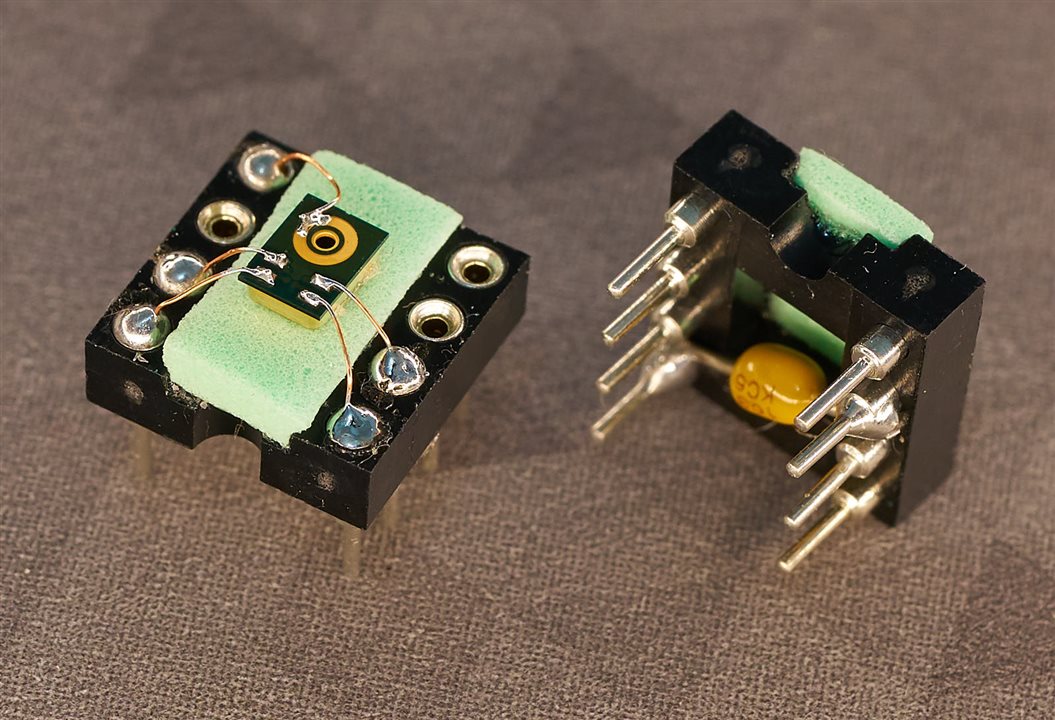

    I just spent a couple of hours soldering these up.. these are MEMS microphones with Pulse Density Modulation (PDM) out, although I2S versions exist too.
    shabaz 19 days ago in reply to shabaz
    The setup (two mics, with the two data lines going to GPIO 3 and GPIO 4, and the clock is GPIO 5). Both mics have the left/right select pin grounded.
    The signal timimg is really on the edge.. yellow is the clock of course. Since the left/right pin is grounded, I expect the data to be valid when the clock goes low, but according to the datasheet, that can be up to 100 nsec, since the part needs time to get out of high impedance (this is because two parts can have their data lines connected together, for stereo, although as mentioned, I'm not doing that, I have the data lines separated). I do see such a long delay (sometime slightly more than 100nsec). After seeing this, I modified the clock to have shorter positive pulses, and longer negative periods, to read the data a bit later. I forgot to take a 'scope screenshot of that though.
