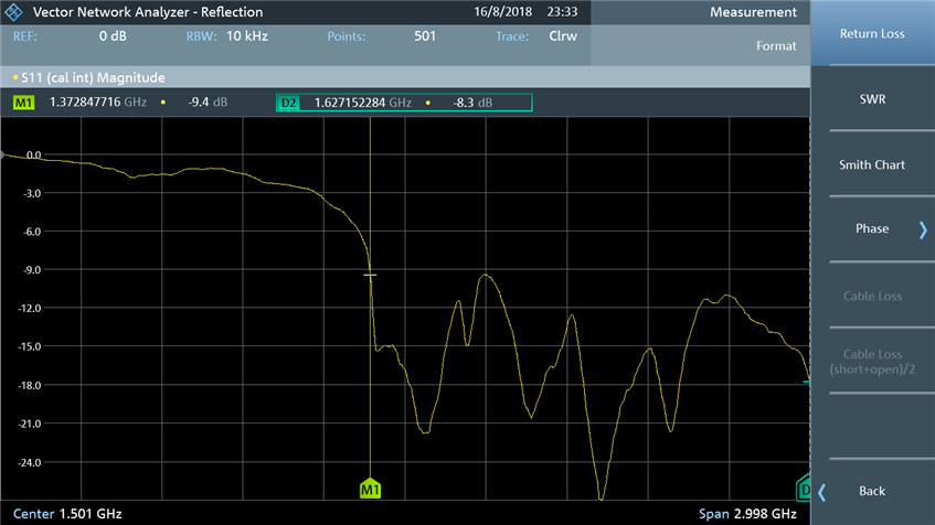

The screenshot below shows the voltage standing wave ratio (SWR or VSWR) of the antenna, across the 0-3GHz range. As can be seen, the SWR falls below 2.0:1 at the marker M1 position which is 1.37GHz. This antenna would therefore function from 1.37GHz to 3GHz and beyond. This is consistent with the ebay advert, which states it works from 1.35GHz to 9.5GHz. I could only test to 3GHz of course. A SWR of 2.0:1 represents a loss of about 10% of power, i.e. 10% was reflected back.
For a lot of the spectrum the ratio was below 1.5:1. At 1.5:1 SWR, the loss is 4%.
Another way of seeing the same information is to look at ‘return loss’. It shows the same information, just as a different conversion that shows more detail due to the y-axis being logarithmic. The SWR chart has everything cramped in the useful portion. In the return loss chart below, the marker is set to -9.5dB which is a return loss value of 9.5dB, that is equivalent to 2.0:1 SWR.
So far the charts have shown scalar information. Now we can go into the vector domain! The swirly diagram here is a Smith Chart. It is discussed in a lot more detail in the FPC1500 review linked to earlier. To cut a long story short, imagine the 0 to 3GHz line in the previous charts, laid out in a different way, which in the case of the screenshot below, happens to begin near the right side of the circular chart, spirals downward and inward, and finally ends up at somewhere else (near the center of the chart in this example).
Anything near the center of the chart corresponds to the antenna looking like a 50 ohm resistance at that frequency, and the loss would therefore be very low. Anthing far away from the center corresponds to an impedance that is not close to 50 ohms resistance. The green marker M1 corresponds to the 1.37GHz position on the swirly yellow line, and it is close to the center. The D2 marker is at a delta of 1.63GHz to M1, i.e. it is at 3GHz absolute frequency, and it too is close to the center.
The Smith Chart view is helpful because it graphically describes what needs to be done to the circuit in order to make the match closer to the center, for any desired portion of the spectrum. This too is discussed in more detail in the FPC1500 review.

    This is really good - thanks for posting it. The readings for the second marker are RELATIVE to the first, aren't they? I was a bit puzzled by the low resistance given the placement of the marker but,…

    shabaz over 8 years ago in reply to jc2048 +3
    Hi Jon, Thanks for reading! It's great to hear about your experiences with these antennas. I've not done any EMC tests so log-periodics are new to me, I was looking for a directional wideband antenna,…
