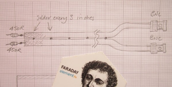

The diagram here from Jon illustrates the design of the probes.
(image source: jc2048 )image

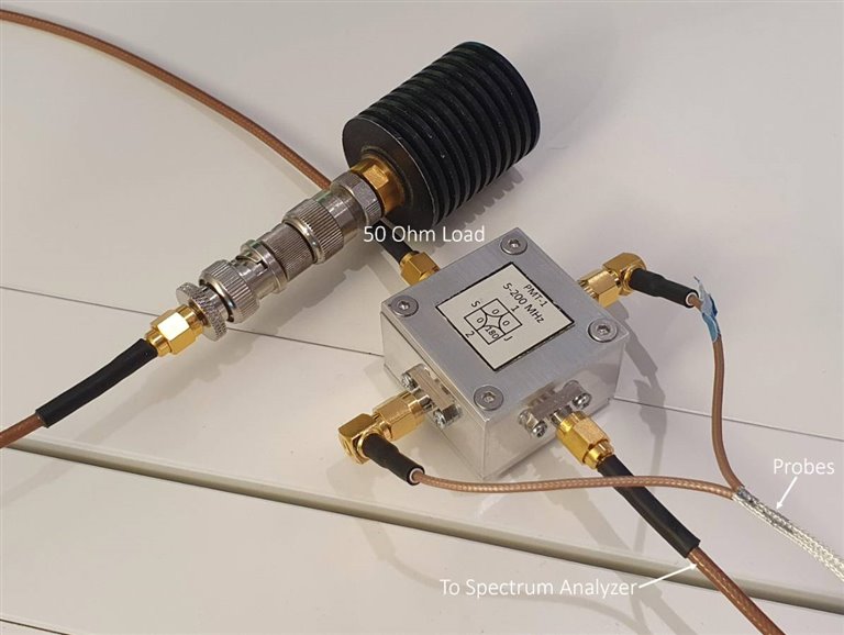

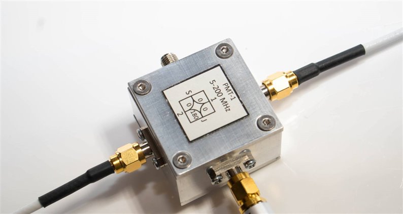

From the previous blog post, it is clear that these differential probes will offer a 1 kohm (450 + 50 + 50 + 450 ohm) resistance to the circuit under test. The connectors on the right need to be combined into a single output. To do that, a combiner/splitter type device can be used, also known as a hybrid coupler. They look like this:
There are four connections on it. This one happens to use SMA connectors. The four connections are labelled 1, 2, S and J. The ports 1 and 2 can be used as inputs, and would be connected to the differential probes. The S port and J ports are both outputs. The S port provides the sum of the two signals with zero degrees phase shift. The J port provides the sum with 180 degrees phase shift (there are 90 degree versions too, but that is not used here).
The S port needs to be terminated in a 50 ohm load for this use-case, and the J port is attached to a spectrum analyzer (observe precautions like suitable attenuation and DC blocking if required - the low voltage tests in this blog post did not require that).

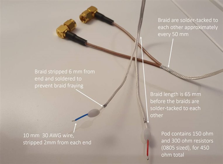

Probe Construction
Refer to the oscilloscope probe blog post for the general idea. The overall length was about 400 mm end-to-end. The measurements in the diagram are what I used, and experimentation could yield better or worse results. Both of the coax cables should be identical length (i.e. try to match the lengths down to the millimeter), and the wire ends should be identical length too.

As mentioned earlier, it is good to take precautions such as inserting an attenuator and DC block if there is any risk of damaging the spectrum analyzer. The photo below shows how the connections were made. The 50 ohm load here is overkill, only a tiny screw-on load is needed. For the combiner/splitter,I used what I had which was a Minicircuits PMT-1+ device (5-200 MHz response), inserted into a metal case. The one that Jon mentioned was a ZFSCJ-2-1 device for 1-500 MHz response. I will probably purchase this one eventually: PSCJ-2-1+ for 1-200 MHz response (it's a bit lower cost).

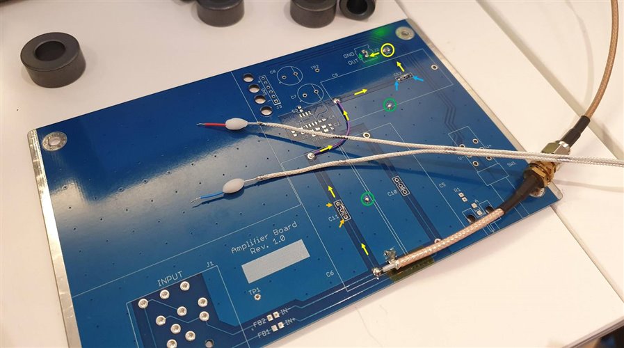

For bare PCB testing, I took a circuit board that was intended to be an audio amplifier with input and output capacitor and an op amp circuit. The capacitors and op amp locations were all bypassed with wire. A 50 ohm resistor was placed near the end of the board (circled in yellow in the diagram below), before passing the output into the ground plane (at the green arrow location). It is a 2-layer board, and the underside is entirely a ground plane. The top side has several copper pour areas, all are ground (no power copper pour), and there are vias stitching them, all approximately spaced 8 mm apart.
The path of the signal (from the signal generator) is indicated by the yellow arrows.
The orange and blue arrows show where the input and output capacitors were intended to go, but are jumpered with bare wires. The green circled areas are ground plane where the solder mask was scraped off.
The signal generator was set to 35 MHz, -10 dBm. When I connected the differential probes across the wire links (orange or blue arrows), I saw -65 dBm on the spectrum analyzer in both cases. When I connected the probes to the green circle locations, which are ground plane (I scraped off the solder resist there), I saw -88 dBm. Of course really for a like-for-like comparison, the distance between the probes should be approximately kept similar across all measurements, I don't think it's critical at this frequency at all). And if it was a good ground plane then the distance between the probes should still result in a measurement close to the noise floor regardless of distance.

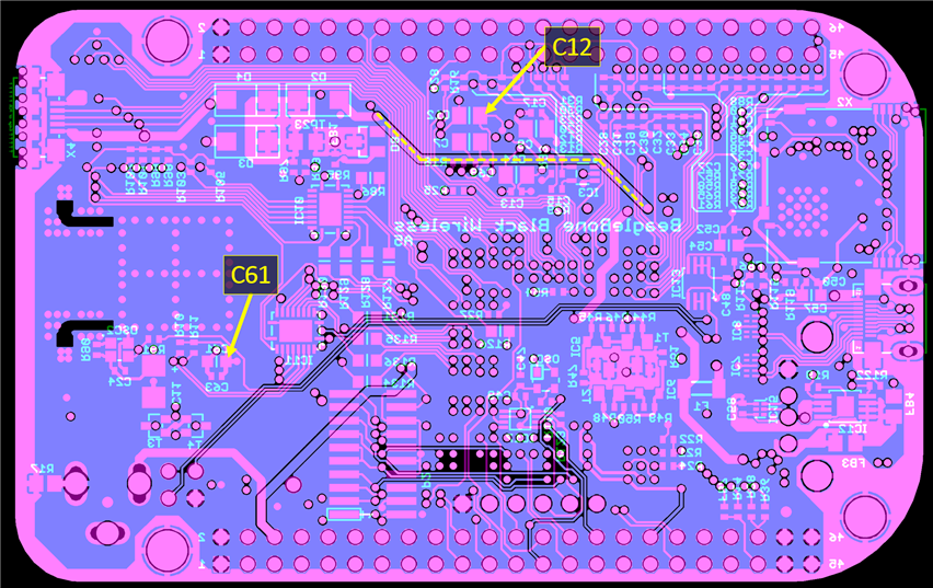

In order to test with a more realistic board already operational, I examined the BeagleBone Black Wireless (BBB-Wireless) circuit diagram and gerber files. The following locations were chosen for testing; they are the ends of two ceramic capacitors which drop into the ground plane. I chose these locations because as can be seen by the dashed yellow line in the gerber diagram below, the ground plane layer has a trace running through it in-between and perhaps it has a negative impact.
The power entry is from a 5V DC barrel socket on the BBB-Wireless, it is at the lower-left on the gerber plot shown above.

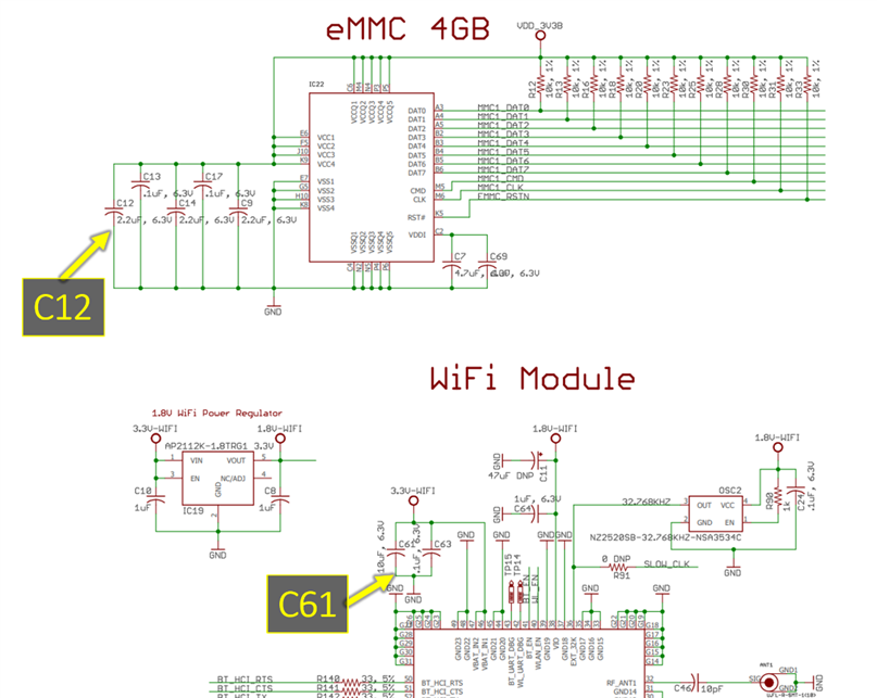

The board circuit diagram is shown below:
Due to the probe positions I expected to see ground plane noise whenever the eMMC memory was accessed. I did not expect to see WiFi module noise, because the power entry is more south-bound from the gerber plot.

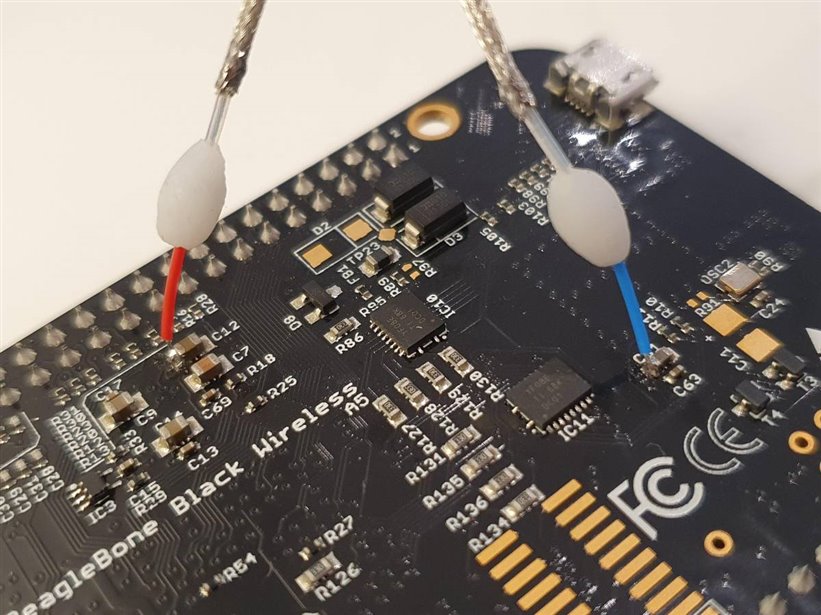

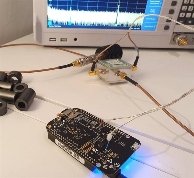

The probes were soldered into position:
The entire setup:
Network traffic was tested using iperf3 using the following commands.
Server (elsewhere, not part of the photo shown above):
iperf3 -s -f K
BBB-Wireless acting as a client (replace xx.xx.xx.xx with the IP address of the server):
iperf3 -c xx.xx.xx.xx -f -K
When the test was run, I saw no noise present on the spectrum analyzer, beyond the noise floor (depends on the spectrum analyzer settings).
This was what I was expecting anyway.

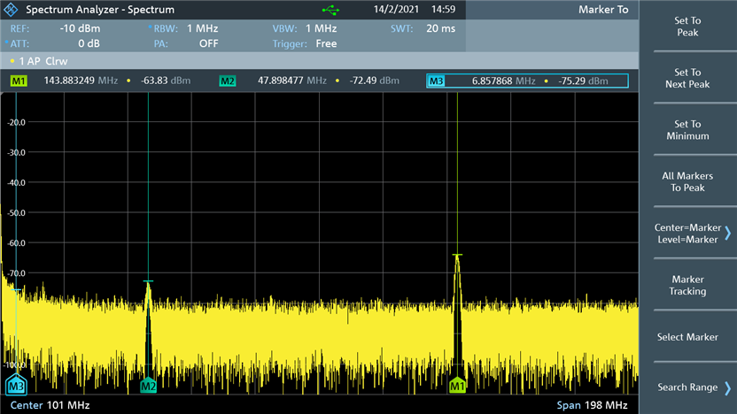

When the last command was typed, a file was written to eMMC (the eMMC chip is Kingston EMMC04G-M627-X02U). The spectrum analyzer (set up for a span of 200 MHz) showed the following:
The markers M1 and M2 in the screenshot above are 148.88 MHz -63 dBm and 47.9 MHz -72 dBm respectively. Unfortunately I don't know enough about eMMC and Linux configuration to know what these signals represent!
I tried desoldering a few capacitors on the BBB-Wireless, and the noise was not impacted to any noticeable difference. Next steps could be to try to solder the probes to different locations on the BBB-Wireless. I didn't have time to try this.

    I'm impressed: you've made fast progress with this. It's starting to look like a useful tool. I'm absolutely fine with you using the drawing. I believe eMMC has a high-speed mode (0-52MHz) and a HS200…
    shabaz over 5 years ago in reply to jc2048 +2
    Hi Jon, Thanks! I had set the resolution bandwidth to 1 MHz, for fast sweep times on the spectrum analyzer, unfortunately, I didn't resolve in any more detail. I'm going to try to re-build the probes with…

    I believe eMMC has a high-speed mode (0-52MHz) and a HS200 mode (0-200MHz). All the signals, including the clock, are single-ended, so the clock in particular will contaminate the ground plane quite badly when it's fast, but you'd expect to see some evidence of energy from the data edges lower down. The actual clock rate will depend on how things are arranged in the processor. The data will have to be DMA-ed in and out of the DDR memory, so it's all part and parcel of the memory control system, though the DDR side will easily keep up. (Of course, the quick way to determine the clock frequency would be to look at the clock pin with an oscilloscope.)
    How accurate do you think the peak markers are? If the clock were just below 50MHz, you might expect quite a lot of the third harmonic up around 150MHz, as the board and the decoupling are probably working less effectively by that point. Could that
    be what we're seeing, or is it definitely two separate signals?
